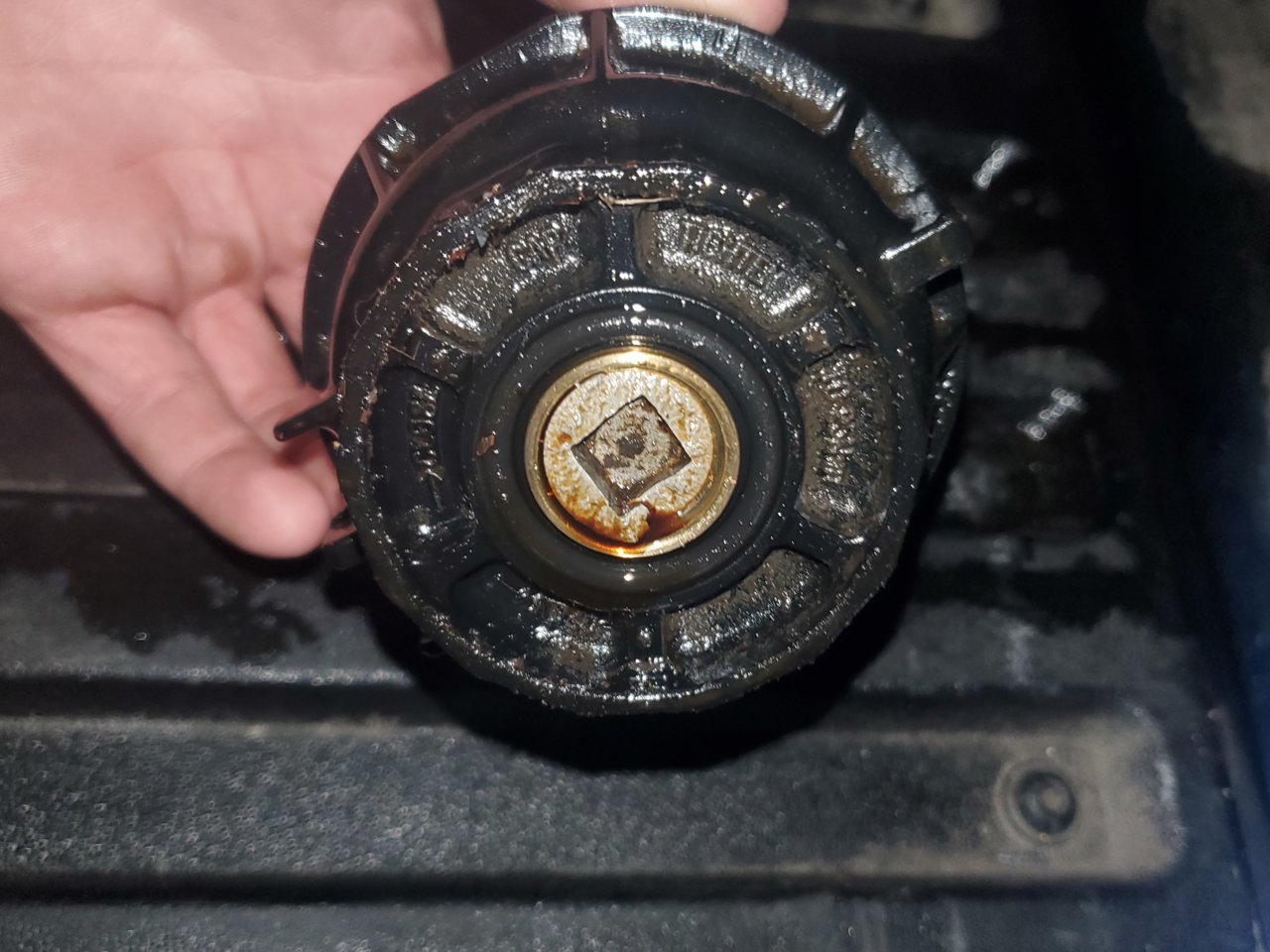

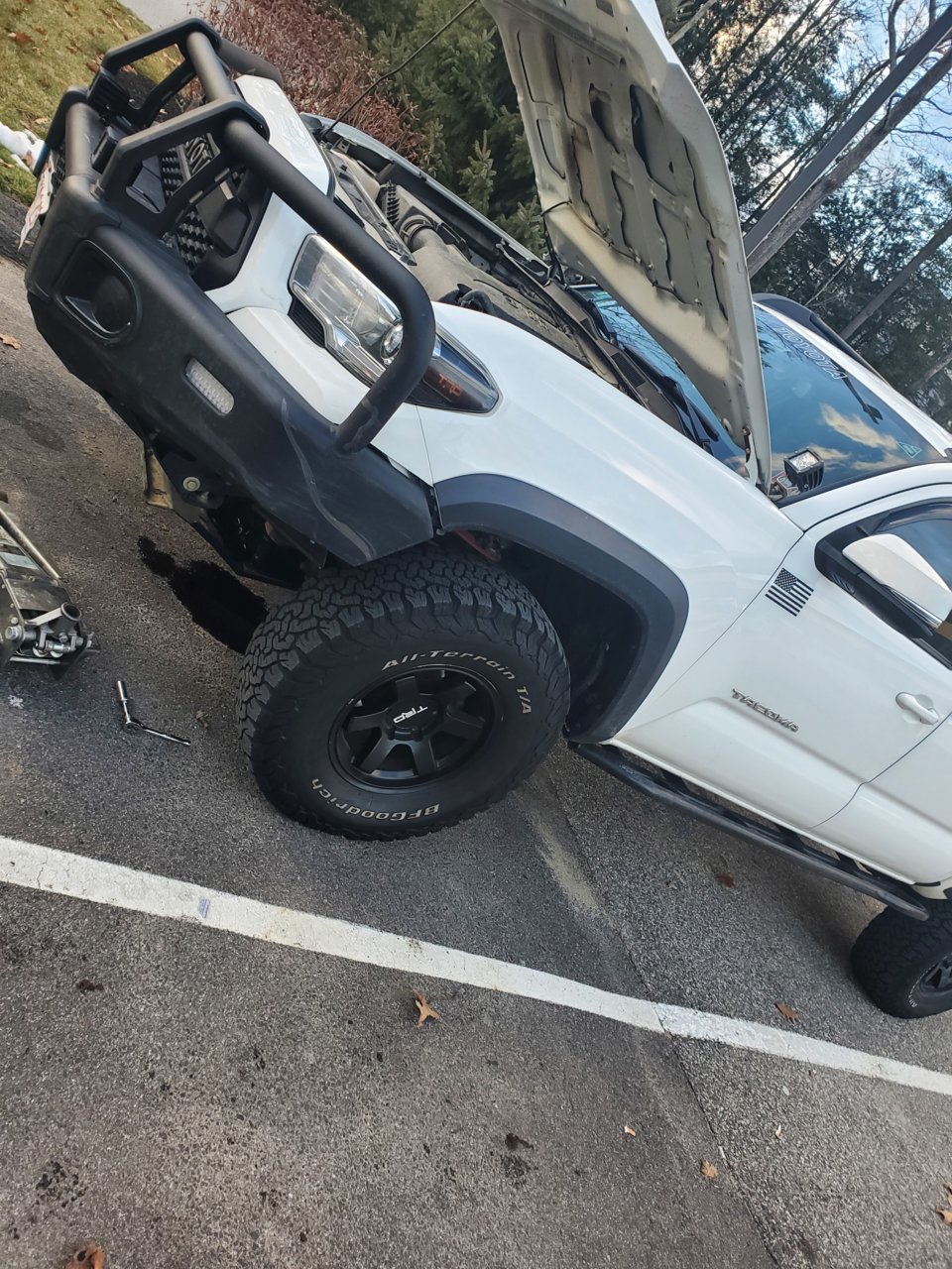

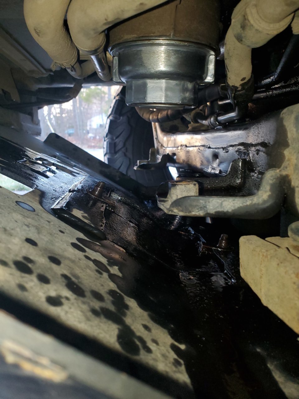

    Yea wow look at this my metal one is weeping to after a complete failure of the plastic one. No idea how this happened but its what I saw when I laid down under the truck. Had to go get parts with a stranger and fix it at a gas station. Will be getting oem metal this is a dorman
    Junkhead[QUOTED] likes this.

    Dirtridercrf250
    Dirtridercrf250 Well-Known Member
    May 5, 2017
    #218232
    1,738
    One got me home last night

    So wait, your plastic housing wasnt OEM?
  13. Jan 19, 2021 at 7:38 AM
    #513
    Dirtridercrf250
    May 5, 2017
    #218232
    1,738
    Plastic was oem

    1,635
    Brian
    North Adams, MA
    The plastic cap is .02 - .03" larger diameter in the o-ring groove. Since the aluminum cap is smaller, sometimes they seep, sometimes they don't. I machine all my billet caps so this sloppy fit is never a problem, nice and snug.
