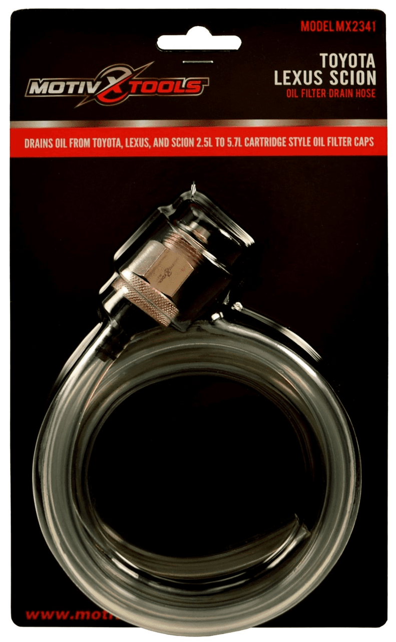

    I put a Fumoto valve on the oil pan and use the tool pictured below to drain the filter housing. I thought it makes for an easy oil change.
