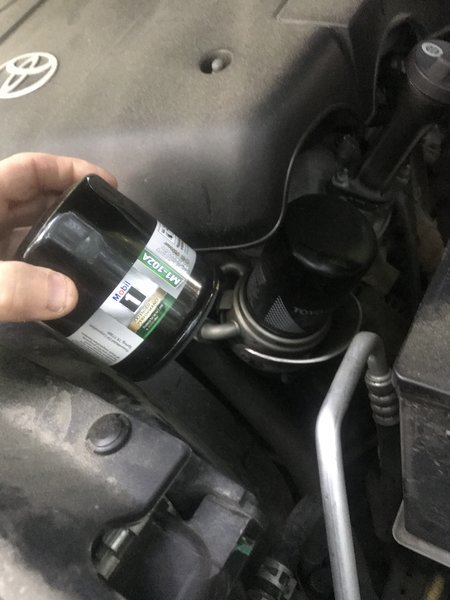

    I've already bought it and I'm out in the country. Is it the right filter? I'm a bit hesitant.

    If it fits, it will work fine. It will just have less filter media. If in doubt or it doesn't fit, just reuse the existing one until you can get another. Easy to replace, and you'll lose only a tiny amount of oil. This assumes you have an extra .5 qt oil handy.

    From what I've seen, aftermarket filters sometimes tend to be on the small side. I've seen a Bosch Distance Plus oil filter for our trucks and is only about 2/3 the size of OEM.

    That's about the size of the Bosch. They're smaller because they have less filter media that is supposedly more efficient than OEM.

    They only list that one filter for Toyota, and Toyota use a few different filters of different capacities, but all have the same thread and fit. My old 3.4 used a D1, which is shorter that the D3 specified for the 4.0. but you'll be fine with that.

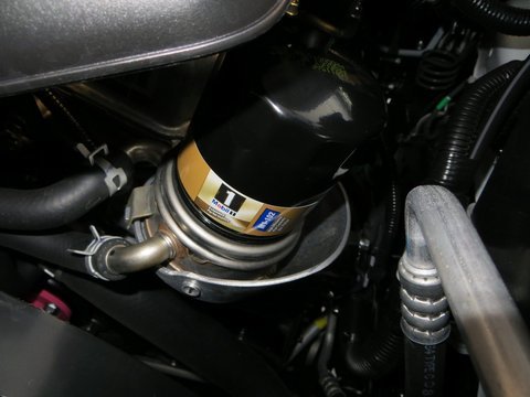

    The 102 is what the book says to replace the OEM filter. However, the 209 also fits and is a larger capacity filter; it's what I get when it's on sale, or there is no sale on other filters. I've also used Wix 51516XP, Purolator One PL20195 (and PureOne), Royal Purple 20-400, and Fram Ultra XG3600.
    I'm guessing that the "A" in 102A is the new filter designed to last as long as Mobil 1's new 20K mile oil.

    Honestly, I would just toss it out and go buy an OEM filter to use. Sure you lose $5 but it'll put your mind at ease, and may prevent possible trouble ( faster wear on the filter due to less media in it, poorer filtering, etc.).
    But again, the bigger thing is peace of mind, which is priceless ( at least for me with my taco)
