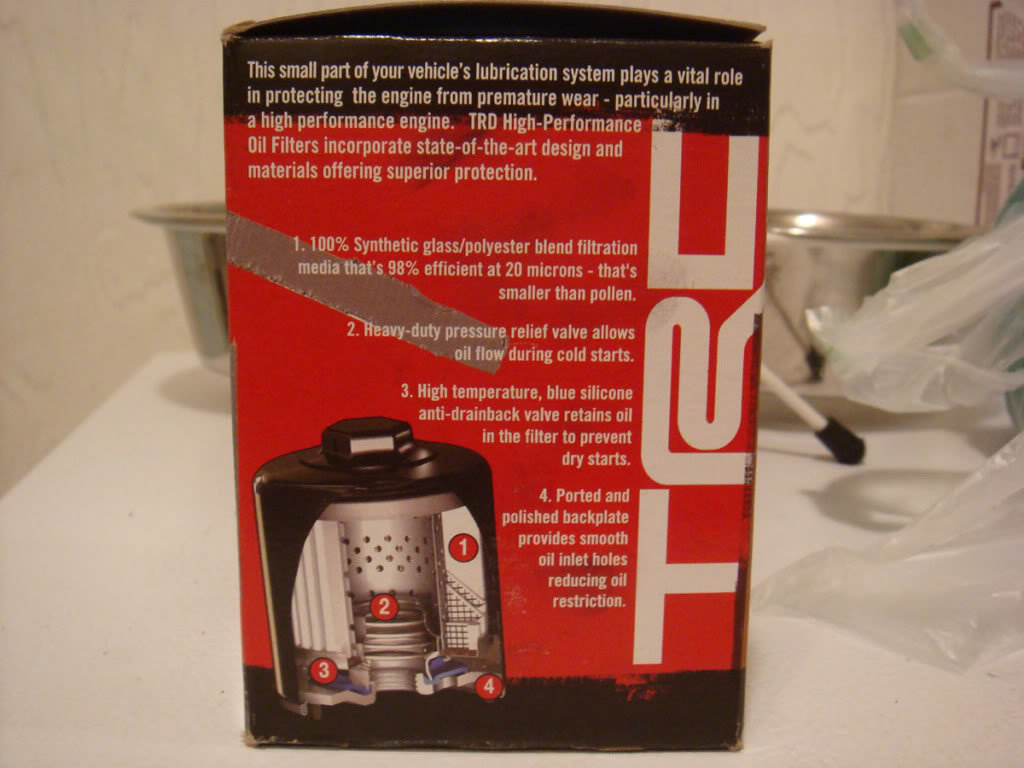

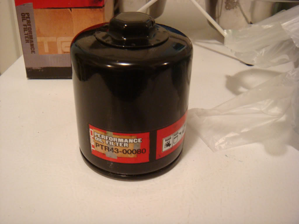

    Toyota owns Denso. It's a Denso if it's like OEM and not the TRD version.
    (AC/Delco is completely different.)
    The Toyota/Densos in all these tests were a 90915-YZZD1s.
    You can also buy a Toyota TRD filter from the dealer parts counter if you specifically ask for it. (or order it online) These vary by manufacturer and design, but the PTR43-00080 I use on my truck, is very similar to the K&N and Royal Purple filters and is US made.
    I did not test any TRD filters, but my part number says on the box that it is 98% efficient @ 20 microns. I expect these TRD to filter better than the OEM standard filter and still have good flow characteristics...but they cost quite a bit more, too.
