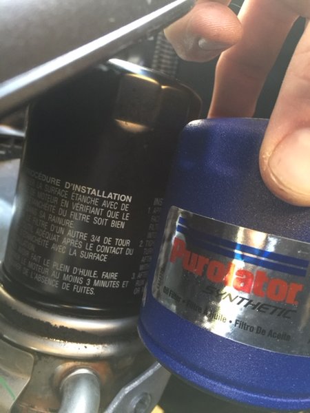

    I just stocked up on 4 oil filters. I just got the truck and I have always used Purolator filters and full synthetic oil. I looked up the part number for the Purolator filters (before and now after ordering), but I am surprised to find this part (PSL10241) to be a bit shorter than the filter installed by the dealer. Is this common?

    yep, common and won't hurt a thing
    I've been swapping between these and a Toyota filter that IS NOT the correct part (15601-76009-71 for the really anal and doom sayers) number but works for several years, 205k on my 97 Runner. Will do same on my recently procured Tacoma.
    that you use a QUALITY filter of similar size is the most important.

    probably wont hurt a thing.... just next time when stocking up hit up ebay... you can get 10 OEM long filters and 10 drain plug gaskets for 40-45 bucks.

    Housing size doesn't mean much, it is the area of the filter media that does (among other things) which can vary significantly between brands of the same size filter.

    The Wix oil filter and many others are also shorter than the OEM 90915-YZZD3. I've yet to see one that's as long as the 90915-YZZD3. There may be one; I just haven't seen it.

    The closest WIX filter to the longer OEM Toyota is a 51516. Have used since 1st oil change, and been very pleased.

    Use the bigger one: PSL20195, or Mobil 1 M1-209, or the Bosch D3422, or Royal Purple 20-400.

    That Purolator filter seems the size that the 4-cylinders use.

    the length of the filter doesn't necessarily mean that it will hold less oil in it or filter less. These after market companies makes filters vehicles specific so I am pretty sure they have done their homework and made a filter that will hold close to or as much media as the OEM filters do. In this case, size does not matter as much as long as it holds the same amount of media or you are making up for the difference in the amount of oil you are putting into your truck. it's all in the size of the media the filter can hold. I've never cut one open but maybe the OEM filter just has some wasted space, that's why it is longer than all the other filters. this is just MHO! I use Wix-51348 which is what is called for the Tacoma and when I pour in the required amount of oil 5.5 qt, it puts the oil right at the mark as it would with the OEM filter. Hope this information is helpful and doesn't get people to caught up on the size of the filter but focus more on how it functions. Giggity!
