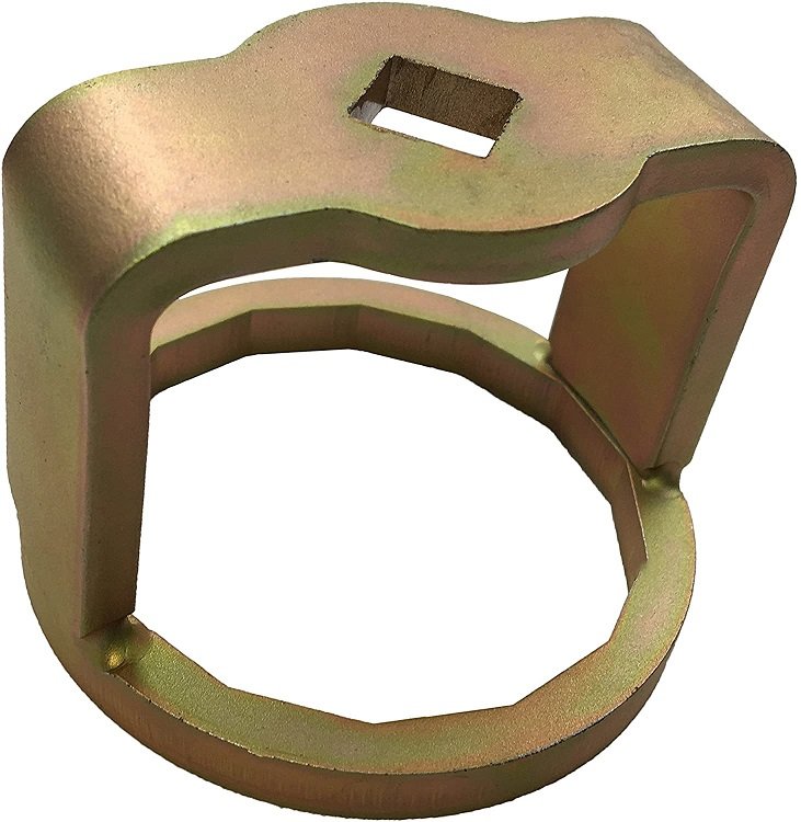

    good filter tool for 2020 Tacoma v6

    The last dealer that did an oil change on my truck used an impact wrench to put mine on. I had to use an impact wrench to get mine off. Just a warning if you have trouble.

    I would not suggest an impact to remove, ever. If it is over torqued then use a breaker bar and a snipe. The constant pressure is less likely to damage the housing versus the constant impacts that will cause damage.

    I have the same oil filter tool for my 2017 Tacoma SR5 v-6 3.5l. Works great!! This design allows you to use a 3/6 drive or a box wrench to remove the plastic filter body. Honestly, I'm glad I purchased this tool and do all my oil changes my self. The local dealer over tightened the drain plug and the oil filter canister. Now I do the work and make sure everything is torques to specs. My brother also has this tool and uses it on his 2015 4-Runner... He also likes it.

    I just bought a tool from my local parts store. (Canadian Tire). It was $9.99 and does the job.

    MotivX makes a drain tool too. Way better than those plastic things that come with the filters.

    Motivx one is the best designed for our filter housings.
    Also a good time to order the factory Aluminum filter housing instead of the cheap plastic one these trucks came with.
    PN: 15620-31060

    I’ll second this, if you are doing your own oil changes, just pay the $20 and get the metal housing. So much higher quality and don’t have to worry as much about rounding off the plastic corners.
