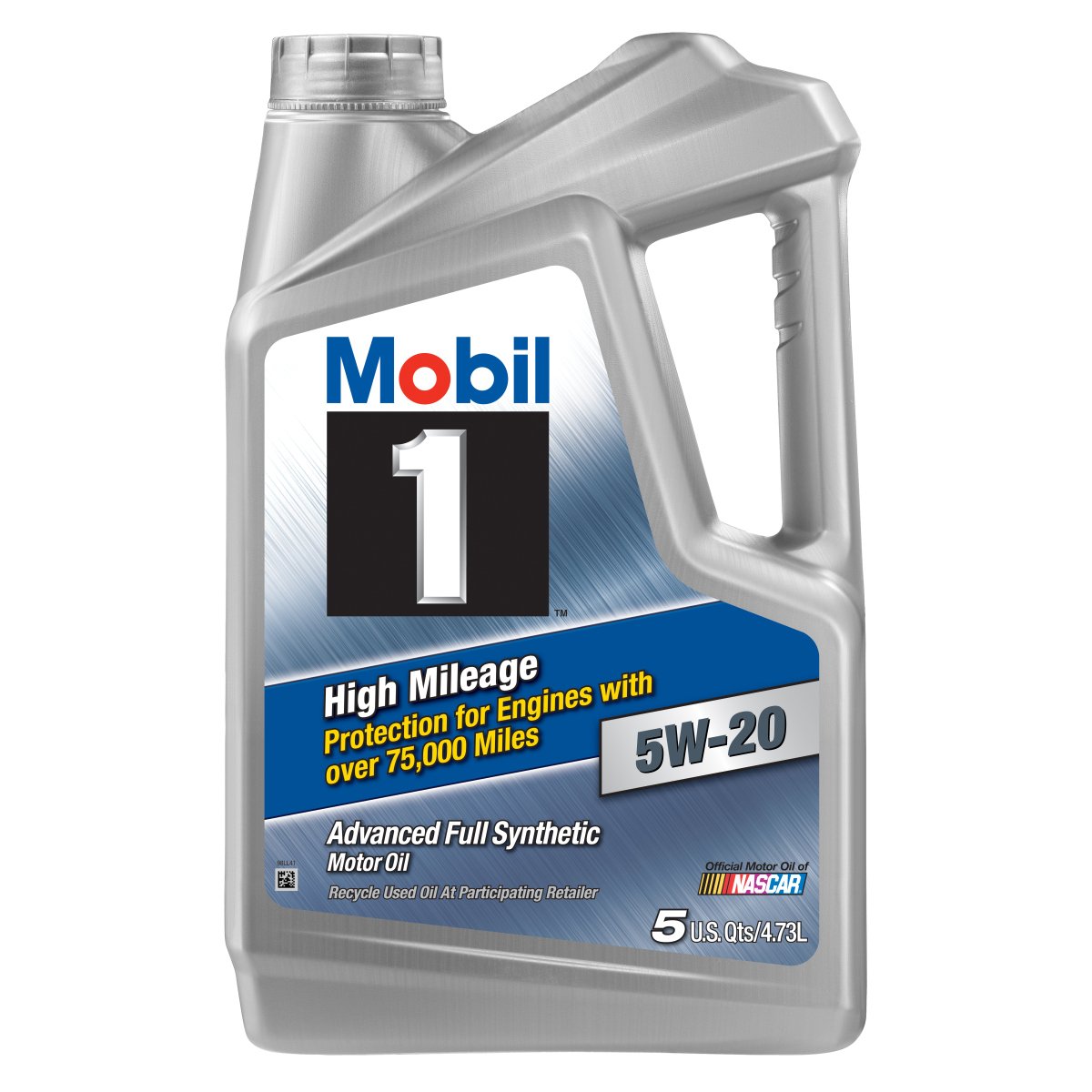

    My 5spd 4cyl has 217k miles on it and it used to burn about 1-1.5qts per 5k miles. I switched to mobil 1 high mileage and no longer have this problem. Its a full synthetic just like regular M1 but it has higher heat protection to keep it from burning. Solved my problem, maybe it will work for you as well. Good luck

    Awesome! I just changed oil last night and went to the Castrol 5W-30 High Mileage but it is a blended synthetic and you say your High Mileage is a full synthetic?

    Yep, its a full synthetic. heres a pic of it
    Its the middle one in the diagram above. Notice the three stars for high engine temps vs. the 2 for regular M1 full synthetic
