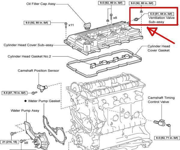

    PCV Valve; Everyone seems to always dismiss this. A bad PCV valve will increase oil consumption. Replace it

    Considering how cheap they are; its a quick replacement about 10-15 minutes of work. Bad PCVs can blow out seals if they are clogged or they can suck in oil that goes into the intake tubes and burn oil. I've seen it on so many vehicles; folks comes to me and always tells me they are burning oil but the vehicle only burns a quart or so every so many thousand miles, some even every thousand miles. I always replace the PCV and oil consumption issues are fixed or either seals stop blowing because a clogged PCV can actually cause oil leaks due to crankcase pressure.
    Change it and report back after 1000-2000 miles and see if your oil consumption has improve(lessen)

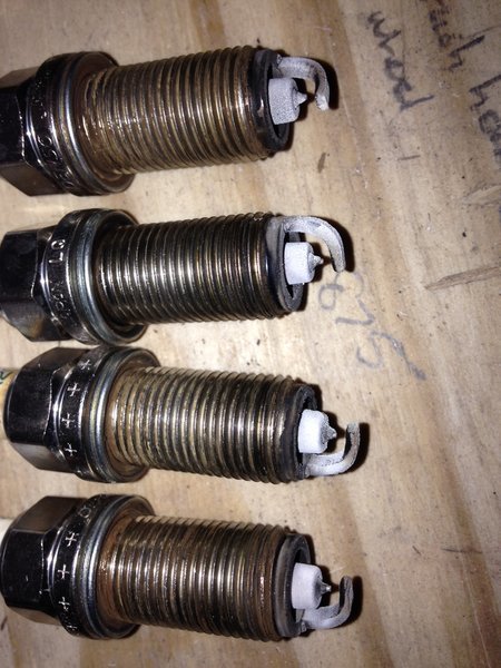

    05 Prerunner 4 cyl manual 226,000 miles
    These are what my Denso plugs looked like. Thoughts?
