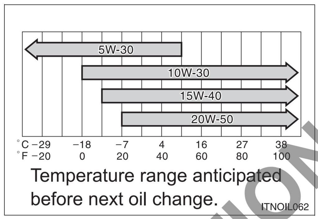

    As proof, you need to look no further than Toyota's owners manual for vehicles with the 1GR-FE engine outside of the US. This, for example, is from the 2014 Toyota Hilux in Australia:
    Obviously, it gets pretty hot in Australia. But it also gets hot in Arizona, and note that the chart specifies a range of temperatures from -20F all the way up to 100F - exact same range as on the US chart!

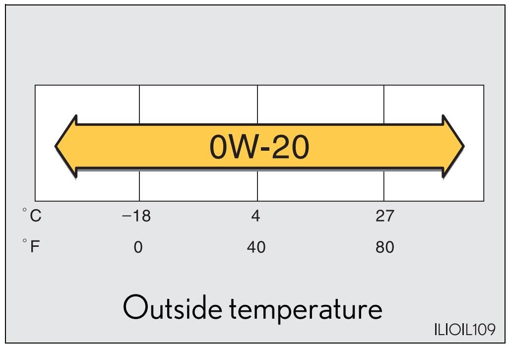

    Contrast that to the US manual for the Tacoma with 1GR-FE:
    I also peeked at the owners manual for the FJ Cruiser in AU with the 1GR-FE, and it had the exact same chart as the Hilux.
    Now, are there differences between the 1st gen 1GR-FE delivered in AU and elsewhere and the one we get in our 05-15 trucks? Very likely, but I'd bet anything that the bearings and clearances are the same, which is what really matters for oil pressure and such.

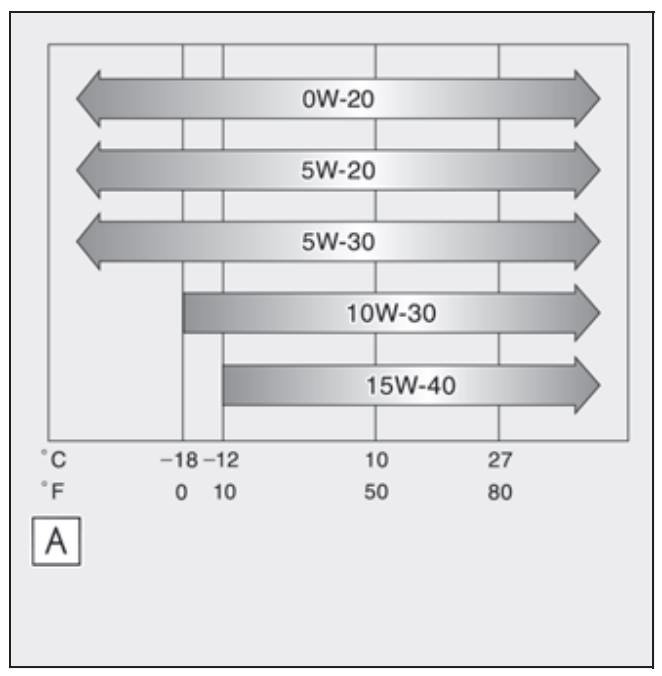

    For you 2016+ owners, it's much the same story only Toyota now recommends 0W-20. The 2GR-FKS isn't offered (to my knowledge) in any trucks anywhere else in the world, making comparisons difficult. But it is offered in lots of cars - likely with different cams, intake, and exhaust manifold if I were to guess. But it's largely the same engine.
    For instance, the Lexus RC 350 uses the 2GR-FKS in both Australia and the US. Helpfully, all RC 350's are built in Japan, so they should be very similar aside from one has the wheel on the wrong side. Here's what the Australian owner's manual recommends:
    Compare and contrast to the US owner's manual, which exclusively recommends the same 0W-20 as the 2016+ Taco:

    The difference between 5w30 and 10w30 in the first chart seems odd. Also if cooling system is working as designed should the operating oil temp be the same for all climates, therefore only the first number is important when starting? I've always heard lower is better for cold starts.

    Yes - or does it? This was actually a quite common way for manufacturers to spec oil back in the day. I keyed into this on Doug DeMuro's recent vid on the Grand National:
    But just because someone else has done it doesn't mean anything.
    From research, I believe it's due to the way conventional oils break down. While the 5W-30 and 10W-30 may have similar specs when new at 200°F, after a while the 10W30 is going to offer superior viscosity at operating temps.
    This isn't as much of a problem with many modern synthetic blends and full synthetics, and VII's (Viscosity Index Improvers) have gotten better.
    I would think of it more as a range of operating temperatures rather than one single operating temperature. Your thermostat opens up at a certain temp, but that's not the highest temp the water can be, right? The range for oil can comfortably span 50 degrees F or so, and while a 0W-20 or 5W-30 may be good enough at 200°F, it might be too thin at 250°F.
