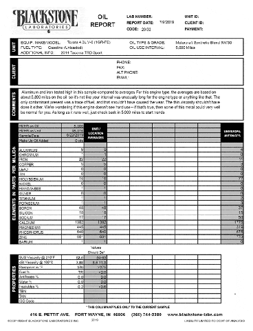

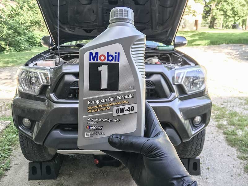

    Time for an update: as mentioned previously, I'm switching to 0W-40, specifically Mobil 1 FS ECF.
    This particular oil gets rave reviews on BITOG and has a lot of fans, including many converts from 5W-30 in other vehicles.
    After doing the oil change with 0W-40, my engine exploded immediately. Tullie D, you can stop reading here.
    Actually what happened is pretty much nothing. The engine sounds and feels quieter/smoother, but it generally did after every 5W-30 oil change as well. It's really tough to say whether it's quieter than the last time I poured fresh 5W-30 in given that was about nine months ago. I feel like it's the quietest it's been in a while, but that could be confirmation bias sneaking in. I have about 300 miles on the oil as of right now.
    Regardless of how I feel about the sound of the engine, I did a used oil analysis on the 5W-30 that I drained out:
    It is worth noting that this particular 5W-30 had thinned down well into the middle of the 5W-20 range by the 5,000 mile mark. This is not uncommon and every multi-weight oil loses viscosity over time.
    When I come up on 50,000 miles, I'll do another oil analysis on the 0W-40 and we'll see where the chips fall. Based on my driving habits, that won't be until about March of 2020.
    I track my fuel economy with Fuelly and we'll also see if there is any discernible change in my MPG.
