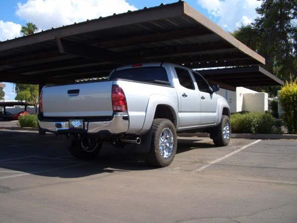

    After seeing how nice a "clean" looking Tacoma is, I finally de-badged my truck. I figuered Id try a few different ways to do it. First, I was going to use fishing line as the tool to remove the emblems from the body. I tried removeing the emblems when "cold", 78* this morning. As others have stated, the emblems should be warm to remove. After I removed one cold, I realized this, as it was a B*TCH to remove. Also, fishing line will break pretty easily, so I needed a "Lubricant" to assist its cutting thru the adhesive. I pulled my truck into the sun light, and in 30 min. the trucks body temp. was at 105*. SO, I got started again. I liberally sprayed some System One Wav on the emblem I was removeing, and the fishing line started cutting right thru. I re-sprayed about every letter or so. After the Emblem was separated from the truck, Body Temp now 110*, I used the spray wax and an old rag to slowly wipe off the adhesive residue. I worked it in a rolling motion, and it came right off. Did this to the remaining emblems until they were all off. After I was finished, a quick wax revealed no "Shadows" from the emblems, and the end result looks great! Im really happy and Im not sure why I waited so long. FWIW, I used 10 feet of cheap fishing line. Also, WD-40 did nothing to remove the residue. :confused:

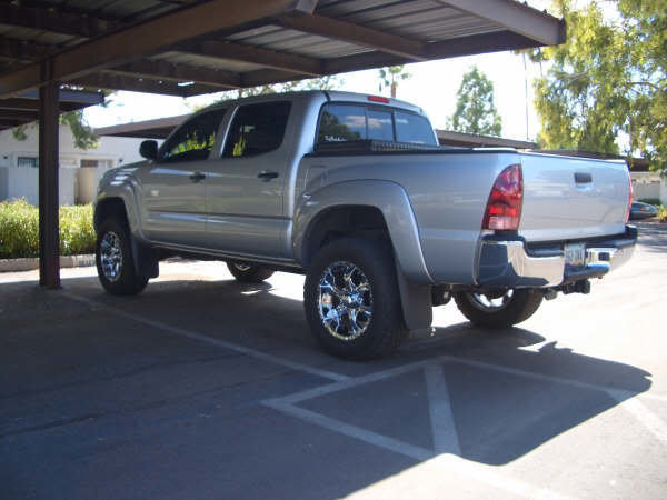

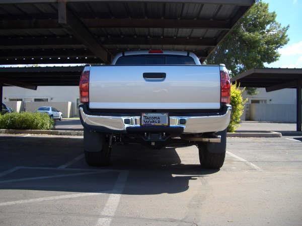

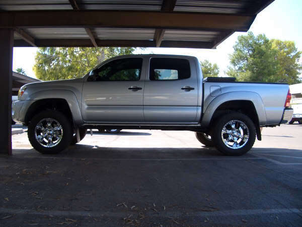

    Ok, Here they are:

    Awesome job Chris, that truck looks very clean!

    Wow very clean look, might have to consider that myself

    Ahhh Yes,The simple things...Even though it's silver.lol, It does look good.:D Welcome to the club. :cool:

    I liked it better with the badges, but thats just my style.
    Which toolbox is that and how much $$?

    Yeah. Im not sure what I think about it. I mean, I like it, but I thought it was fine before too. Main reason I did it was because so much dirt and shit gets stuck in them and to make it nice and clean meant getting a tooth brush and cleaning the gunk out of the badges. This makes cleaning it MUCH more easy.
    It a Husky Low Profile tool box from Home Depot. $249.99 and on sale for $199.99. They go on sale often.
