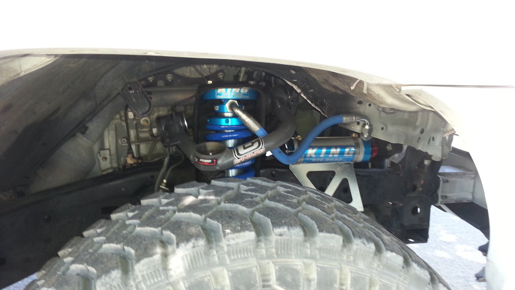

    I was also thinking of all Icon till I saw some scary looking photos and posts of broken top plates here on the forum. one also had a busted shock tower. My guess is they were getting air or pounding hard but Holy &$^*.
    Tacomanator, how are you liking your setup? What do you have out back? Also looks like some rough cutting was done in the wheel well. Whats going on there?

    The wheel well isn't cut, I had to bend it quite a bit to install the uca's, then pound it back into place. It's a step everyone has to do when installing uca's. Some people just make it look prettier than others.

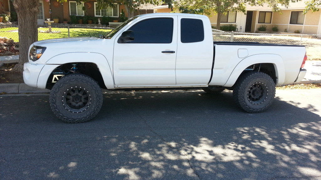

    In the rear I have 2.5" Kings with remote reseis at stock height. Icon AAL to come soon...
    I'm really happy with the setup. Rides nice on the street and soaks up the bumps in the dirt.
