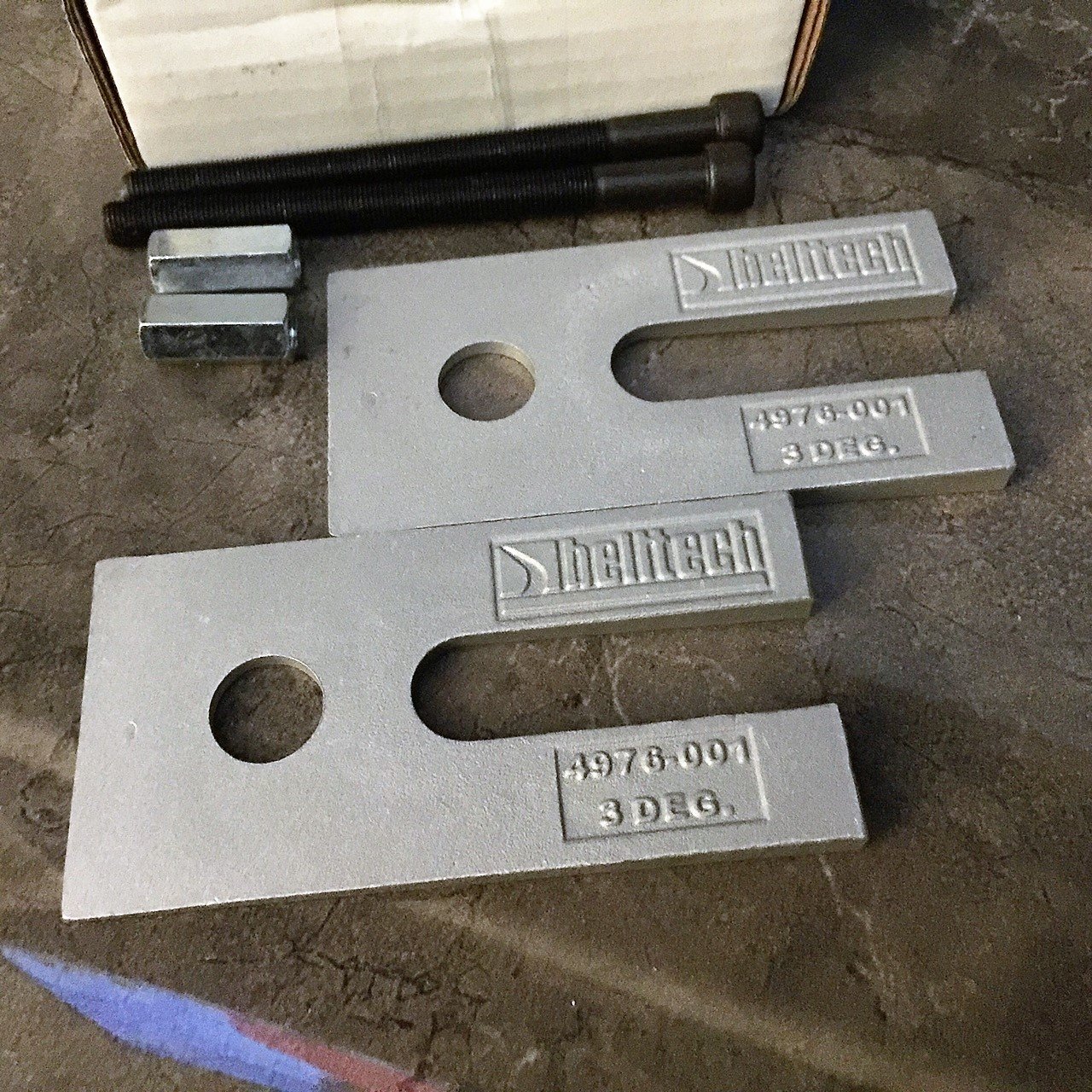

    Are you running shims? Most use a 3 degree shim with the Dakars.

    You also need 3 degree shims above your rear leaf packs

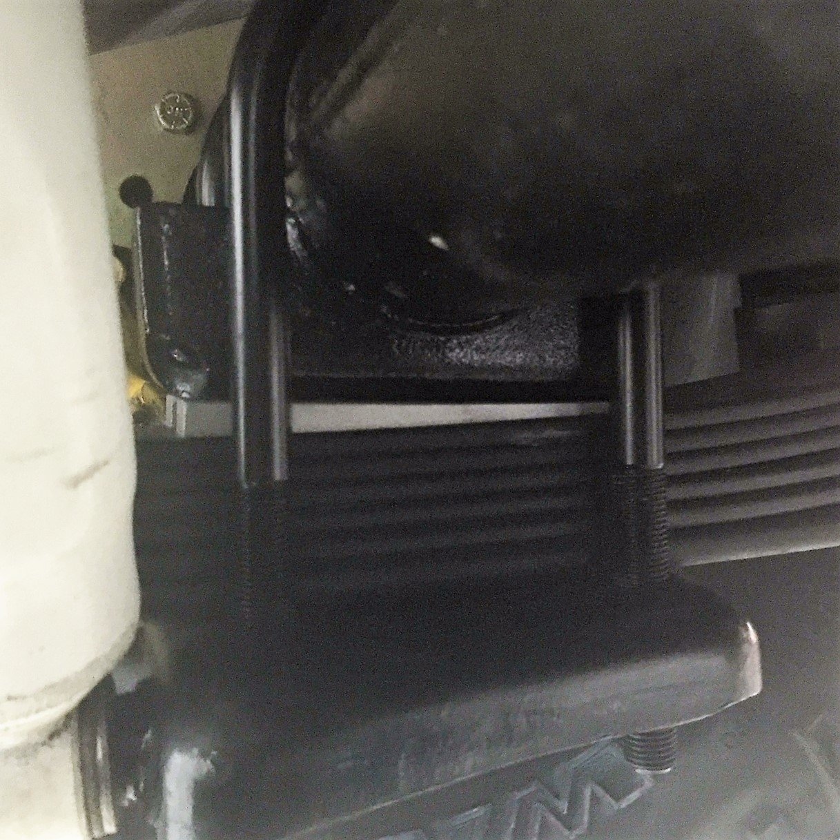

    As others said, CB drop, ECGS bushing AND 3* shim. That’s what I run in my 17 OR and I have no vibes and a smooth ride

    If you have the ECGS bushing then you likely need 3 degree shims. I bought the $35 Toytec ones because they come with replacement bolts

    @Mistaken hey man I have 2.5 degree shims sitting in my garage, they’re brand new - I ended up not needing them for my Dakar pack. You’re welcome to have them just reimburse me for whatever it costs to ship them. I’m guessing a flat rate envelope would be pretty cheap.
    Good luck with the vibes either way.
    Edit: they’re from headstrong off-road if that matters...

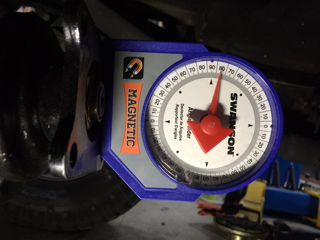

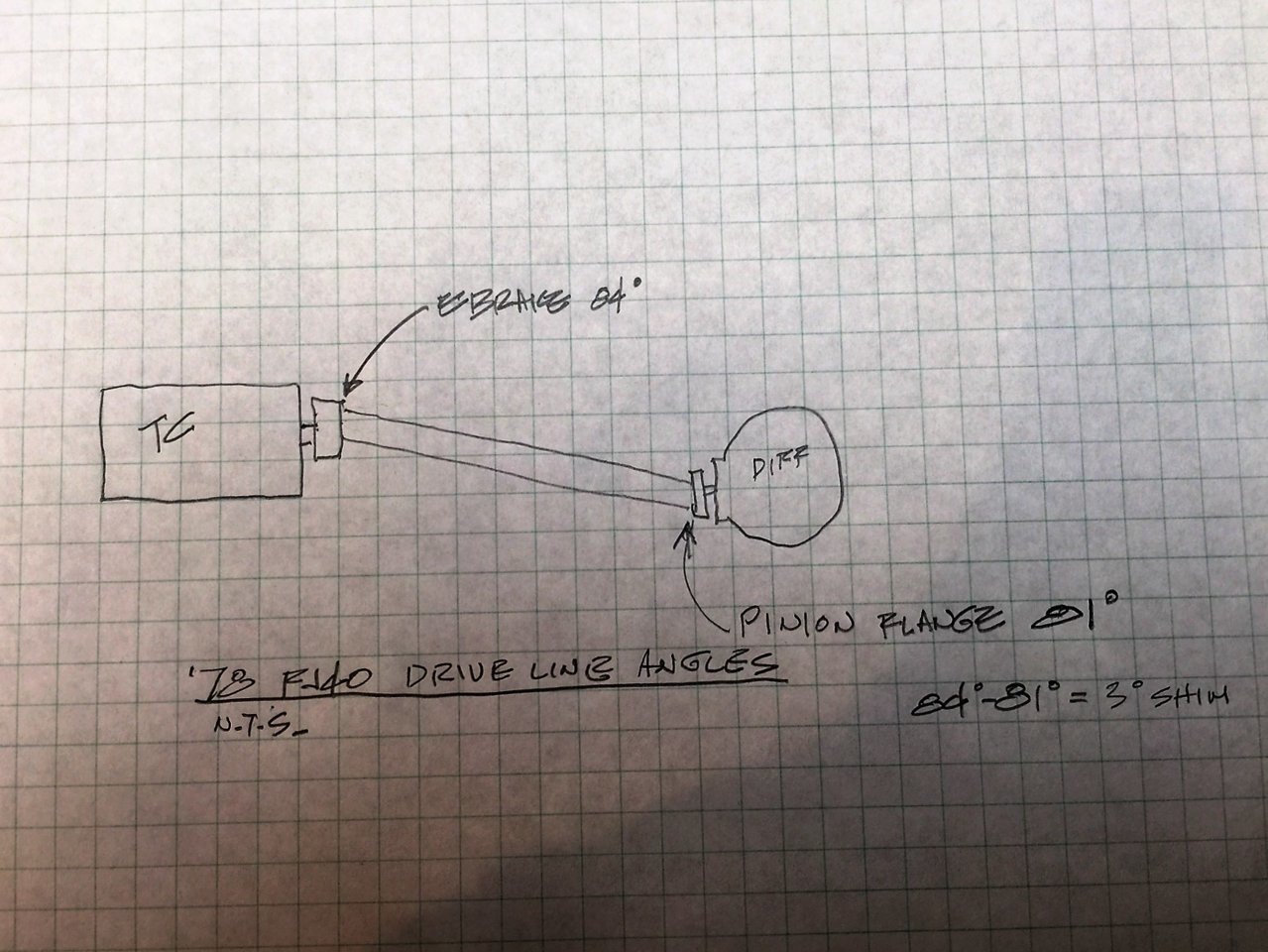

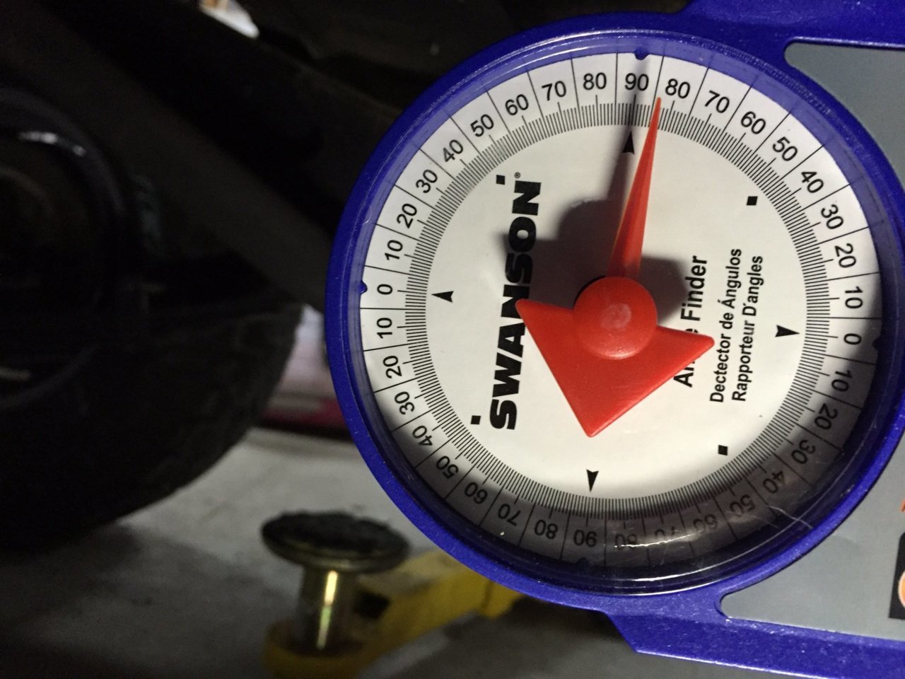

    It's most likely a drive angle issue, for $10 you could buy an angle finder and check your angles.
    This is how I fixed my drive line angles on my 1978 Land Cruiser FJ40.
    To Determine the angle difference you will need a magnetic angle finder, from Lowe's for under $10
    Pinion flange angle reading
    E-brake angle reading
    Do the math
    Use shims to correct the angle
    Place shims above or bellow leaf springs according to your truck configuration and you're done
