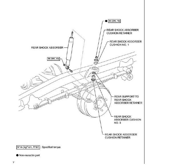

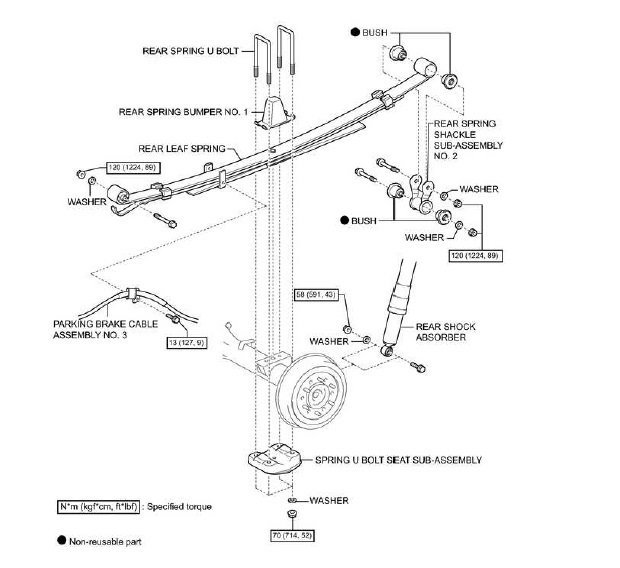

    rear susp 1_zpskh1jnnlr_01e8bce45023281aebf332fc3da90458d4052d15.jpg Here you go.

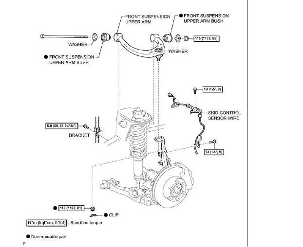

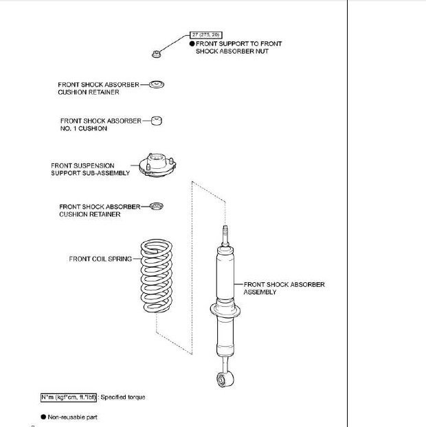

    Gosh, thank you....very much appreciated
