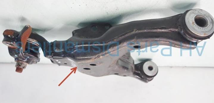

    6. Now use a floor jack to support the LCA; start jacking up the LCA until you see the suspension start to compress about 1” or more NOTE: It's more critical that the jack doesn't slip off the LCA, so position it in a place you'll have room to adjust for the LCA's travel arc. The spring is encapsulated by the UCA and the other suspension components and the spring pressure will just push straight down using the shock as a guide pin.
    Image shows where you most likely want the jack to make contact on the LCA.

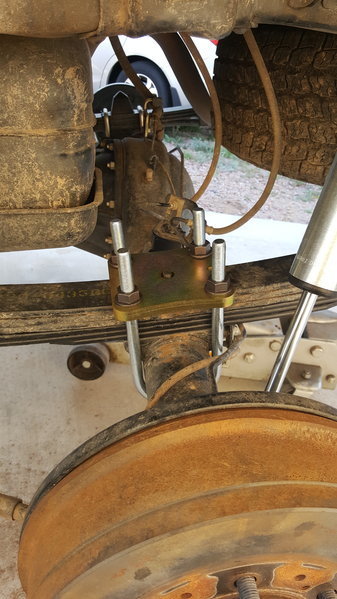

    Pic here shows center pin has been cut, U-bolt excess not yet cut
    8. Jack up the axle and guide the spring center pin head into the hole on the axle perch. Once in position install new SUPERBUMPS that go with the All Pro Kit u-bolts provided and tighten (you will torque to spec [75-80 ft-lbs] once truck is back on the ground). Use a deep socket to install The All Pro Flip Kit nuts –they are 7/8” but a 22mm socket may work too. Tighten down Ubolts counting the turns or keeping track of threads showing, alternating from nut to nut, this helps ensure axle stays in alignment.

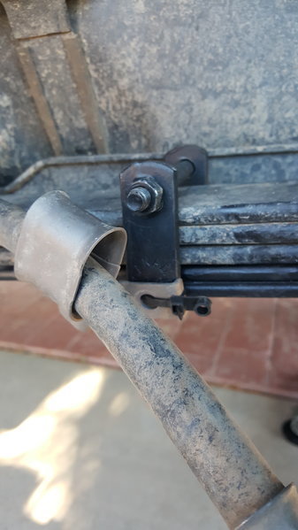

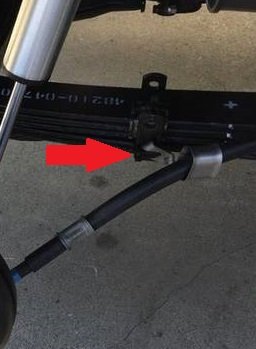

    11. E-brake Bracket this is a source of debate but @GPsevinSixx and I both ended up using heavy duty zip ties to reattach the line bracket to the bottom hole of the new AAL guide clamp/retainer. This doesn't allow the cable to kink at all. If you mount with the bracket bolted up higher to the clamp bracket on the AAL, it WILL lift and kink the cable. You DO NOT want these lines to kink.
    May want to flip bracket like the above photo however.

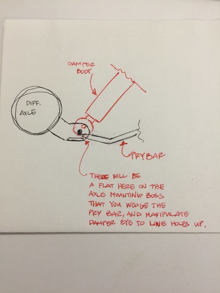

    1. The lower mount can be a bitch to get in, definitely helps to LUBE the bushing up and use a pry bar to guide the lower mount into the boss angled from the bottom up as opposed to inserting from a top down angle of approach. Have either a large punch (that fits somewhat loosely in the bore) or the bolt ready. The punch is easier as the bolt requires an exact lineup as bolt thread diameter is the same as the hole diameter. Once the punch is in location, you can wiggle it around and insert the bolt from the opposite side. Just make sure it's the same as factory orientation.

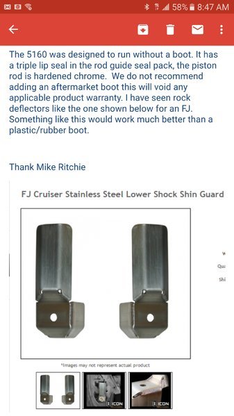

    3. Do not place a shock boot over the 5160s, I emailed bilstein about this and they said it WILL void the warranty as the boot will trap moisture and debris. Instead Wheelers sells a plastic Roost Shield made by Fox that can be easily modified (I used a dremel grinder) to secure to the bottom of the 5160. You only need one for the passenger side if you want to do this and wheelers will sell them individually. Bilstein tech did say the 5160 is triple chrome plated, sealed yadda yadda designed to protect the shock without use of a boot but I opted for the Roost shield as I have heard others use it. To install the Roost shield I bolted the shock in first and then finessed it on, it was a bit of a pain.

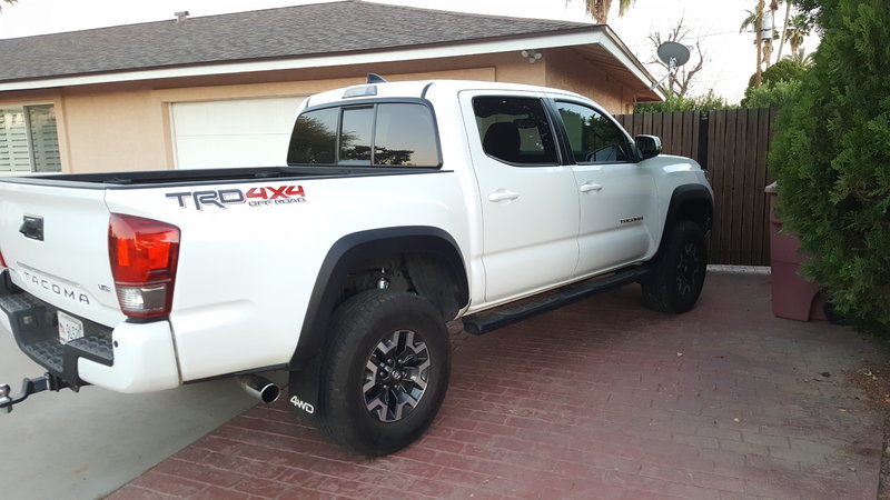

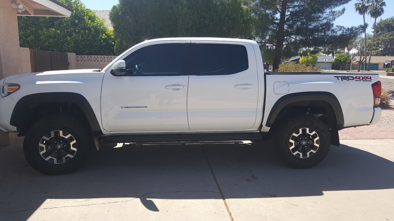

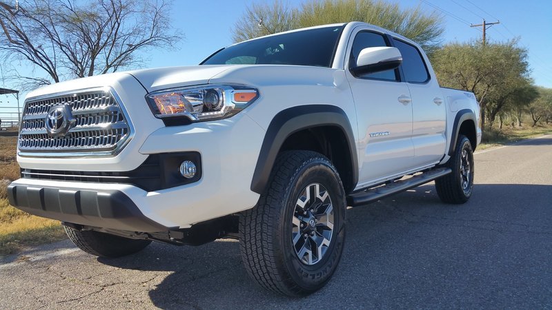

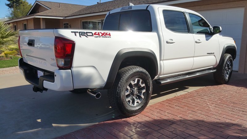

    How it sits today. Sorry didn't do a lot of Before/After shots. Maybe someone can add some more.
    Before:
    After:
    20170326_184230.jpg 20170406_140756.jpg 20170405_121458.jpg 20170405_121519.jpg

    You're welcome. Hope it helps. This is a popular combo for lifting. Keeping at 2" or less should avoid some headaches as well as maintaining or improving superior ride characteristics.

    6112s ride great offroad and on road. Slightly firmer ride on road not as floaty/boaty as TRD OR but not harsh. It will really soak up the bumps off road now. Feels much more in control and planted. Also corners better probably due to slightly firmer spring. Very slight difference in on road ride but much more noticeable off road. Love it. Highly recommend!
    Here is another guys feedback on 6112s who has run 5100s as well... he said he would not recommend 5100s to anyone again based on how much better the 6112s perform.
    https://www.tacomaworld.com/threads/bilstein-6112.421995/page-21#post-14274086
