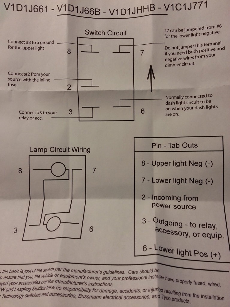

    Im using the OTRATTW switch. From your harness does this look right?
    White to #2
    Blue to #3
    Black to #8
    and #7 can be connected to #8?

    Not sure if you were able to complete this project yet but I finally got my sh*t together and just completed mine. I got really hung up on the wiring for switch illumination. problem being I had to try several different wiring diagrams for my switches since mine didn't come with schematics. I ended up doing:
    White to #2
    Blue to #3
    Black to #8
    and #7 can be jumped from #8
    12v from dash light illumination to #6
    I found the 12v from the empty fuse slot (on the top, 3rd from left just right of a 10amp). This fuse block is located behind the change drawer. As a matter of fact, here is a killer write up... http://www.tacomaworld.com/forum/li...gen-7-hid-lights-attn-proforce-rich91710.html
    THis should really answer any and every question you can have!
    BTW, that 12v is only on the lower side of the empty fuse slot. Check it with your multi meter, you'll understand. Hope this helps!

    Yeah man I did, thanks for the reply. Found out the problem was my add a fuse. I was not getting power in one direction. I rotated it 180 and plugged it in and got power.
