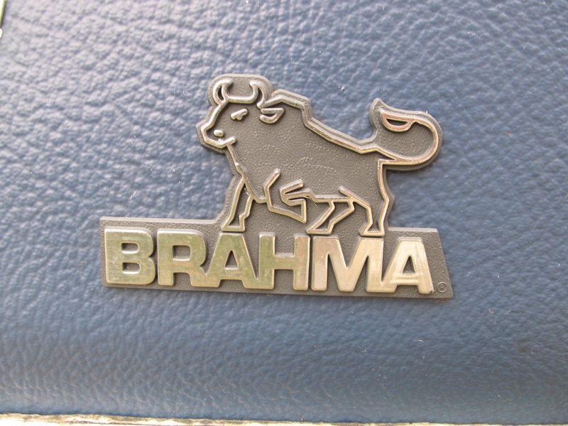

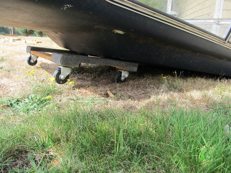

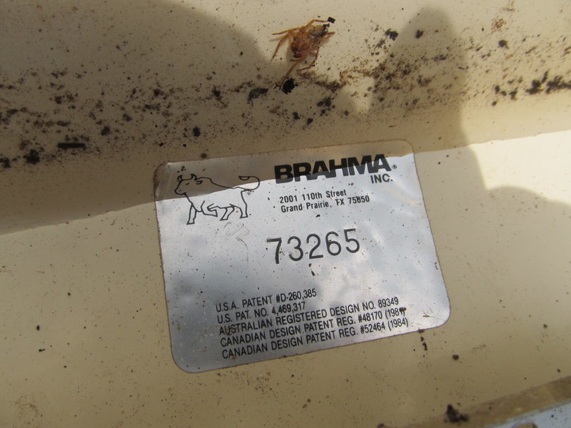

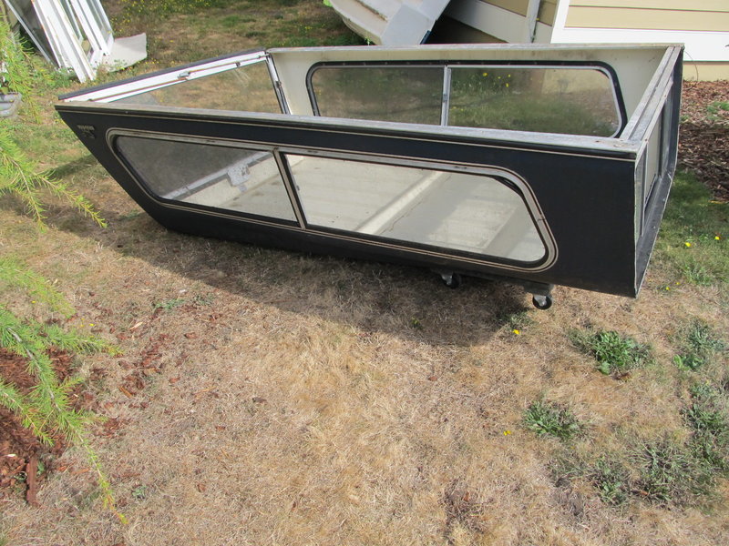

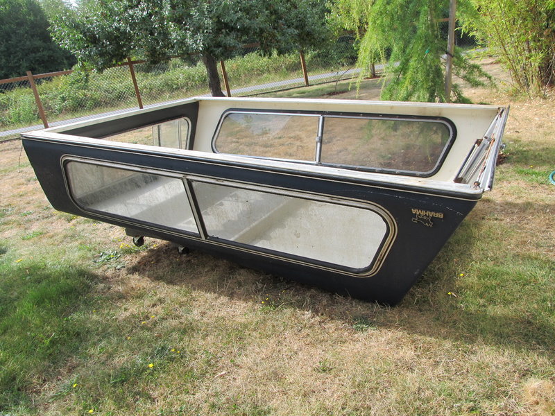

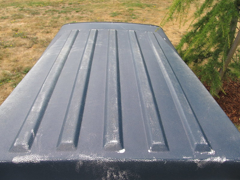

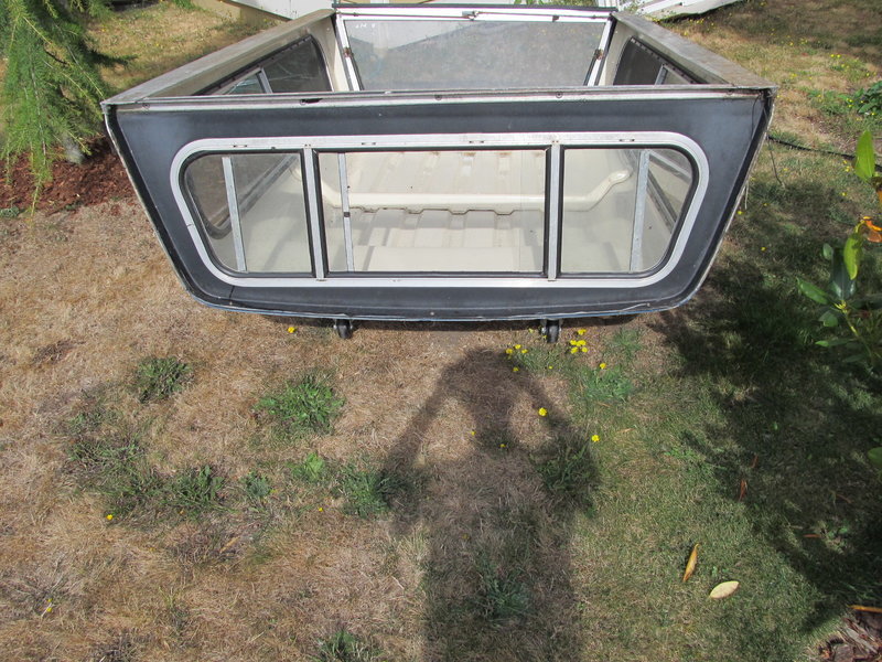

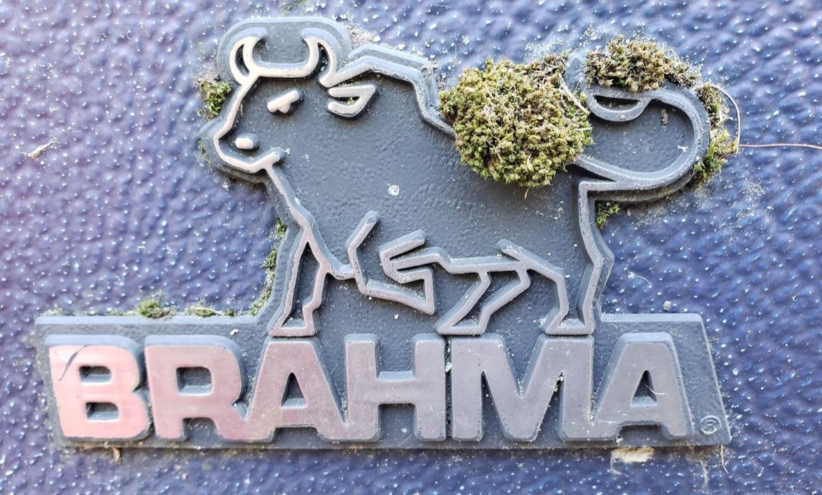

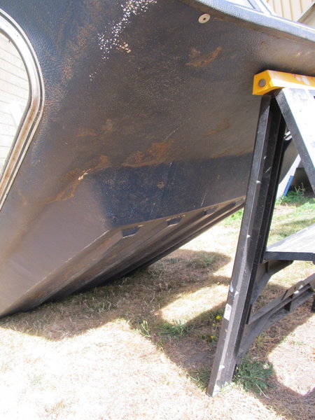

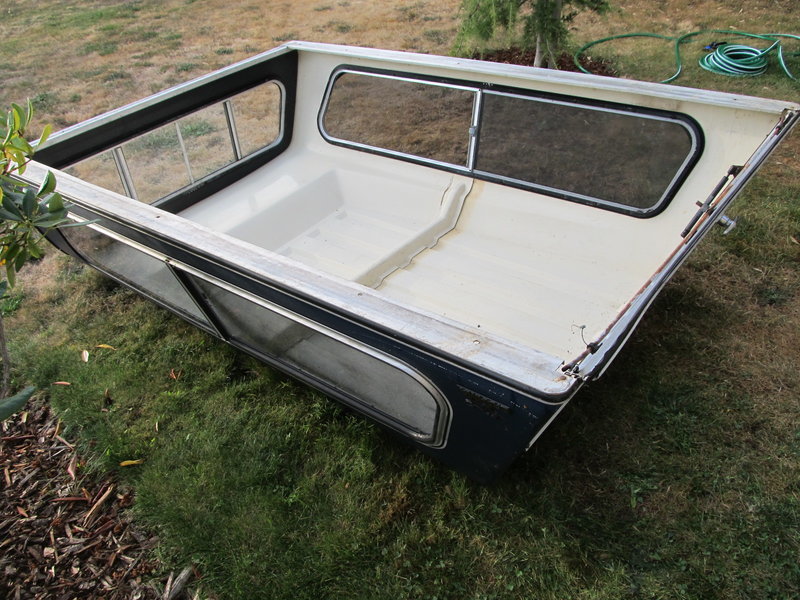

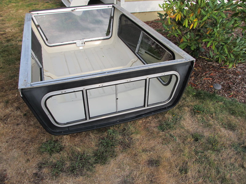

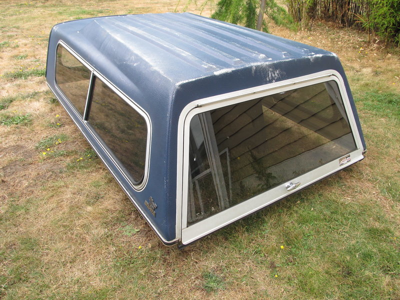

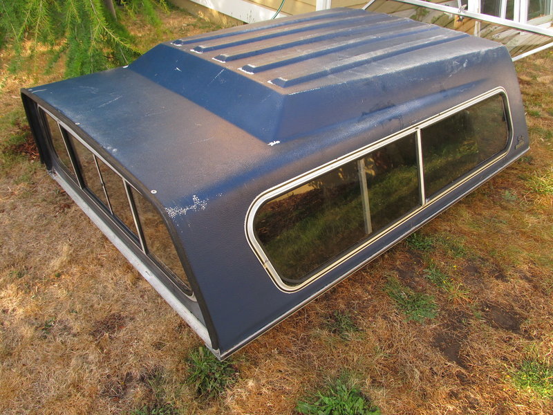

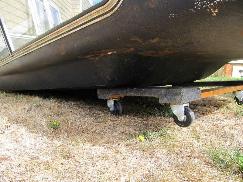

    I rescued this "free" Brahma shell from the side of a road. I believe it fits 1st Gen Long Bed... Thankfully, it was sitting on top of a 55 gal. drum and I had a piece of plywood in the bed, so I was able to roll it up & slide it into the GMC by myself. It was covered in moss, filth, insects, & spiders. But, after a good sweeping off, turned out to be in really good shape. No cracks, all glass intact and windows slide fully, and even the screens are intact & have very minimal damage. The rubbers (mostly good) and the hardware will all have to be replaced, and the rear door will have to be realigned, but it's solid. I took it to the quarter wash just to get rid of some of the more severe crud that was caked on. Took it home and washed it some more. I'll have to remove the brace, the side windows, and rubbers, etc. to get it fully cleaned out, but I'm pleasantly surprised at it's solidity. I'm sure it's pretty old, too. The original Brahma decal was small & in the corner of the rear window.
    Dimensions: 88 X 60 X 27
    Before washing...
    IMG_1277.jpg IMG_1276.jpg IMG_1278.jpg IMG_1279.jpg IMG_1281.jpg IMG_1289.jpg IMG_1280.jpg IMG_1284.jpg IMG_1286.jpg
    After cleaning...
    IMG_1307.jpg IMG_1308.jpg IMG_1306.jpg IMG_1305.jpg IMG_1310.jpg IMG_1311.jpg
    Does anyone know where to get replacement parts for truck caps? For this, or in general? Thanks for looking!

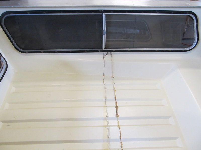

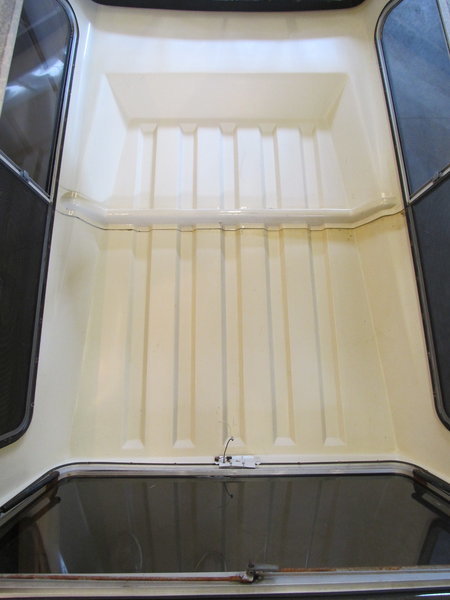

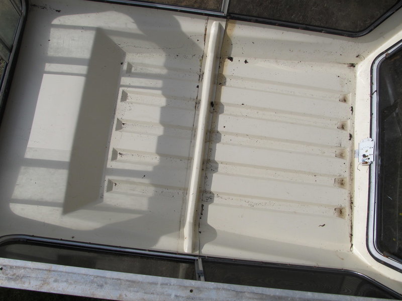

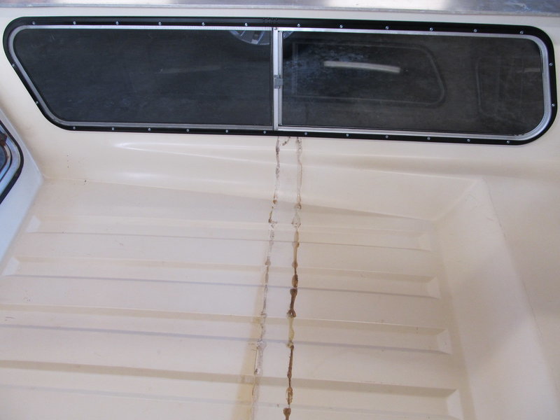

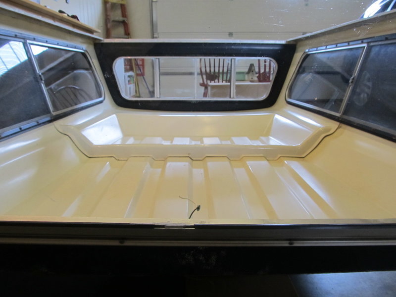

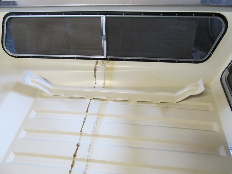

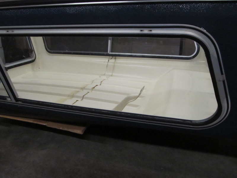

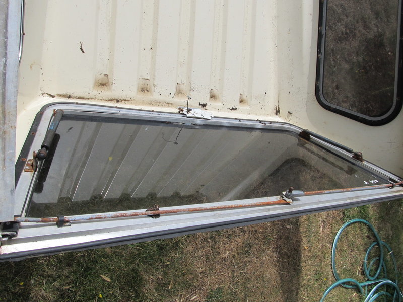

    I got the windows & inside as clean as it's going to be and reset the center brace, but haven't epoxied it in(I might want to make a duplicate for strength). Finding new window molding will be the biggest challenge, t-bar handle lock & locking rods are pretty easy to source online. I don't want to get too carried away with the project just yet, seeing as I have no suitable truck to put this on... I pulled off the rubber seal off of one window and just found some crud underneath, but the aluminum frame is in nice shape., just needs a good cleaning. The side rubber window seals are in good shape, but they have shrunk over the last 30 or so years and obviously during it's former service from the random caulking spots...

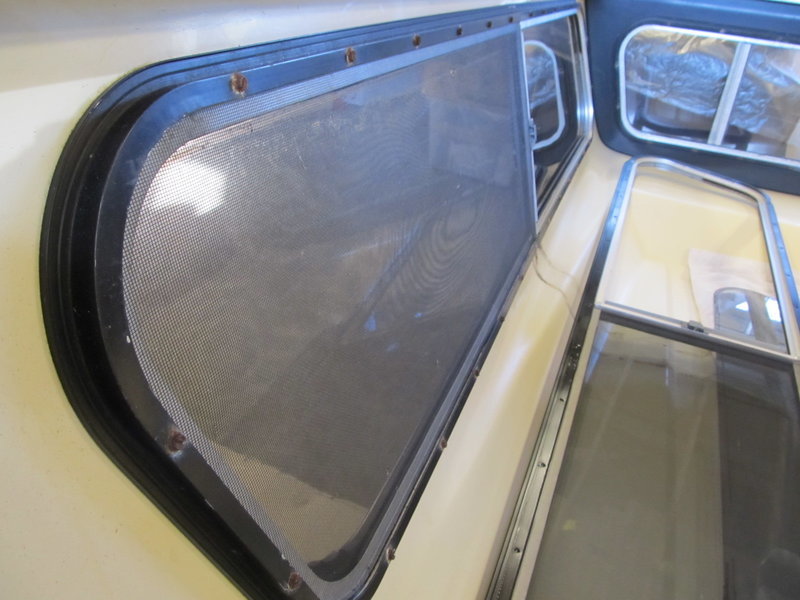

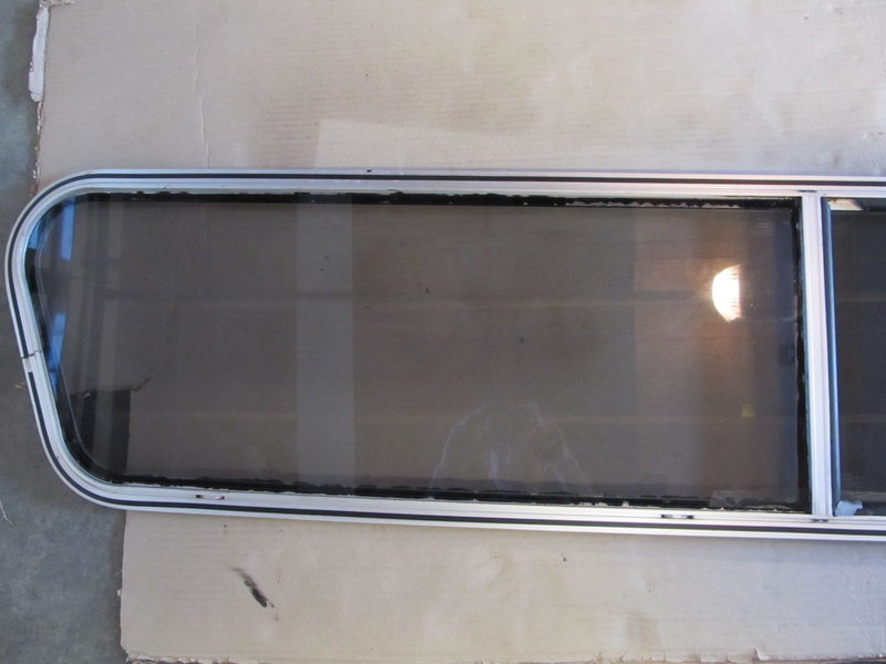

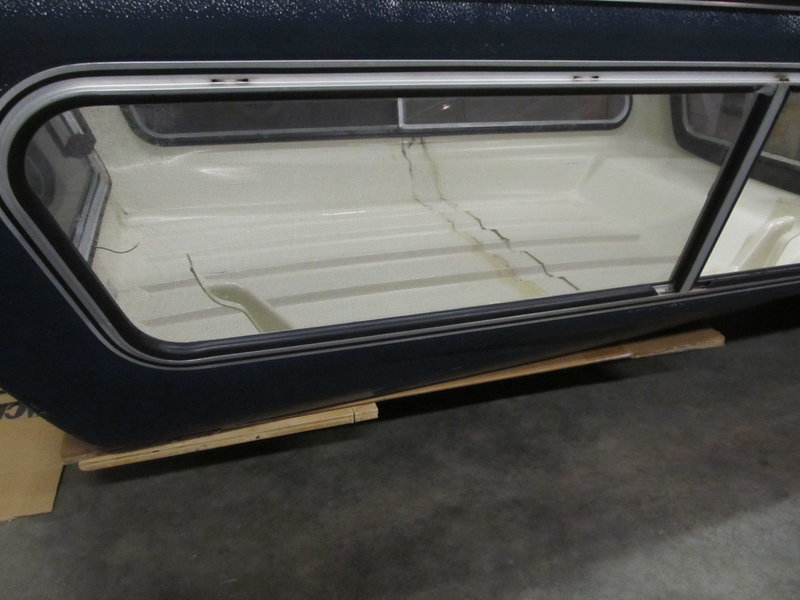

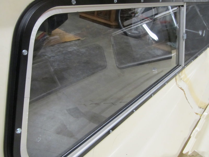

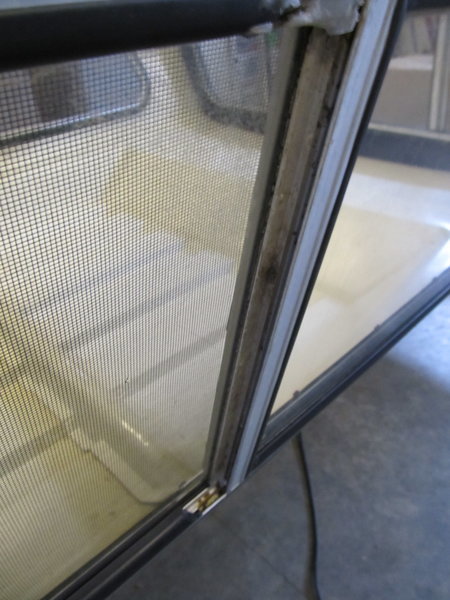

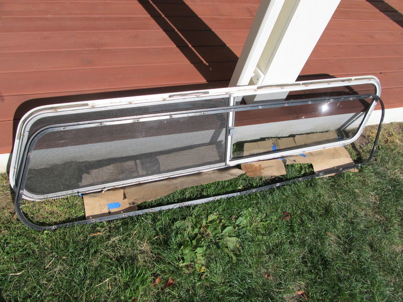

    Been pretty busy lately, but I decided to get bold and redo the left side window, while the carpets were being cleaned. I'm now in for a total of $28 in materials...
    Removed all the old rusty screws and cleaned the surfaces...
    Took some steel wool to the frame just to clean it up a bit. Glass started to come unsealed, so I had to redo it. Re-gooped, kinda sloppy, but it was my first time doing so and it cleaned up for the most part...
    For contrast, unfinished side... Finished

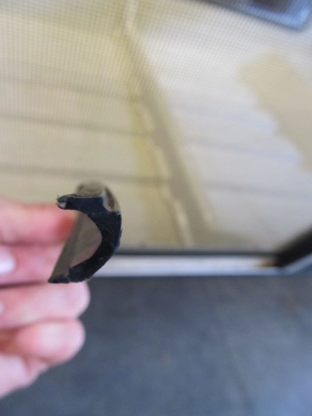

    Re-fitted the outer window rubbers after a good cleaning and warming in the sun. Still short, but at least the corners look somewhat nicer.
    More contrast- undone... done...

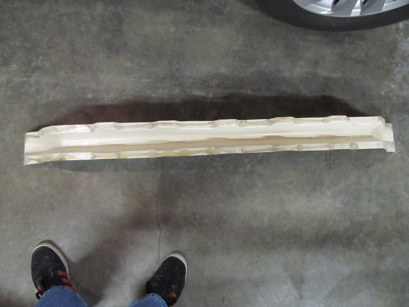

    Cleaning up the brace. Before & after...

    Got both sides completed, same process for both. I'll install the brace at the end of the restoration. Some of the screws for the frames aren't quite anchoring, so I'll get some wider ones or marine goop them in, and wait before permanently setting the brace in epoxy.
    Before & after...

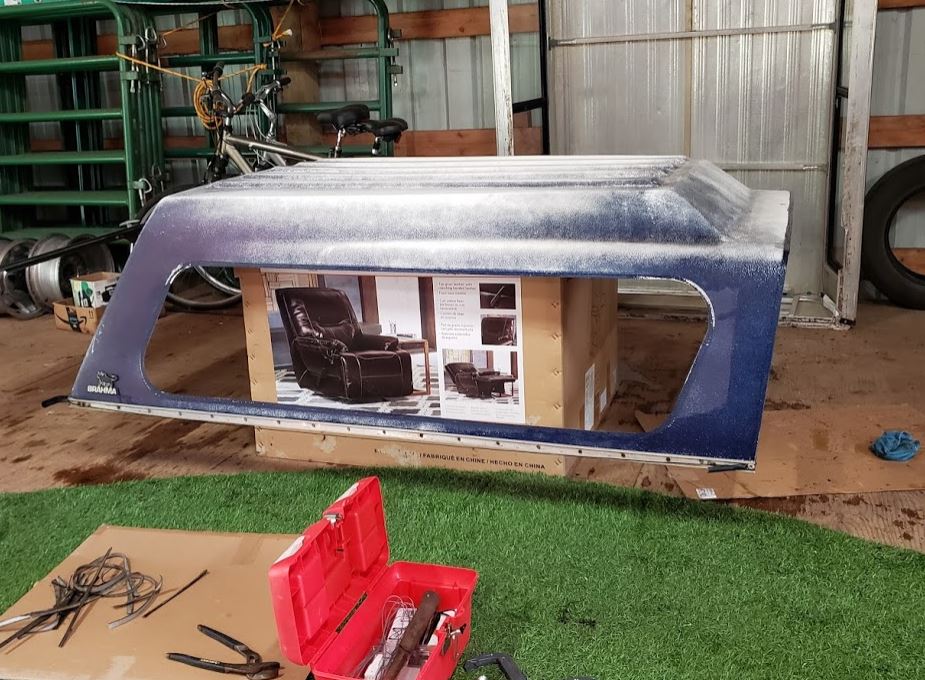

    Ha! Fast forward 4 years and I am in the same place as Navelfunk, the OP. In fact it is an identical blue Brahma canopy, which fits my 1989 Toyota SR5 4X4 Standard bed pretty nicely. It was 3/4" short, so I added an aluminum flange on the front enough to cover the edge of the bed. I could have schooched it up perfectly flush, but the rear hatch would not lock.
    Mine is in the process of being painted "Smoke Grey" with a quart of Rustoleum Oil Enamel and a 4" foam roller.
    Somebody was nice enough to post it on Craigslist, but I had quite a drive to go get it.
