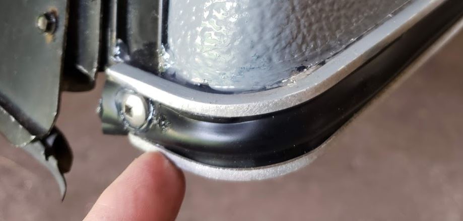

    Those screws drive in between two grooves of the outside aluminum frame. That groove can become widened by wear and tear. Get some vice-grips set up right and correct that gap, then they will screw in like new. I used new screws too, but painted mine black as I have black anodized trim on my side windows.

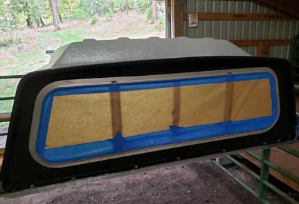

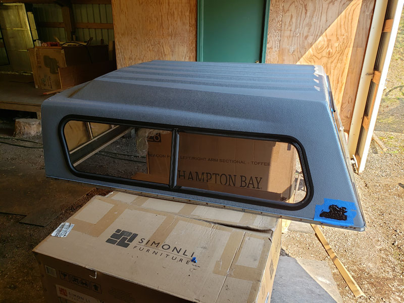

    Progress! Three coats of "Smoke Grey" oil based gloss Rustoleum seemed like enough.
    I used the peel and stick tar like sealer they use on house windows. I would not use this again, but it was inexpensive and I believe it will be effective. It was messy, but cleans up with paint thinner. Next time I would just use clear silicone caulk.
    Two base coats of gloss black on the emblem, then I'll roll a coat of grey over the high spots.

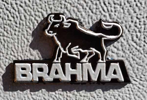

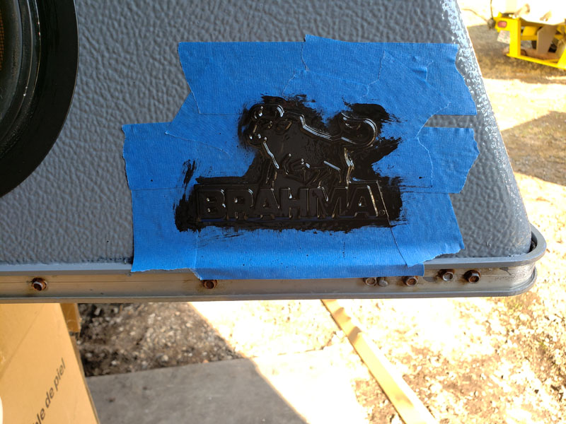

    The Brahma Logo: Tape around him on the canopy, paint him (black in my case), then roll a contrasting paint on with a 4" foam roller. Touch up with an artist's brush afterwards, if you want to. I know - it's way not perfect, but way good enough for me.

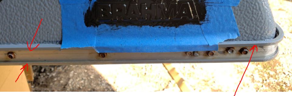

    Some finish details that might be helpful to someone:
    This is the extruded aluminum trim piece at the bottom, I just painted over it because I really wanted to cover the joint between it and the body, and then I sanded it with my random orbital sander to expose fresh aluminum trim.

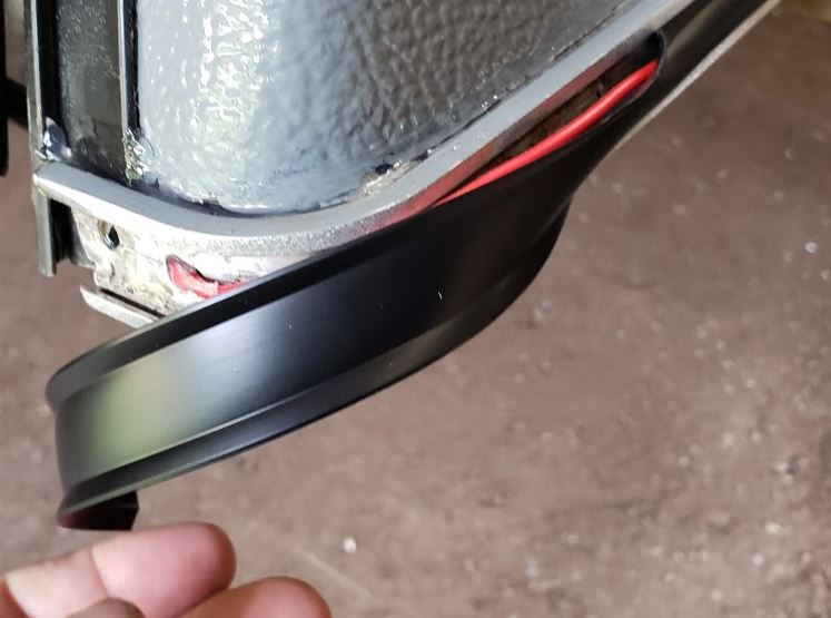

    Here is the trim being stuffed into the channel.
    Note that there is the wire for the rear interior light hidden under this passenger side channel.
    The trim gets a stainless steel screw coated with silicone caulk at the start and end of each side. This replaces a large rivet, and structurally holds the entire corner together.
    That radius corner trim got re-worked and it fits better than shown here, but even still, not great because it's a cheap lightweight product.

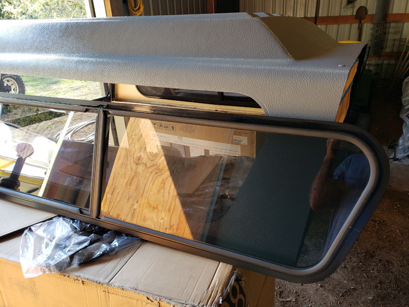

    Some final touches easily overlooked: Why is the front cap painted flat black?
    Because you don't want it reflecting in your rear-view mirror.
    But, on mine at least, they used the cheap unfinished aluminum trim on the cap window which will reflect distracting light - so here it is ready to also be painted flat black. (Rustoleum Spray Enamel)

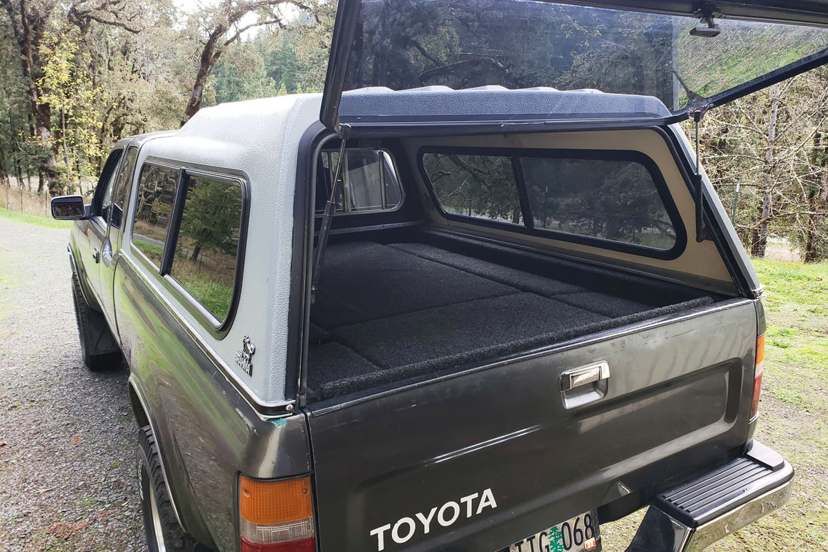

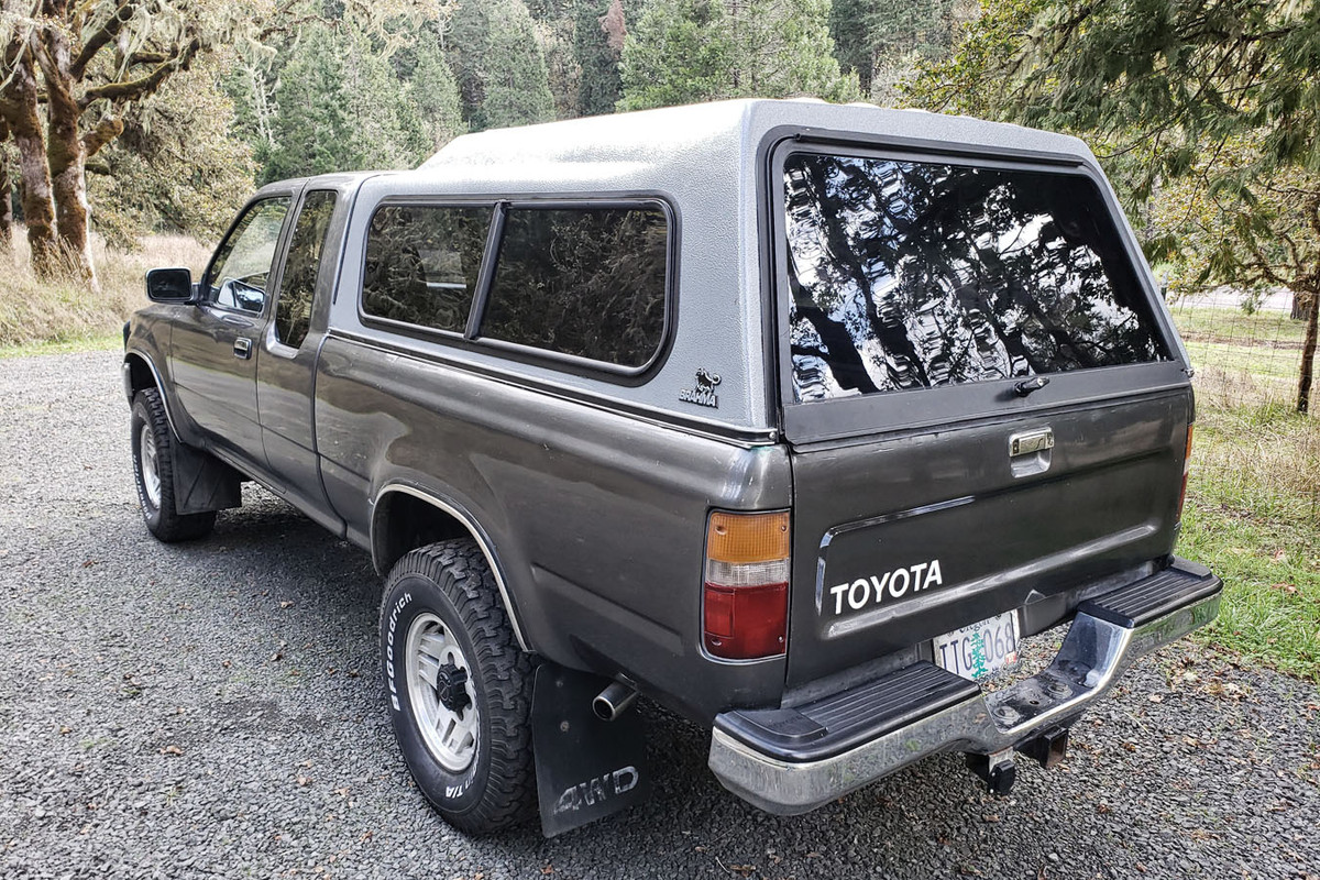

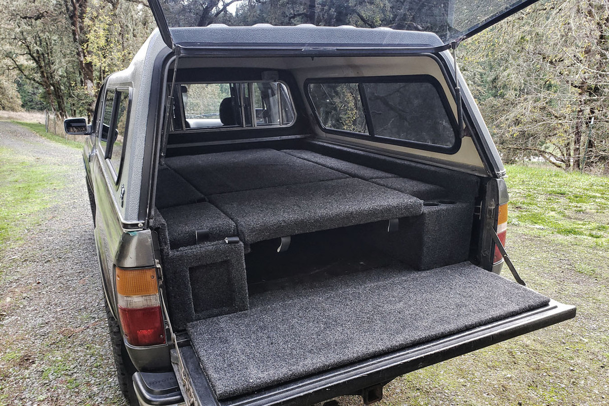

    Ok, here it is finished. Is it perfect - no, not even close!
    No one should start a thread and then deny you the courtesy of allowing you to know how their pet project turned out, so here's how mine turned out. It's "OK".
    If I had only added some black to the "Smoke Grey" color I could have easily come closer to color matching, but I overlooked that.
    New screens were easy to do. I added in the carpet kit in for a more finished look.
    I absolutely would have, should have, spent the extra money for a carpeted headliner - I found out the fabric is very inexpensive and you can use spray on or roll on adhesive. It is easiest to work it in with all the windows out. I still may, because it only takes an hour or so to take all the windows out. We'll see.
    I have two lights mounted and wired but not connected yet. One aft and one forward.
    I did not add the center support back in. I'd rather have the headroom and I just never could see it actually helping supporting the roof anyway.
    This canopy has the double slider as does this SR5 model pickup, so that was a happy "win".
    If you don't know much about these "carpet kits" they install in about 5 minutes, and without any hardware or tools. There's a back wall, the two sidewalls with three access latches each, and the two middle pieces that create a sleeping platform. Oh, and the tailgate piece. In the above photo you can also see a sliding door on the left (it just lifts up) for longer stuff, and cup holders on the right.
    Just a shot of in the middle latch, which of course is largely taken up by the wheel well.
    In hindsight, I'd say I made some pretty junior mistakes, but it will still suit my needs along with my 31 year old ranch truck.
    Thanks for riding along.

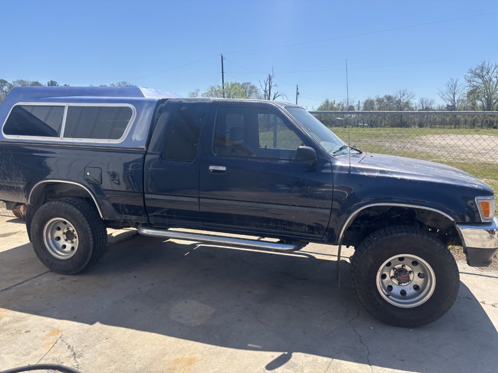

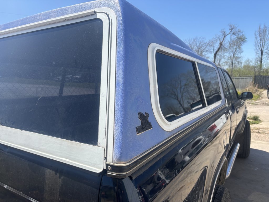

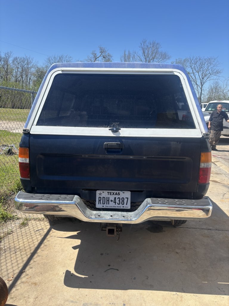

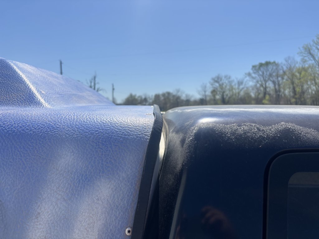

    Man I appreciate the post! Found a Brahma 76”x60” on marketplace for $100, no cracks. They fit like a glove. T-handle replacement was not a match so took a while to craft something up but it works. Will likely strip the entire camper down the road but it’ll work for now.
