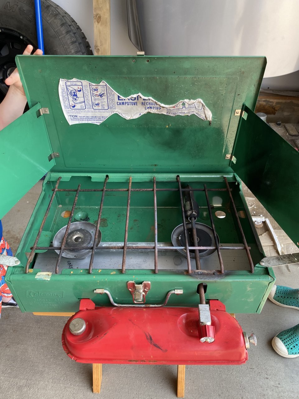

    Hi there, just came across this stove for sale locally. Seller is unsure if it works, he has no fuel to test.
    Im just wondering if anyone has any experience with these stoves? thanks

    That actually looks in decent shape

    Most likely the only thing needed is to oil the pump bellow.

    The leather needs to be oiled, hoping it’ll fire up!

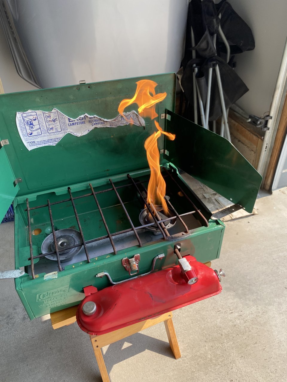

    I might do that. Seems to build and hold pressure ok. All I get is orange flame though and not the nice blue, noticed a leak from the dial area especially when I went to turn it off. Would not turn off at all. Any ideas?

    Do you have it pumped up to pressure?
    When you have good pressure, it is pretty noticable on the resistance amount to push in the plunger.

    Turn the brass valve UP to light, once it’s heated up for a couple minutes turn the valve DOWN, turn it up to max and give it 30 pumps. Soon it will be warmed up and blasting a blue flame.

    It has to heat up the copper generator pipe enough to vaporize the fuel inside. They take a bit of fiddling but once you get the hang of it it’s easy and they roar.

    I just went through and cleaned up one of these a few months back! It was actually in worse shape than yours. DM me if you have any specific questions. Mine works great!
    The large flame is normal until the pipe heats up. Then it'll superheat the fuel causing it to vaporize so it'll burn properly when it hits the flame.
    Also it "turns off" delayed. Just wait for the fuel in the line to finish burning off. It can take a minute or so. Completely normal.
