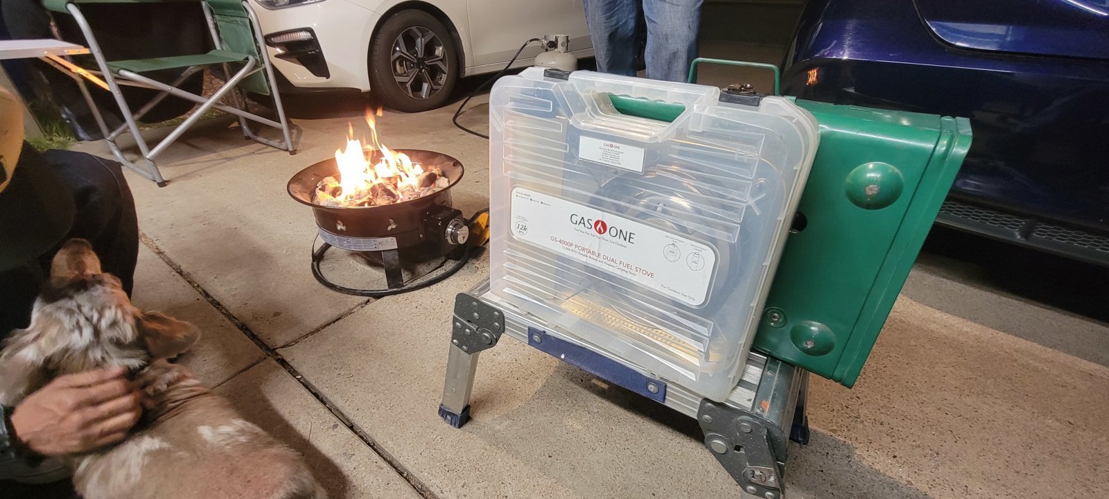

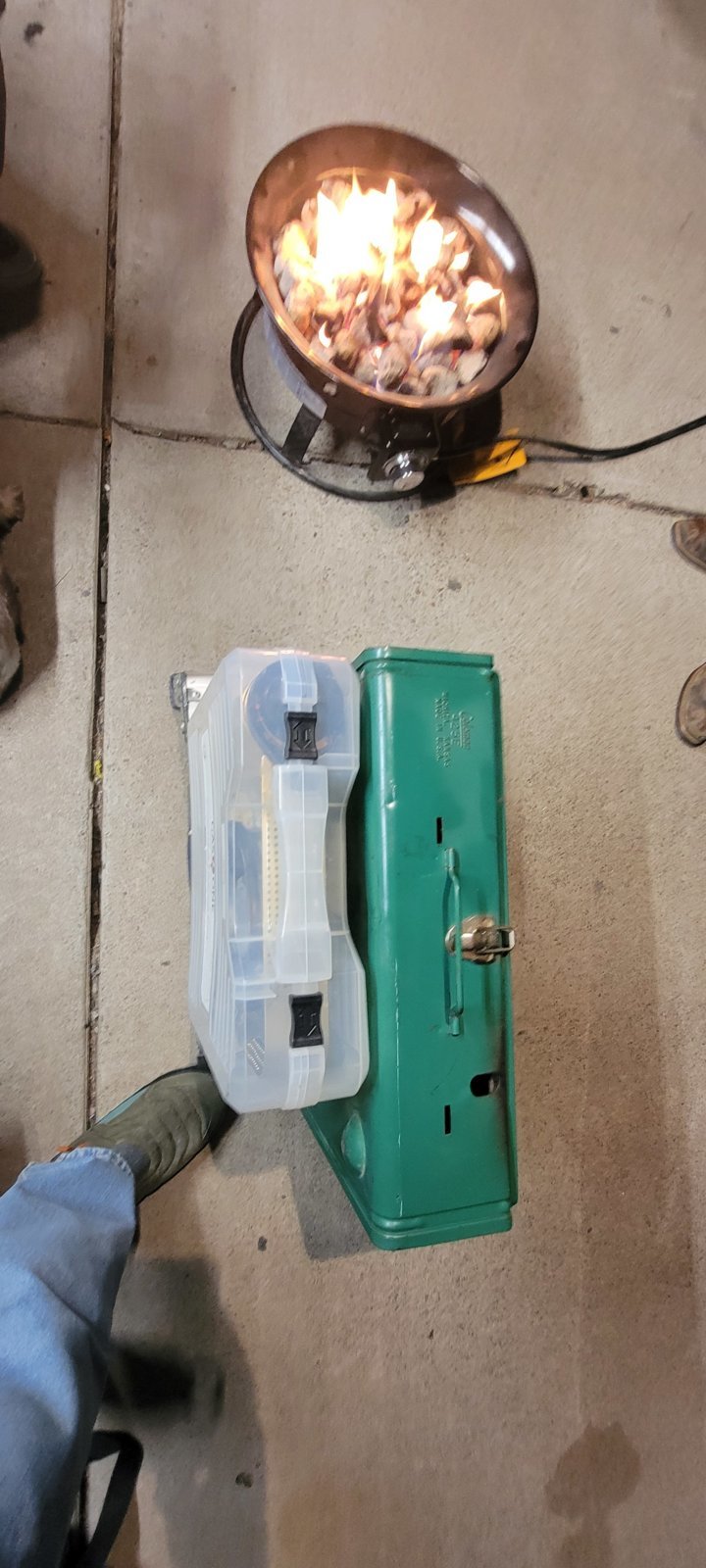

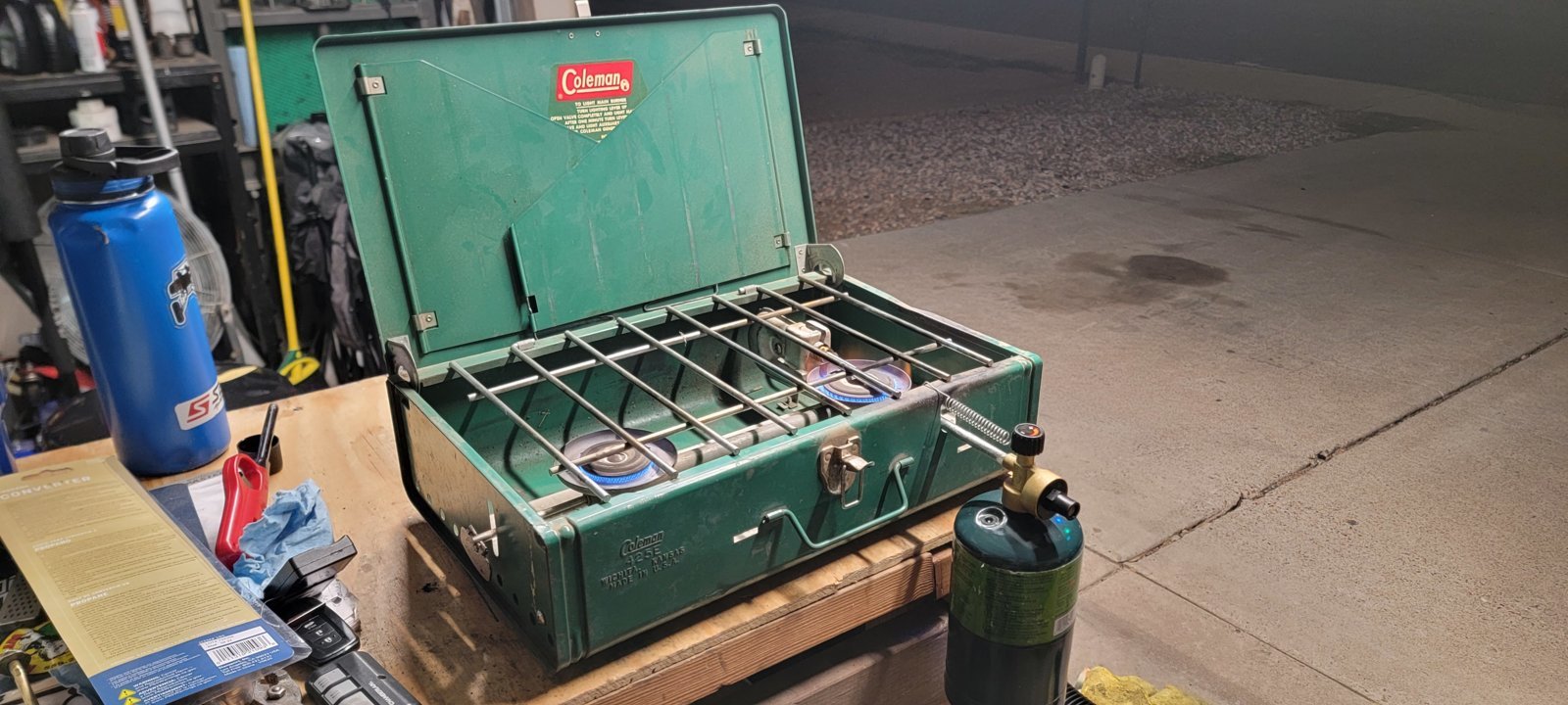

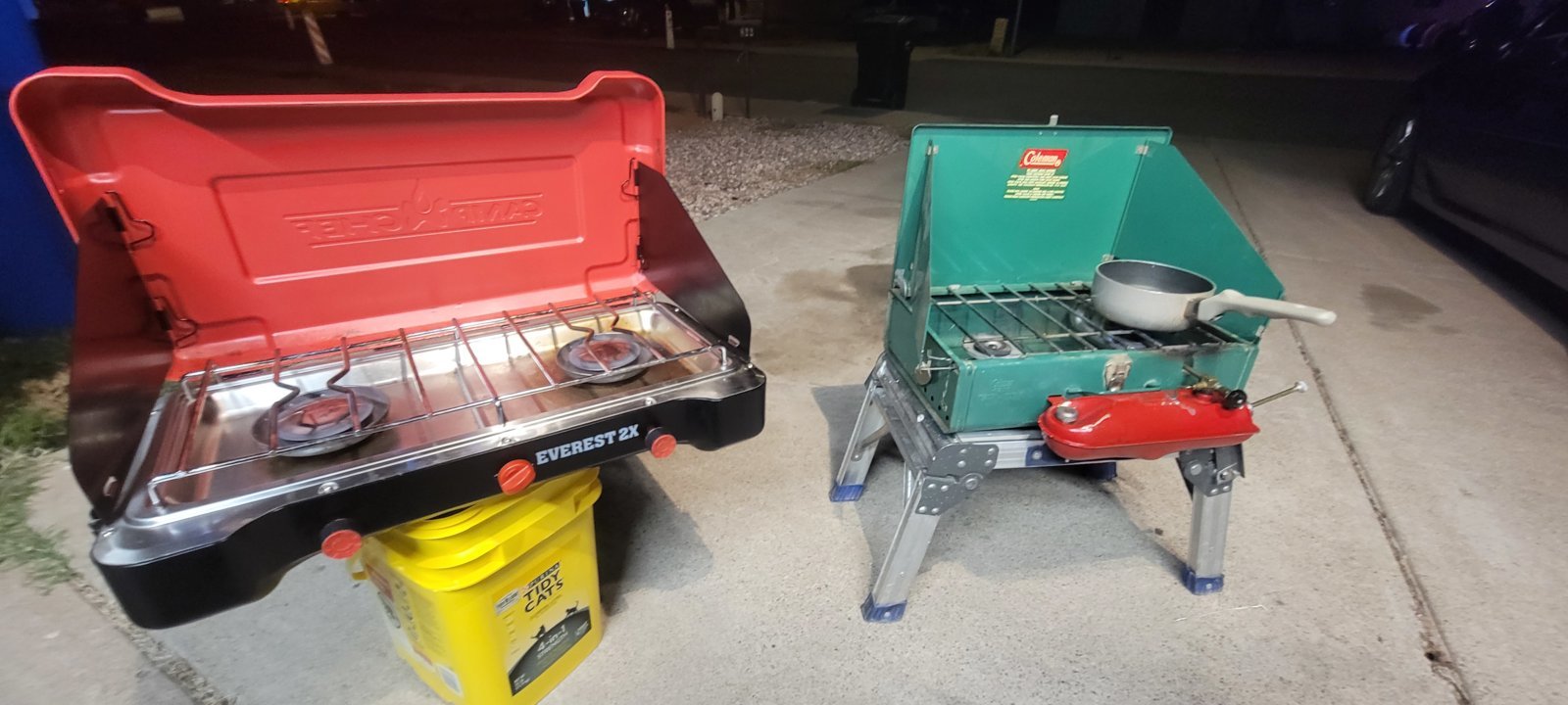

    I'm gonna revive this old ass thread opposed to making a new one.

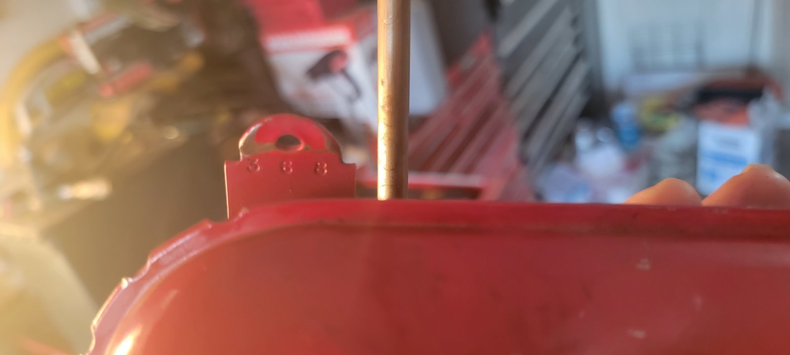

    I've been geeking out on my stove for the last week or so though I'd share. I bought this stove a couple of years ago and was unable to get it going . I was going to give it to a neighbor who had a similar one, but turned it down. So I decided to make an actual effort on getting it going. After a bit of internet research and a couple of youtube videos I had it up and going. It mainly involved replacing the lether pump cup and cleaning out the check valve. I'm going to take the burners apart and give them a good cleaning along with the rest of the stove. But all in all I'm super happy to get it going. I bought a propane conversation for it too just for the added flexibility and convenience. It all still packs nicely into the stove during transport.
    It was made in March of 1968. It's a 425e which was the smaller version at the time.

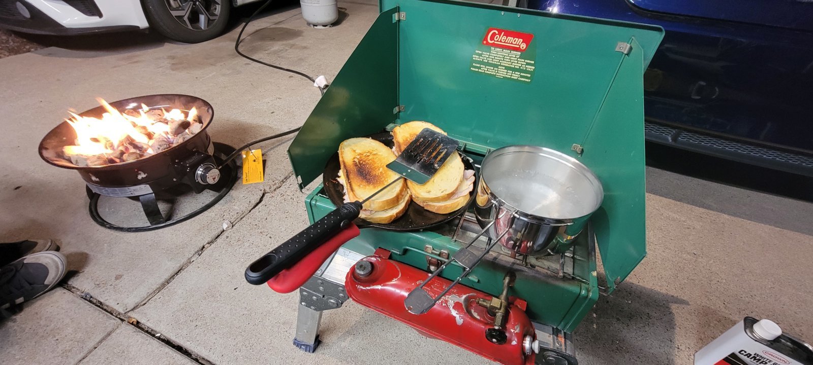

    Propane conversation.
    All packed up.
    Dinner

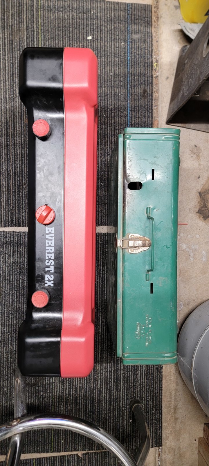

    Some size comparisons.
    Camp cheif everest 2x
    Next to a gas one 400p duel fule.
    It's been fun to bring an old tool back to life. I have a couple more things to do to make it just right .
    Hope you enjoyed and the OP dosent mind that I tagged along on there tread maybe we can use this for others to show off there old colmans or similar stoves.

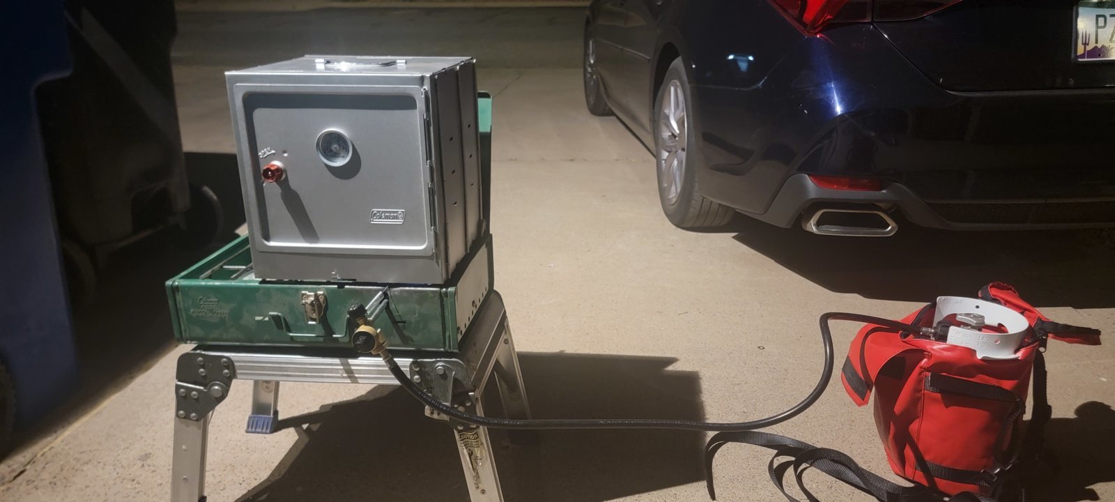

    Though I'd update this a bit.

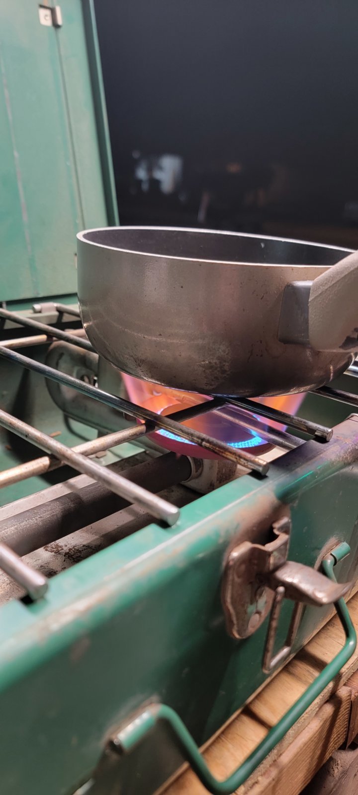

    I ended up cleaning the burners and what not. I think I need to rebuild or replace the fule controller. Because it's just not holding pressure like it should. I can cook with the white gas but I have to be mindful and give it a few pumps here and there.
    I did buy a folding colman oven to go with my kit. I cut the handel off a cheep cast iron skillet to use as a heat sink/defuser, which also helps to fit it in my cooking bag.
    I've been playing with it at home to figure out how long to cook and what temperatures I can reach. I was able to get a consent 325. Which extends the baking time by about 5 minutes. It took about 1/2 a hour to reach that temp buy just using a lower flame.
    So far I've made some cookies,brownies and reheated some cinnamon rolls. The brownies and rolls came out great with only a small strip of the bottom being burnt,but the rest was perfect. The cookies didn't fair as well . In my defense it was my first time using it and I may have been a bit inebriated. So far I've used the stove with the propane for about 3 hours and I'm 1/2 way through the green area on the gauge. I'm guessing that's probably a little more than a quarter of a tank.
    The stove doesn't fit perfectly over the flame on my smaller stove but it pack down to about 2"thick and the size of the face wich is like 11" ish. So far it's been fun and it will be nice fo make some treats on longer trips. I'm glad to get some practice in with the setup while at home instead of ruining something at camp or worse running out of fuel.

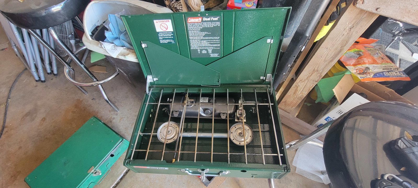

    I got a new to me slightly larger 414 dule fuel stove. Hopefully I have a chance to try it out today. I was bummed when I found out I had bought the larger version. But I got a heck of a deal,its practically brand new and can run pump gas also. My understanding is that the others can too but they tend to gunk up the generator tube .
