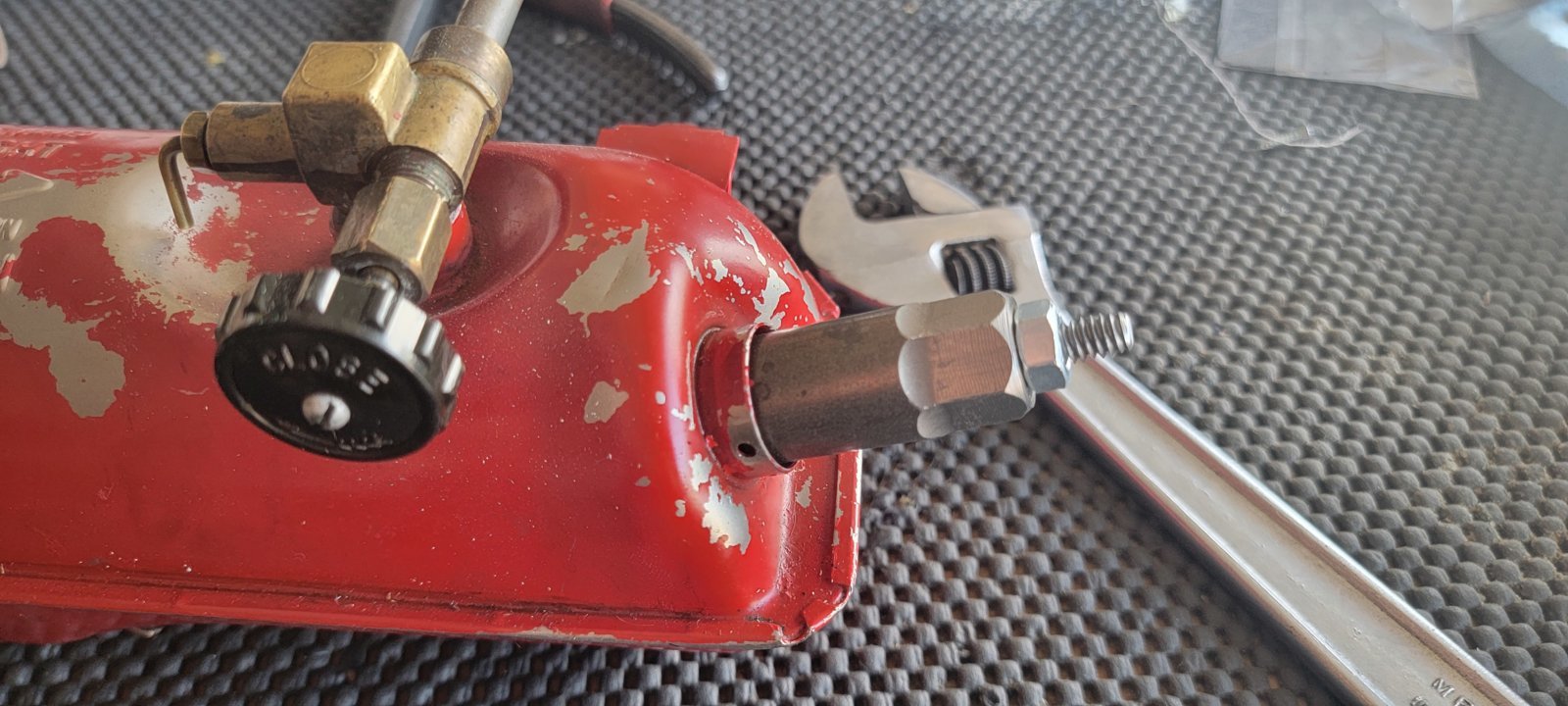

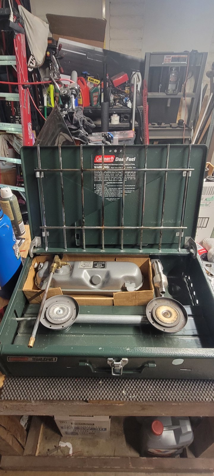

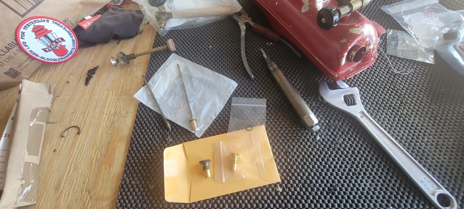

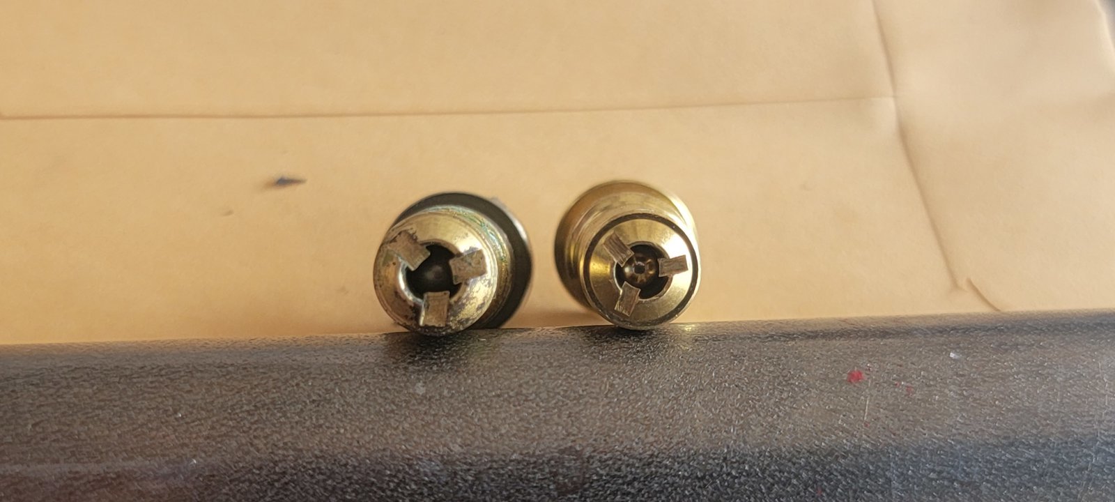

    I picked up some parts to fix my older stove, I feel like I just wasn't holding pressure like it's supposed to. Luckily there still parts available,and there's some comutys of people out there still refurbishing and collecting them.
    I ended up running into a issue afterwards that was remedied buy expanding my leather pump cup.
    I found a lightly ussed 424 for cheap. A little oil on the pump and it worked like a champ. This is probably the one I'll use for camping as it can run multiple fuels, my propane conversation fits just fine. I have a buyer for the larger one so it worked out in the end. Here's some pics of the new one 424 and a comparison to the larger 414.
