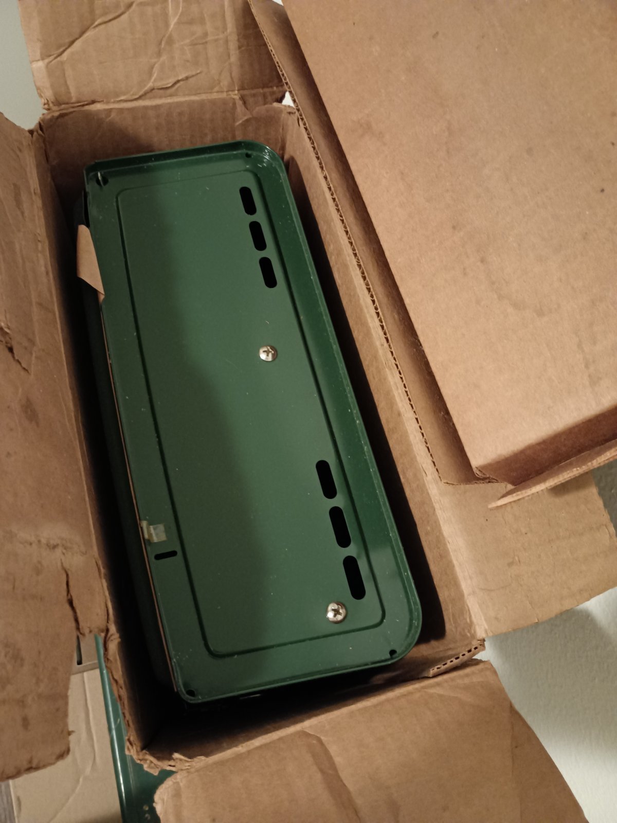

    I have the same one still in original box, it belonged to my father, but he never used either, nor I have used either
    Also have 2 kerosene lanterns, but I can't find the tops with the nut and glass
