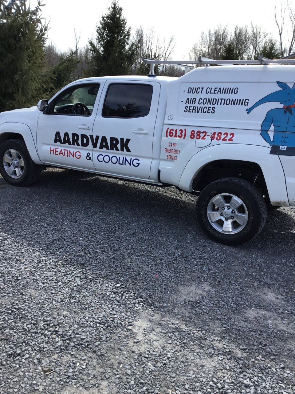

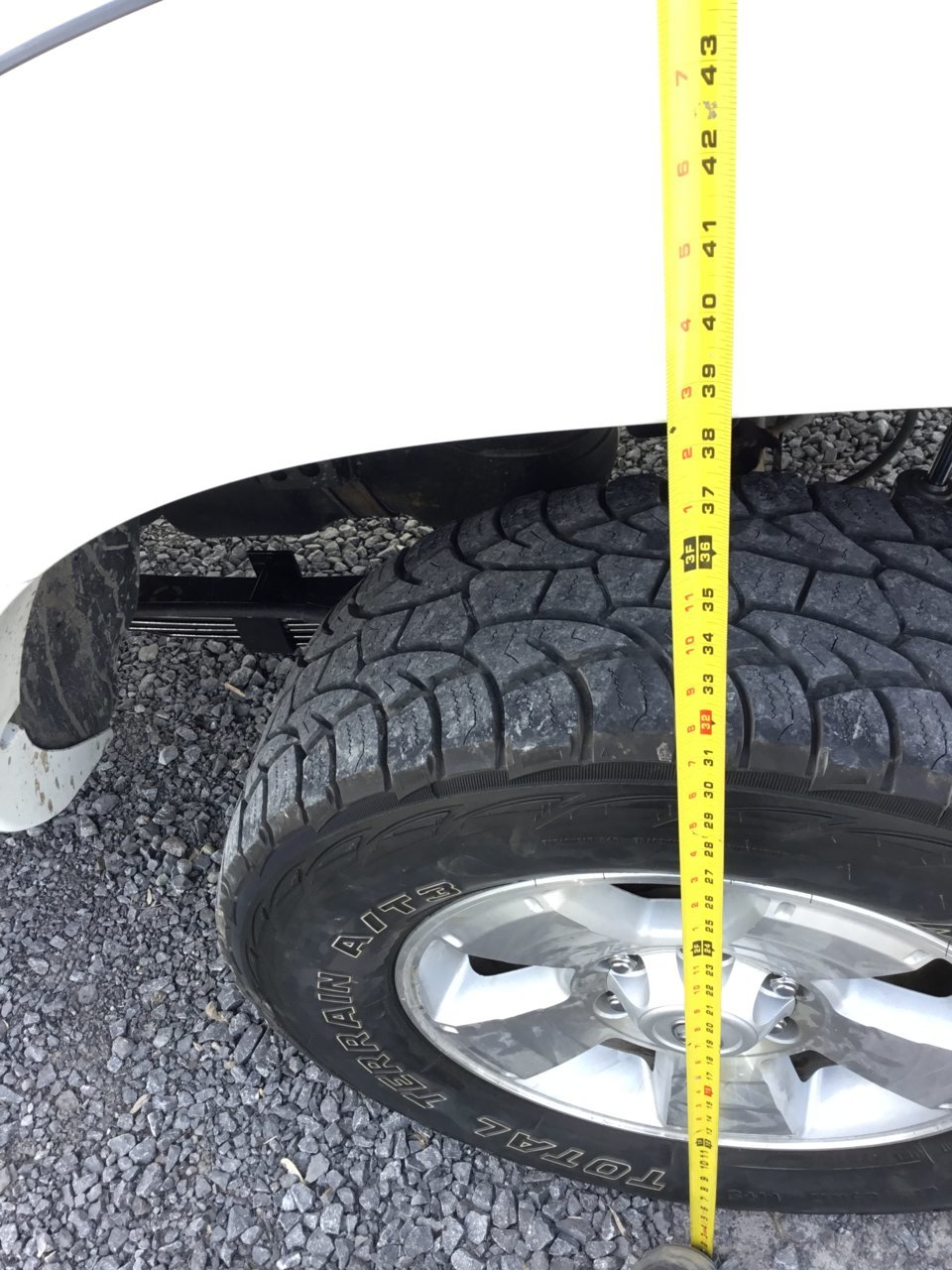

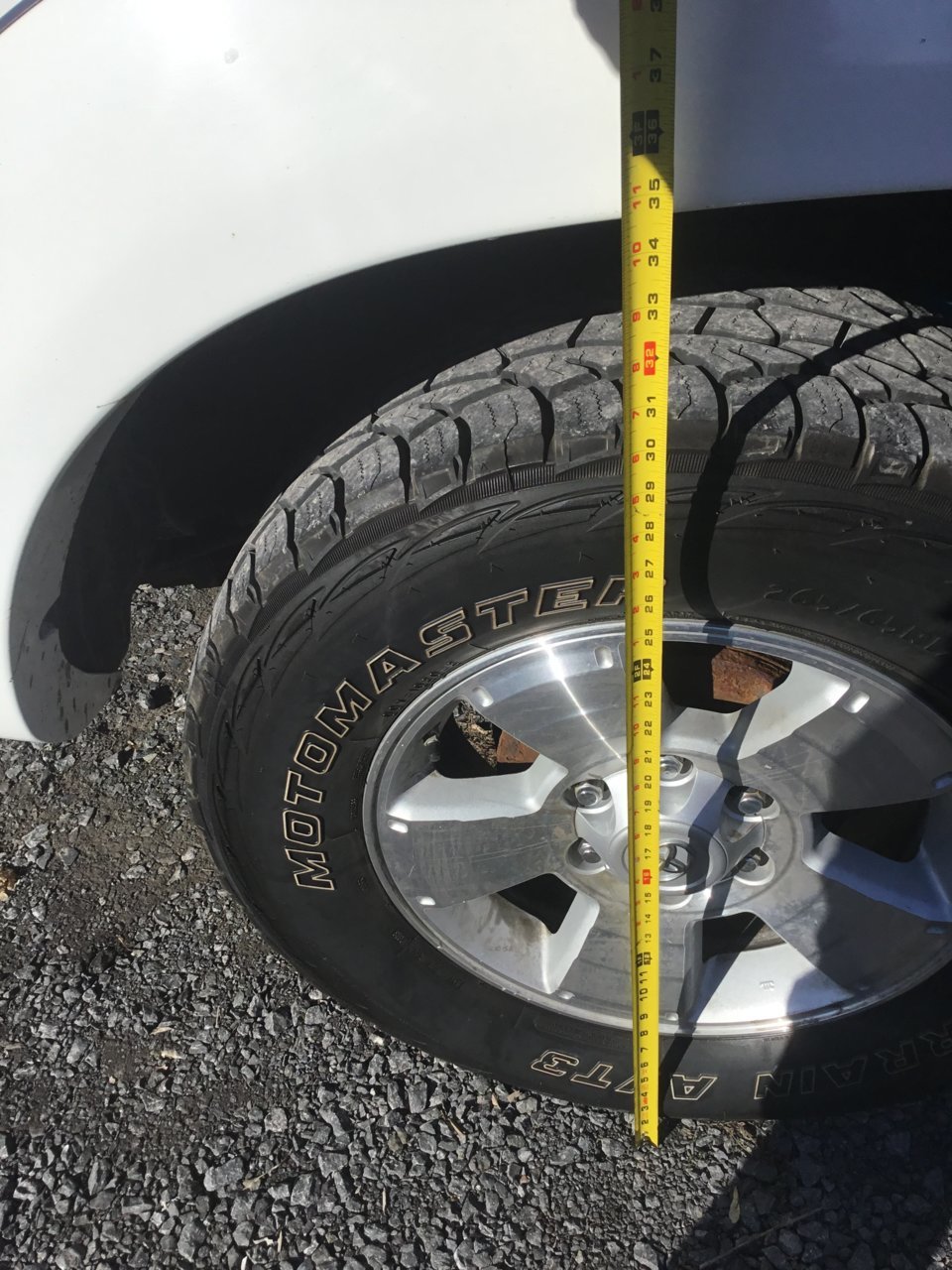

    I just installed ew leafs on the truck and Wow it went up!
    I guess my old springs were so stressed I got almost 4”
    977C81D2-2512-4478-8D0D-4B910A4F80F8.jpg 80F60C84-4BEB-4E35-AB03-78CF01233C9E.jpg

    Now I think I need new front struts lol20D14B00-DED5-453B-915A-2B4751A141EB.jpg
    So I ordered 2 EL096R leafs, 2 packs of OMESB108 bushings and 2 OMEU53A longer U bolts oh ya and I installed new shocks which bought from a guy on Kijiji which are Rough country 2 “ lift
