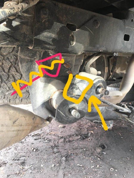

    An inch and a half isn't terrible. What's your gas tank filled to currently. I'll try to find picks of what I'm talking about with the shackles. But I'm guessing they're fine

    Just check to make sure that the flat part is facing the rear

    Flat part is facing the rear on both sides. Will try pushing the shackle forward on driver side a hair. I really appreciate your help
