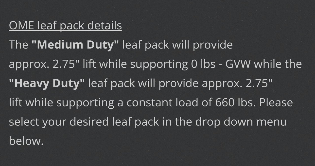

    Your truck sits perfect (imo). I have the same truck, only a 4cyl. Did you have to get longer brake lines, a diff drop, CB, UCA's, etc? I'm looking @ doing this lift/tire size also, just having trouble figuring out what will work for the lighter 4 cyl. Sry, I know this is an old post. Thx!

    I'm also looking @ the same thing. This is from Headstrong.com's website.

    Here is what mine looked like with 884 and an AAL, 265/75. With your cap and AC I think 884s and light duty dakars would get you there.
