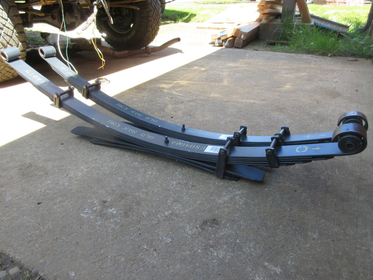

    I just currently had Old Man EMU leaf packs installed on my 2003 Toyota Tacoma sr5 4x4. I’ve been told that they were installed incorrectly cause the (+) was on passenger side and the (0) was on drivers side. Are they installed incorrectly?

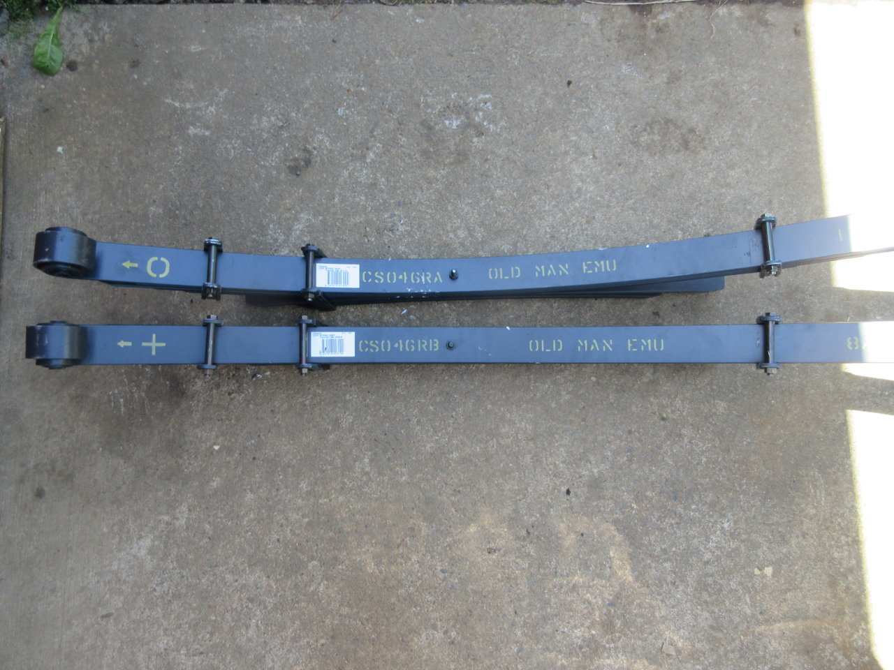

    As mentioned, + is supposed to be on the driver side due to the added weight however, the leaf pack is supposed to be side specific (noted by the letters at the end).
    I went ahead and ignored the + and o and instead put them on their respective side; can't tell if I have lean.
    If it bothers you, switch them out. Easy job.

    To my knowledge +, 0, and - are OME quality control marks. + is a bit stiffer or taller than specified, 0 would be right on, and - is a bit low, but all within acceptable ranges.
    The springs are still side specific. For example the “A” or drivers side, with a - should still be on the drivers side even if the passenger is +.
    if your truck has a tiny lean, move your gear to the passenger side of the bed. Also make sure you measure on a totally level area. My driveway creates a lean just because the driver side is downhill a tiny bit. On a level surface it’s closer. I don’t care if it’s perfect

    Look at the part numbers, not the + or -

    + = slightly over spec
    - = slightly under spec
    0 = spec
    Neither + or - is enough out of spec to be considered unusable, driver/passenger can carry any of these indicators, however it is typical for a + to be used for drivers side to help with lean.
    The indicator of which side the pack goes is going to be either an A or a B at the end of the part number.
    A= driver
    B= passenger
