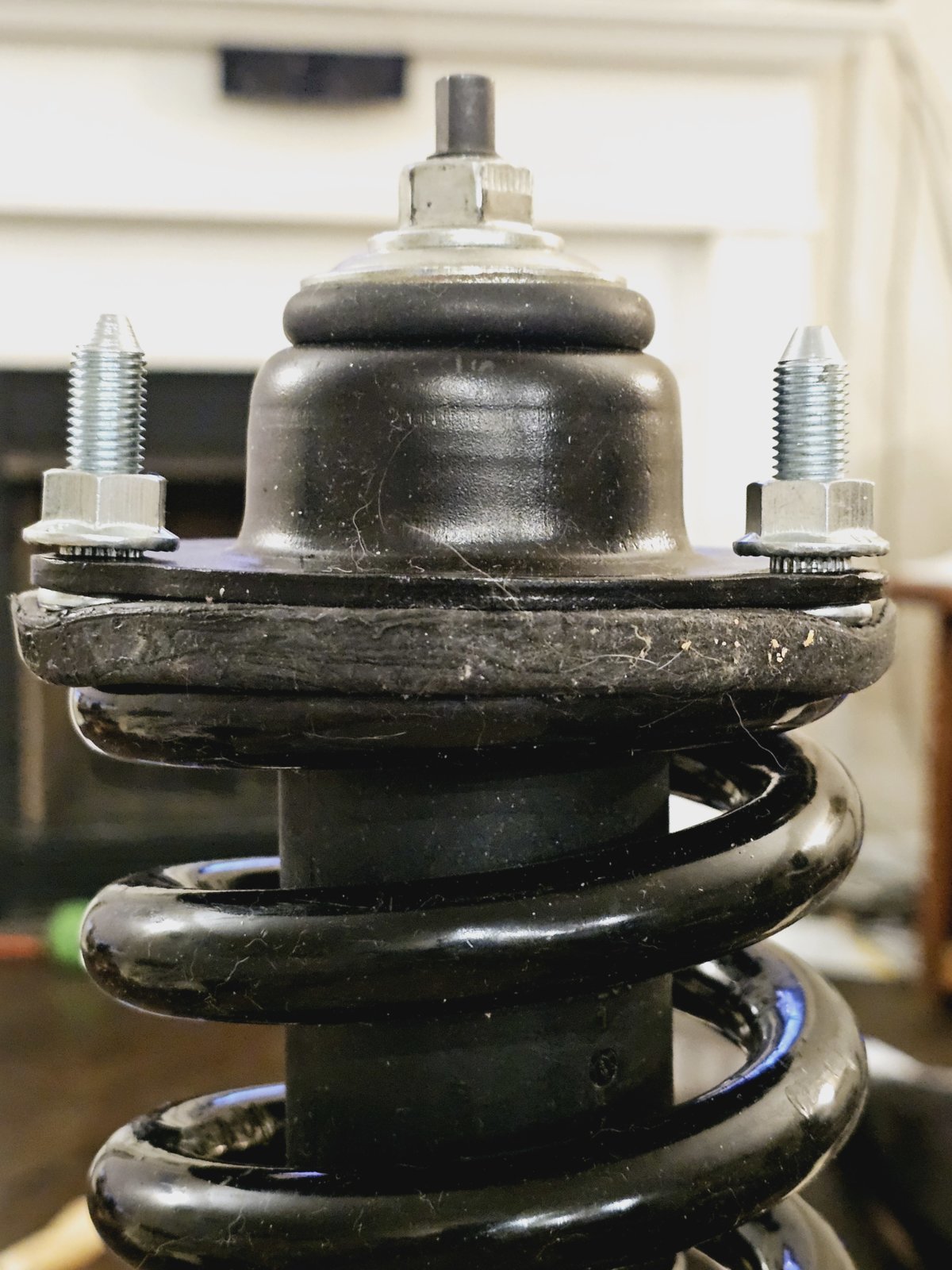

    These front coil overs / shocks just came assembled in the mail. It looks to me like someone went bucknutty on that top bushing nut. Idk if I should loosen it a little? Any advice? Thanks

    Leave it, it's fine.

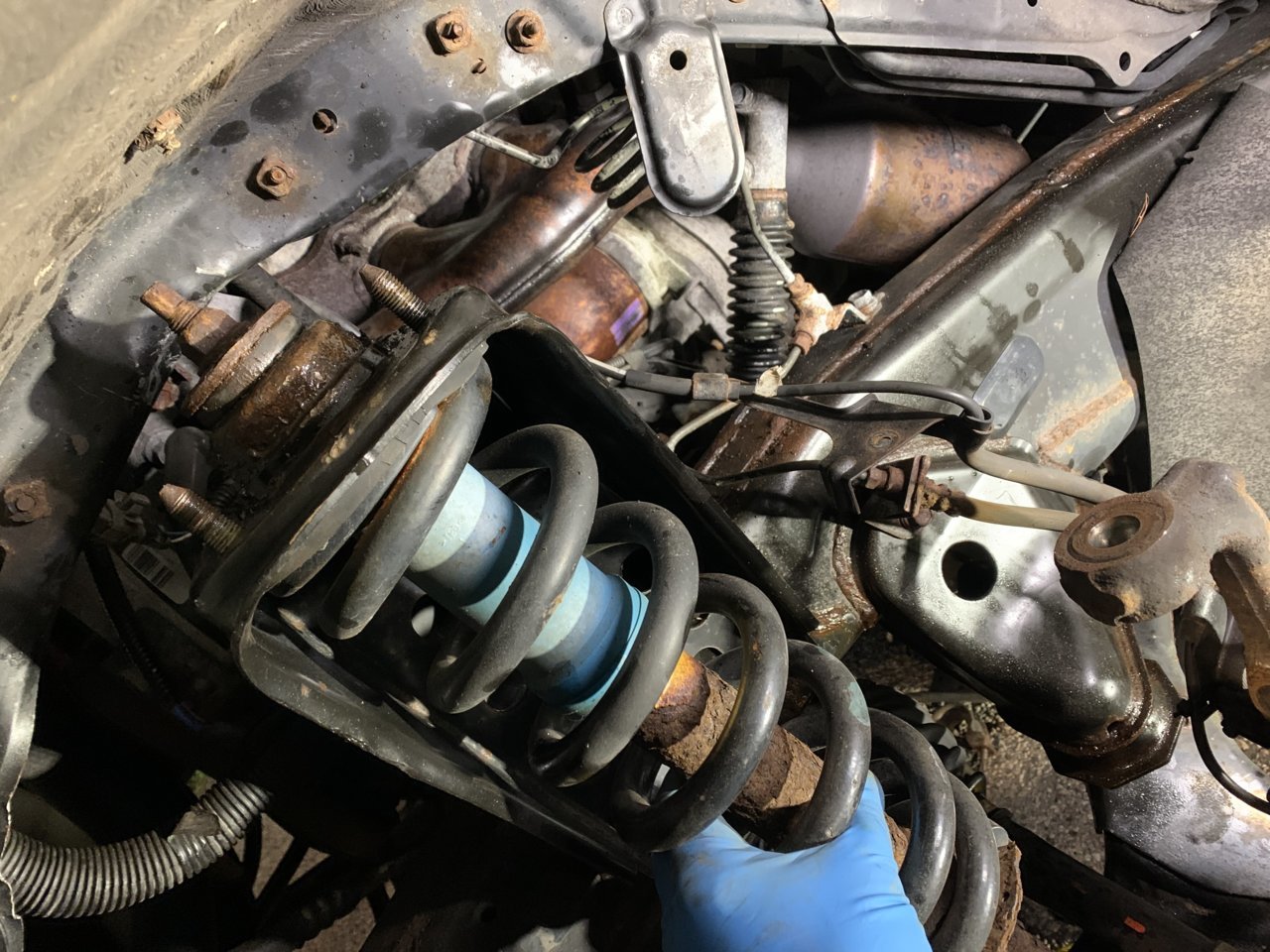

    This one on the driver side is STUCK!! Iv never seen one get stuck like this. Guess I’ll just let it soak in penetrating oil all night & try again tomorrow. It’s especially strange because the frame is only 5 years old

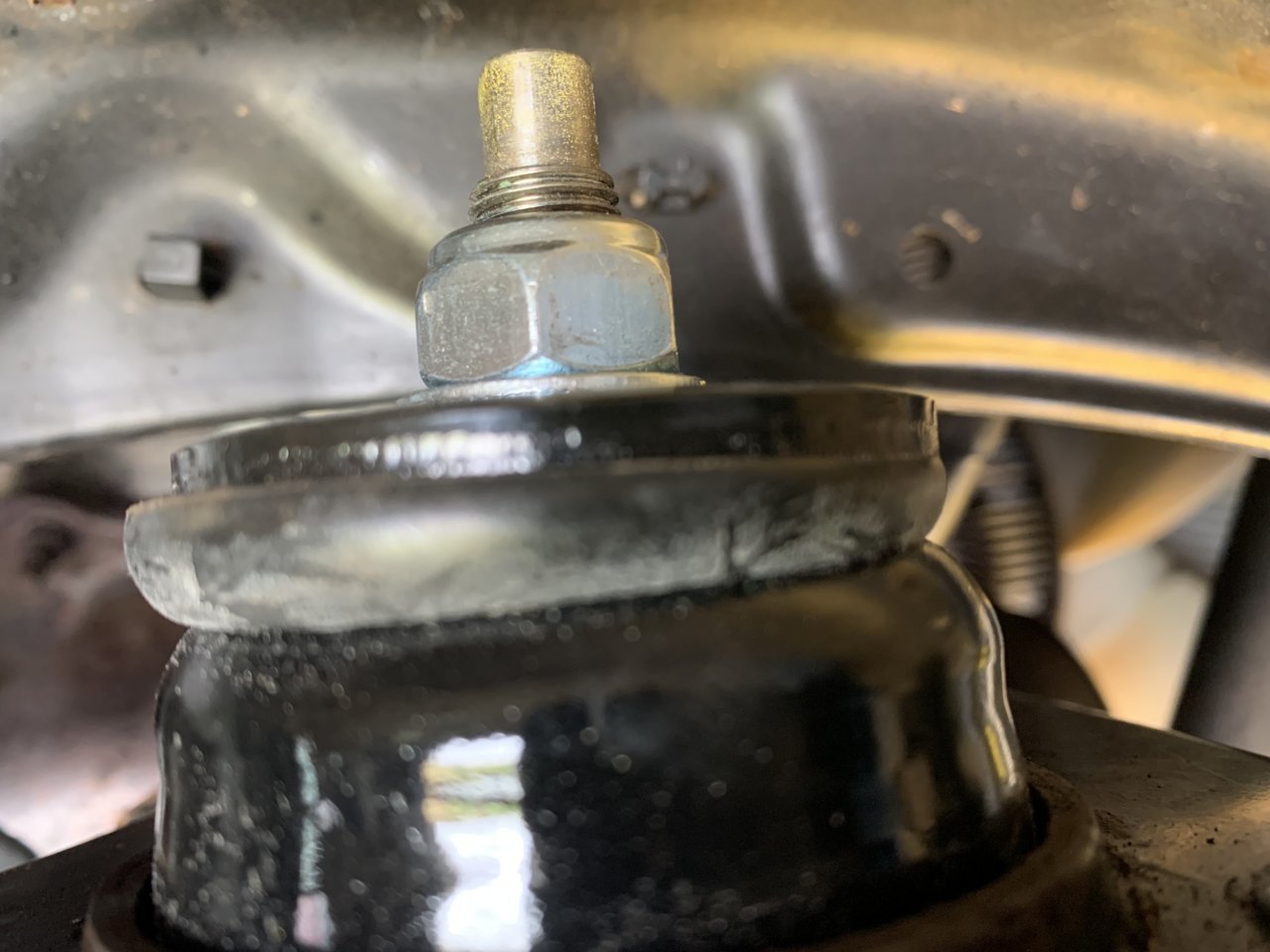

    I tightened mine until top thread shows. Torque is about right, bushing isn't squashed and it helps protect threads from corrosion not exposing them. I bought tools so I don't pay people to screw up what I can for free.

    Try some heat but I think a little spray will be good overnight. Looks rusty but not corroded. I replaced my strut tops with KYB. 3.5-5 lb hammer and a rubber mallet are handy. Can save some cussing. If it's turning on you try to hold the stud head under rubber isolator long enough to spin off with impact or needle nose vise grips. If you weld, spot weld on stud head to strut top on bottom. Impact should do it. Go buy one to try and return it if it does or doesn't work. I didn't see it but was off. If it is, use your rubber mallet first, unbolt bottom strut bolt. I'd use 3.5 lb hammer so one lick should do it.

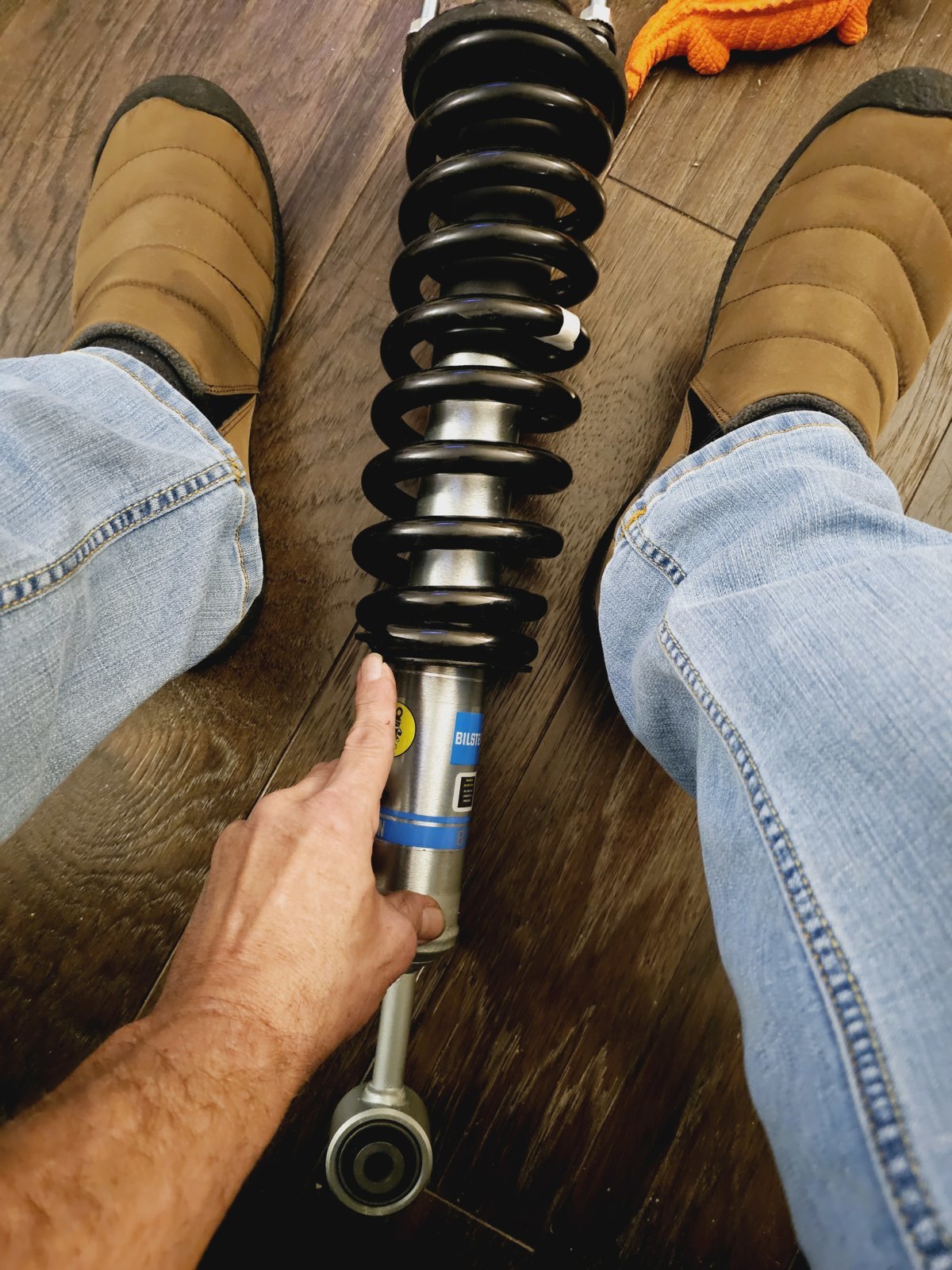

    This is mine after I built them. You need to be sure they are oriented the right way or they probably won't fit. You need to check and make sure spring is facing correct on each side and strut top is aligned, if not you will have to compress and turn them. I bought the tool instead of ordering like that just for that reason. I have mine set up to top height setting and polyurethane isolators and I am looking for 3". These springs were rated 0-3" with many different results from different people on Summit racing online.
