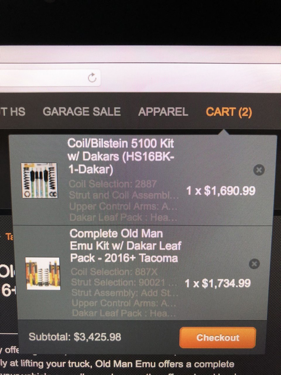

    I have rancho 2.5 inches of lift. But I’m planning on ditching them for one of these. But not sure which would be better for off-road and on road. Any help? Also I seen that these are only 2 inches of lift as it states on the page.. I would like a 3inch.

    Bro, you gotta do your research. Toytec makes all kinds of 3" lifts. You really shouldn't need UCAs with a 2" lift. Although, if you're looking for on road and off road balance the 5100 billys all around set at 0 with 2" OME coilsprings (or eibach) with a HS progressive AAL seems to be the crowd favorite. You also wont have to worry about a front diff drop. Read this...
    https://www.tacomaworld.com/threads/dclb-with-885-springs-5100s-at-0-and-3-leaf-aal.502144/
    Edit: I've heard of people liking the Dakar leaf pack instead of the AAL. In the thread he mentions doing it for around $800. The only thing you need to decide is which coil spring rate you want based on (armor, winch, bumper...girlfriend)

    Well I was mostly looking at ome lifts and not ToyTec since I’ve seen most people use ome. But thanks for the info tho. I’ll will check out that page.
