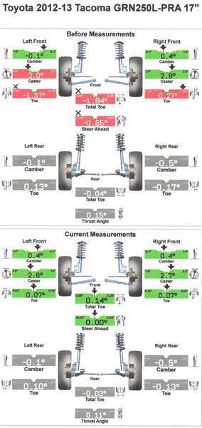

    I didn't pay too close attention to them when I installed....I figured the alignment tech would mess with them anyway. I don't think they did though.

    :spy: lol. Im not the LR uca expert, but i have read just about every thread here on them. I posted in the other thread brad. As far as alignments go there is alot that i don't fully understand, i have been told that your caster numbers should actually be .5* different, maybe to adjust for road crown :notsure:
    But like i said in the other thread, if your toe and camber numbers are good, and caster is in the range you want it then i would just leave them alone. When i got an alignment i don't think they touched the UCAs even though i explained them to the the tech and gave him the install sheet.

    Here's my alignment the day after I put the lift on:

    Thats not bad at all IMO. Perfect would be toe and caster at 0, but if you rotate your tires i doubt you will have uneven wear.

    Agreed. The numbers work. Should wear pretty well.

    Your LR UCA's weren't both set at the neutral position were they ?

    What should they be set at?

    The nuetral position, which adds 2* of caster. The SPC logo on the gold plate should be facing the back of the tire.

    I have the logos facing out so i can read them. I'll double check the position. Seems like a lot of eye balling though, theres no actual markings on the arms.

    No eyeballing, there is a star washer that does not allow the adjustable caster plate to move in small increments. From the nuetral postion you can only go up or down a full degree. If it is not in the neutral position you will be able to tell.
