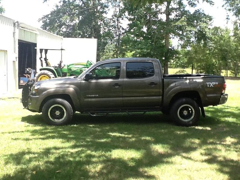

    I recently came across some money and decided to look into a lift. I've been studying this thread, but I can't find an answer to my problem. I am really liking the OME 884 complete lift, but will I lose the lift if I was to put a front bumper with a 9000lb winch on the truck. I currently have about 175 lbs of bumper/winch weight and my truck is about 1-2 inches lower in the front. I am wondering if these OME shocks are sturdier and won't droop with the weight.
    And also, what do the numbers 884, 885, or 886 mean. I never could figure that out.

    884's are made for stock weight applications, 885's are for a light/moderate load, and 886's are for heavier applications (ie: plate bumper, winch, skids, etc)
    Some of the other guys on here can correct me if I am wrong, but the shocks aren't going to help prevent sag as much as the actual coils do.
    For what you are running, 885's with the OME shocks should help level you back out. 886's would probably be too stiff unless you add a full plate bumper.

    Now if I still wanted to get 3" out of the lift, the 886 would be my best bet. Now the ride quality would worsen a bit, right. Are there better options out there?

    I'm sure Chris will chime in on this one but with the additional weight, the 886s should ride like 885s. That's why they make the different coils. If you used the 886s but didn't have the additional weight it would probably be really stiff but the extra weight you have should make it ride fairly nice. It'll be stiffer than stock but I don't mind the ride at all.

    And I should still get the full lift, or close to it.

    886s are much worse (ride wise) than 885s. I ran 885s without any weight and it was stiff, added a plate bumper (about 80 lbs), rode like a Cadillac, added winch (about another 80 lbs) to said bumper, nose was down way too much, swapped to 886s, still stiff, added skids (about 150 lbs) and sliders (about 60 lbs) and it was pretty damn good after that, Dakars in the rear and a loaded toolbox with gear (about 250 lbs) I couldn't have been happier with the ride until I switched to kings front and rear.
