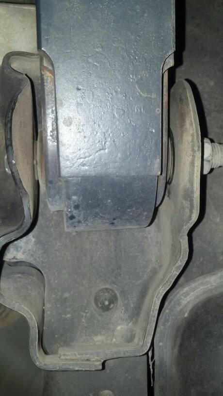

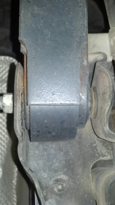

    Driver side fwd leaf hanger.
    Pass side fwd leaf hanger.
    After a long painful few weeks of trying to figure out what seems like the same vibrations a lot of us get ( I have set my drive line angles perfectly) and I still have vibrations throughout the whole truck, I once again crawled under to try to figure out what the f*#$ is causing it. Can anyone see what I'm seeing in these pictures?

    No , I don't see what you are seeing

    I'm not sure if this could be the cause of vibration, but the fwd pass side bushing isn't centered and there is displaced metal on the inside of the bracket where the military wrap is banging against it.

    Now I see it
    Interesting , one of my Dakar packs was doing the same sideways tracking thing for a while too

    I thought your hanger was bent :facepalm: lol thats how they are suposed to look
