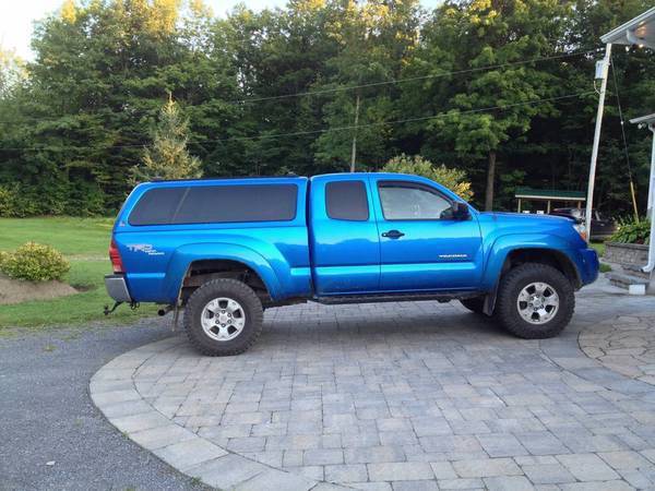

    Speedway Blue 06 TRD Off-Road
    Leer 100XL Topper OME 885X/Nitrocharger Sport Front Dakar Leafs/Nitrocharger Sport Rear
    Completed the full OME install (Nitrocharger Sport, 885s, Dakars) this past weekend. No real issues encountered except the lack of new upper spring seat/strut mount on the OME struts - those were supposed to be part of the ARB/OME Tacoma kit, right?
    She sits just barely @ss-high now.
    To facilitate R&R of the struts, we disconnected the swaybar and tie rod from the spindle, and disconnected the upper ball joint from the control arm. This reduced frustration and gave plenty of room to maneuver around the CV boot.
    The original coil spring was compressed to remove the upper spring seat, and that was transplanted to the new OME struts. Talk about beefy compared to the stock TRD Bilsteins. :)
    After 6 years of Canadian winters, I'm extremely impressed that we were able to pull everything apart without the use of torches.
    All in all, I'm very impressed with the ride. Firm yet compliant, absorbs bumps like a champ, and it no longer feels top-heavy when cornering. Also tracks straight and true on washboard, and zero bump steer like I was starting to experience. I've got slight positive camber, so we'll see if my mechanic can fix that without new UCAs.
    With ~1.5 face cord of wet wood in my 5x10 trailer hitched up, the rear end barely dropped - unlike last time - and the truck sits about level. Before the Dakars (stock TSB leafs and one bottom leaf snapped on driver side) the rear end was squatting so bad it was almost sitting on the bump stops.
    I'd do it all over again, and sooner on the next Tacoma.
    Cheers.

    Very nice truck you have there. You're lucky you didn't had to use "persuasive means" to remove your original parts, like I did on my buddy's 03 Tacoma :p.

    Thanks Clem! Yeah, the torch was standing by - just in case... And I'm sure my mechanic will appreciate the anti-seize we used in certain places for when he needs to revisit those spots one day... The most we used was the impact or a 2 foot breaker bar.
    The only issue I'm having post-install is the takeoff shudder, but I haven't done the carrier bearing shim yet. We'll see what that does, but I'm planning to measure angles before/after. We dove right into the install, so unfortunately I don't have my own stock numbers to compare with.
    Cheers.
