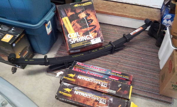

    My Kit came in today! pretty stoked =)
