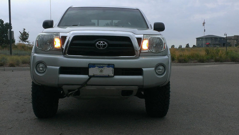

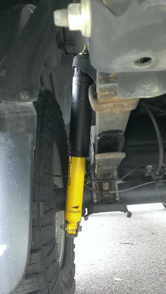

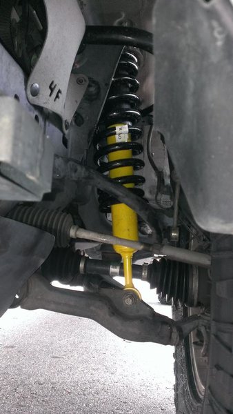

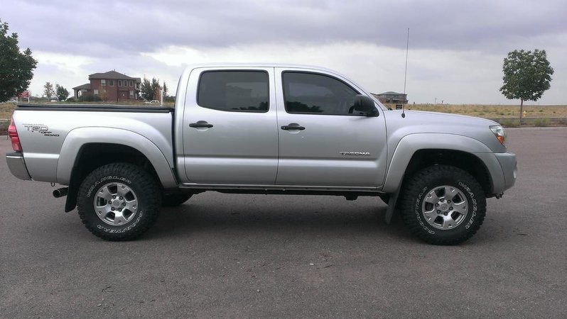

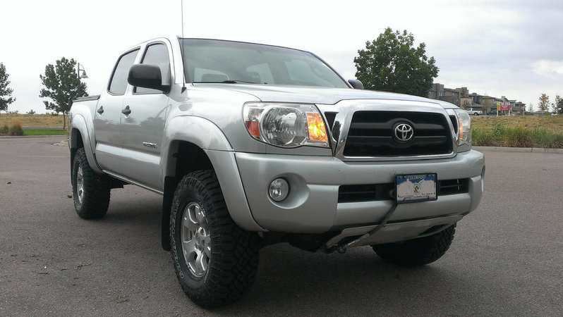

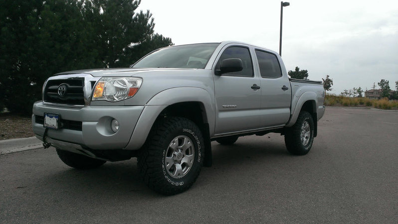

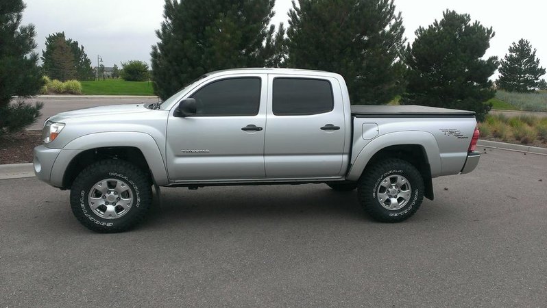

    Hot off the presses.. here is the new lift:
    If you have OME post a pic or two & tell us what you got.
    See below for pics:
    What did you put up front & what did you get?
    OME 885 Springs OME-90000 shocks
    What did you put in back & what did you get?
    2"AAL OME-60091 shocks
    Are you running trail armor & how much lift did you loose or what did you do to regain/maintain lift?
    No armor, but I have the UCWMS (To see pics, look for install in my sig below)
    Tire & wheel specs & rub or what you did to eliminate rub.
    Factory wheels, Brand new Goodyear Wrangler Duratracs (265/75/16)
    Are you still running a sway bar?
    Yep.

    ^^^Looks good. Welcome to the club! Did you add spacers or is your top plate just shiny?
  4. Sep 10, 2013 at 6:30 PM
    #2604
    YOTA LOVER
    YOTA LOVER Stay Calm, and Fire For Effect
    Jul 17, 2012
    #82814
    4,165
    NH
    2011 MGM Tacoma DCLB SR5
    A slew of pricey stuff my wife hates me for.
    That's a spacer. I'll go out on a limb and say its the 13mm (1/2") since the reveal looks similar to mine. Trucks sits sexy as hell!

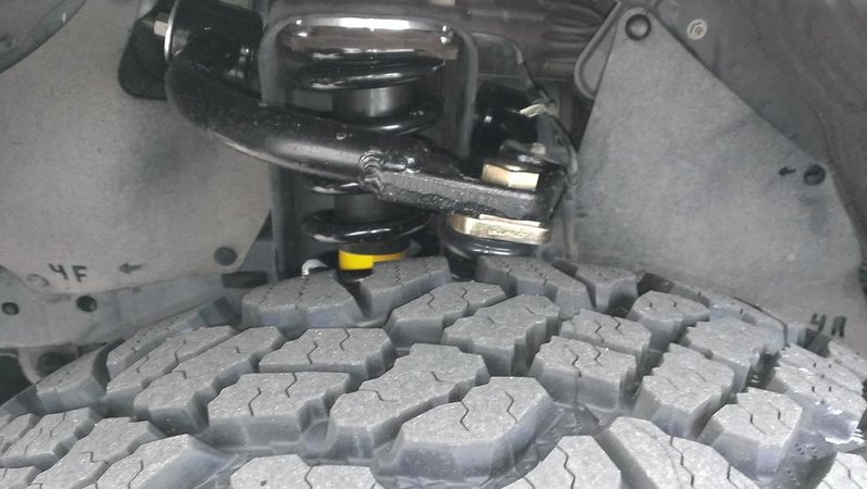

    hold on maybe im seeing things but in picture number seven where it shows the front strut, is it me or is the spring perch seat upside down?

    It's you

    I dunno OZ....that does look like the "cup" opening part of the perch is pointing down, not up. Unless mine are upside down.

    Here's what mine look like and you can see the part of the shock that the perch sits on, in his pic you can't. Maybe it's just the angle.

    It is indeed installed upside down, the cup should be up like yours

    Who's.....mine or g34rh34d's? haha

    Sorry, edited post, yours is correct
