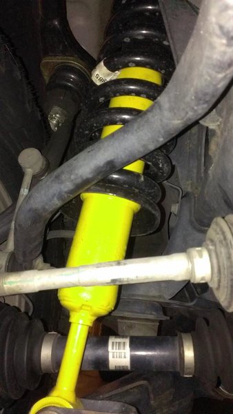

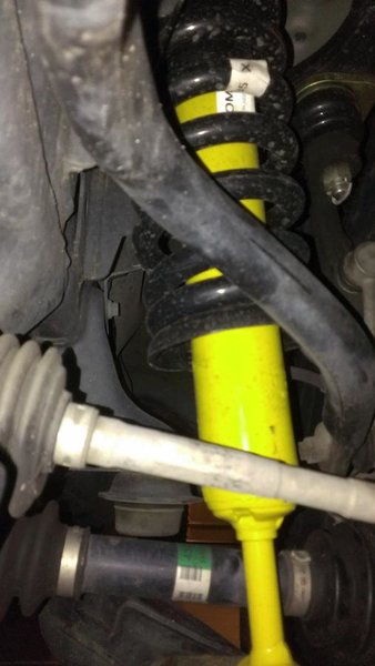

    How the hell, my springs have them attached already, I guess he pulled it all apart and installed it upside down?

    Playing catchup here... not sure what you guys are pointing out that is wrong.. Are you referring to the top or the bottom of the shocks?? (gonna go back and re-read...)

    The bottom. The perch that holds the bottom of the spring is upside down.

    Just read the PM, and the posts... I'll go take a look at the perches... Thanks guys for pointing this out..!!!

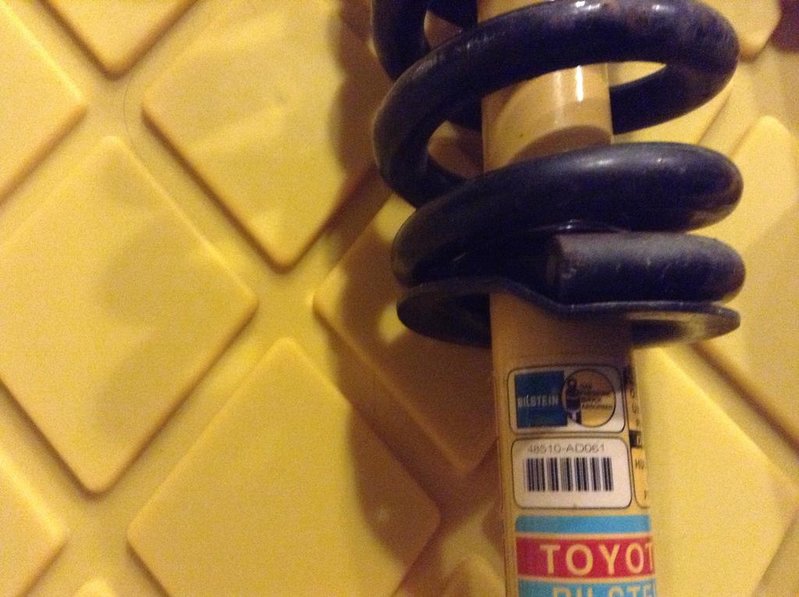

    It should look like this

    This ( OME on the right )

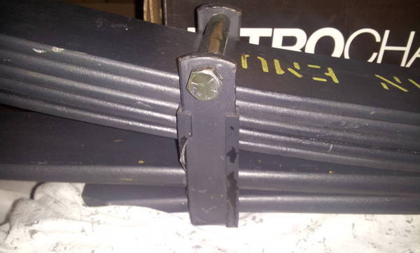

    On another note, I noticed when I unwrapped my leaf pack it had a few cracked and broken plastic clips. Is this something I should be concerned about? im assuming their purpose is to prevent squeaks!?

    Are you talking about the black boot at the top of the shock ?
    Broken clips aren't too big a deal but if you email ARB USA , you might be able to get some replacements

    Guys (and Gals) ;) You all are absolutely correct!! I crawled up underneath the truck and sure enough, the "cup" portion of the lower mount is pointing down. Thanks for noticing this, and helping a fellow TW member! You guys rock!!
    I will contact the shop who assembled them for me and give them the good news... :rolleyes: (and shame on me for not noticing it!! Yikes!)
    Both were the same see pics below:

    Every pack I have ever seen has these plastic things broken and or missing. Considering where these are shipped from I'm surprised the packs don’t get more beat up. IMO this is just cosmetic.
