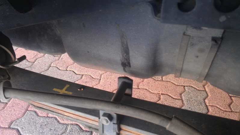

    So I am having this problem with my dakars....
    I used a bic lighter for with reference.
    Anyone having/had this issue??
    without lighter.

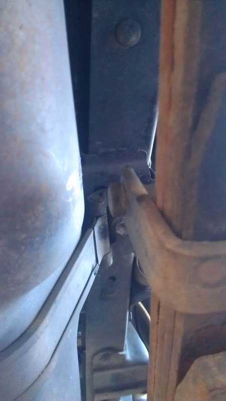

    Is your front part of leaf spring move side to side? Because mine moves, its supposed to be on the middle of the front bushing. When mine move to the side, it's make squeaking noise because it's rubbing the front mount. The picture with the bic lighter seems like its in the middle of the bushing but when it move to the side, its hit the fuel tank.
