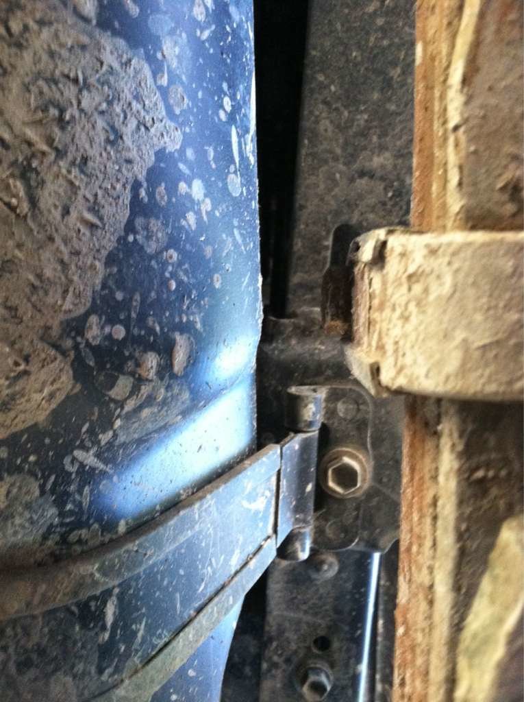

    Front of spring, clearance between spring and tank. Easily .5".

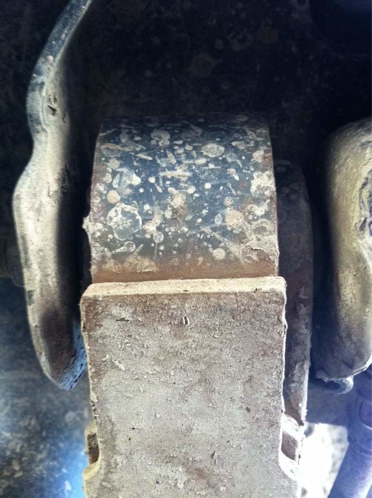

    chyknees,
    As you can see my front part leaf spring move to the right, last night it was all the way to the left and squeaking . You can see the front bushing on the left. The other side is good. I saw a couple Tacoma have the same problem with Dakar leaf spring. Mine is less than a month old.
