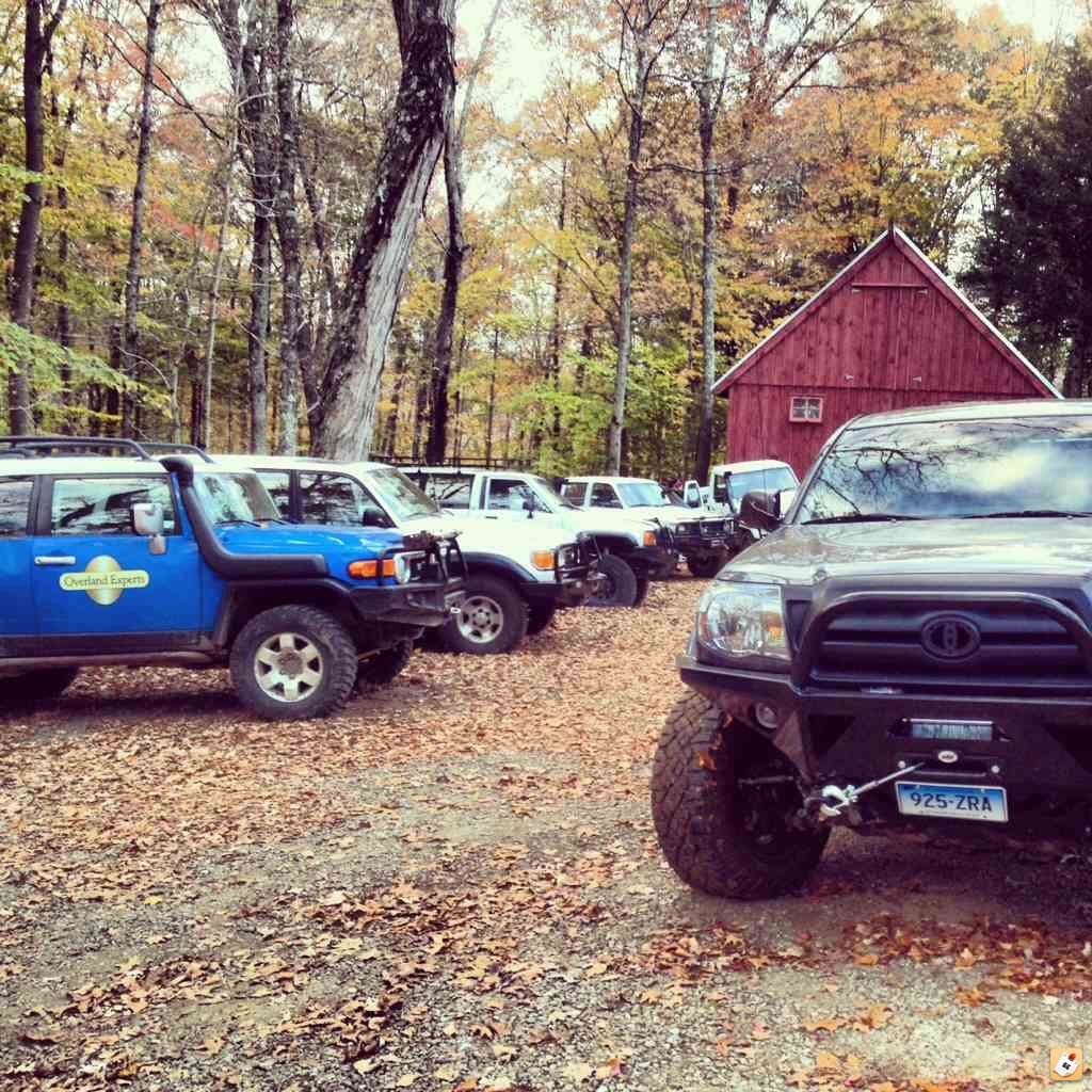

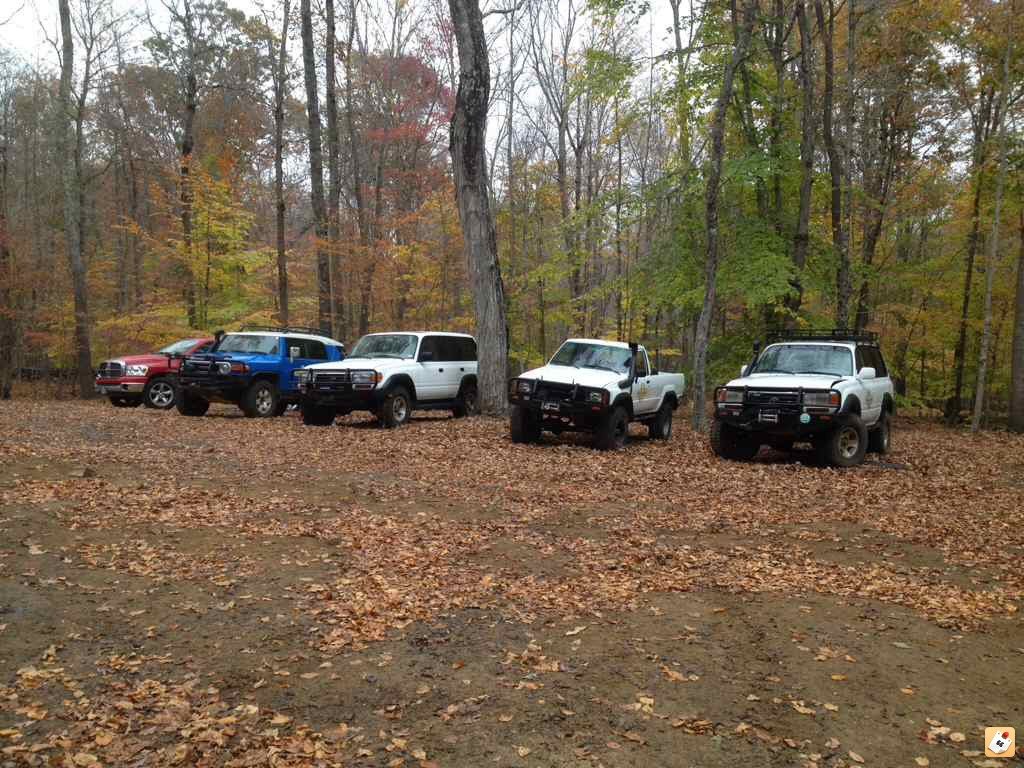

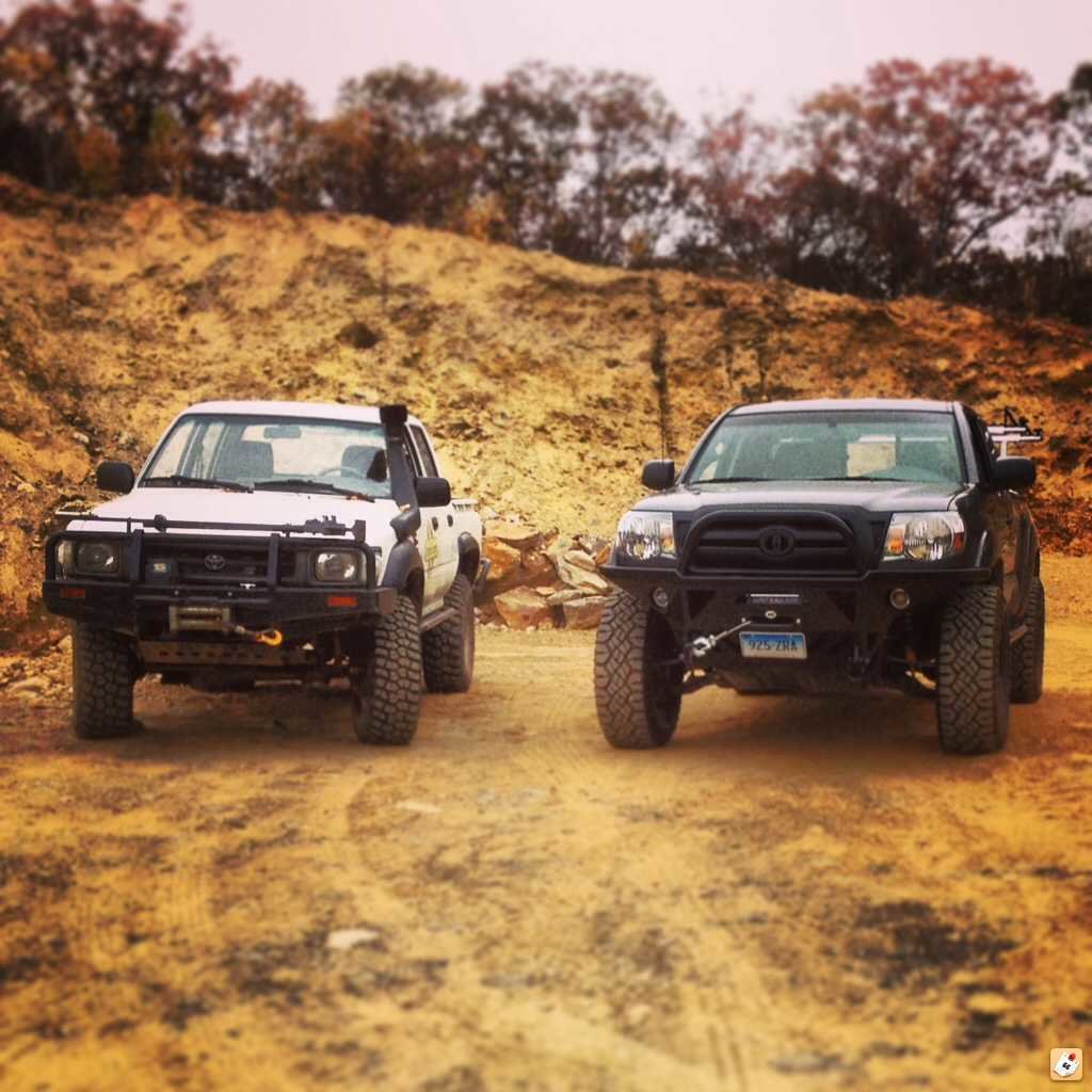

    I thought i would share something i thought was cool related to OME suspensions.
    Last week i did a all day training course with Overland Experts. Its a local company that does overland/off-road/recovery courses for military, industrial and recreational. That also do full out expo trips. They have gone places like africa, iceland and this may they are doing a trip in bolivia. They are pretty legit, the owner has some impressive qualifications. Anyway ill get to the point, their vehicle fleet consists of only Toyotas and Land rovers, and every single vehicle they drive is equipped with Old man emu suspensions and ARB bumpers. Goes to show how tough this stuff is. Here is some of their vehicles.

    Cool! That Dodge looks a little out of place in the last pic though! haha

    Haha ya, thats not one of their vehicles

    Figured as much....sticks out like a sore thumb.
