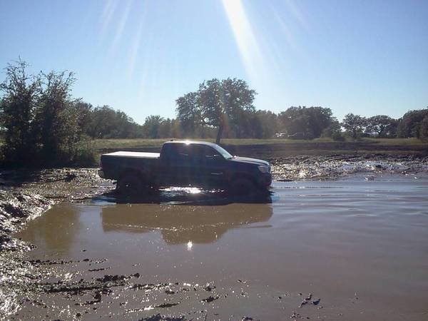

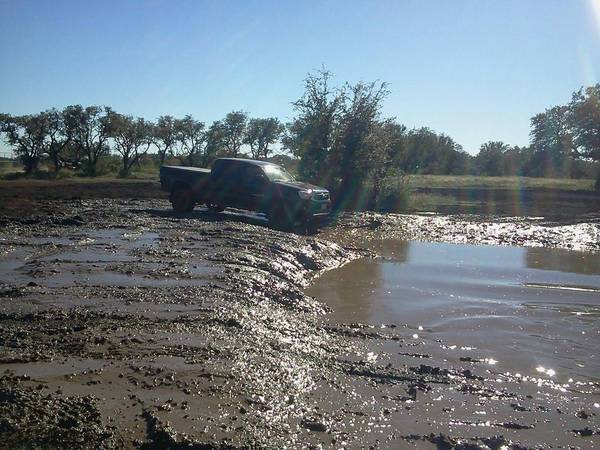

    Took my OME set-up for it's first real test yesterday. Nice little off roading park about an hour north of san antonio. Had a lot of fun, need to go back and explore some more. Lot of technical trails, found ourselves turning around a lot. My buddy had a first gen with some sort of crappy 3" lift and a 3" body lift. Could tell my OME set-up had a lot more flex in it than his did. here's a couple pics:
    This hill is quite a bit steeper than the picture shows:
    They had a fun little mud area to play in too:

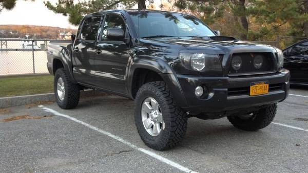

    New lift with tires! Finally sittin pretty..got some wheel spacers on the way as well

    Love the stance!! What size are those tires? 265s?

    Thanks me too! They are 285s
