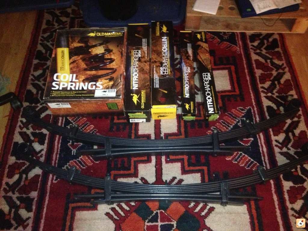

    Hey guys, a few questions...
    Im getting 885x coils, LR UCA's, and some top plate spacers to replace my spacer lift...(4.0 doublecab shortbed 4x4)
    1. What is the point of dropping the extra money on the ome shocks over 5100's @ 0?
    2. Should I use the 10mm Spacers or the 13mm Spacers? I need to get 3" of lift no less, and its ok if it goes a bit over because I will be able to get alignment right with the UCA's.
    3. I was planning on not getting the diff drop in the front is that ok?
    Thanks guys!

    I added 1/4" spacers to mine and got just less than 3" so you'll probably want 1/2" to ensure you get a full 3". There's been a little debate over OME vs 5100s......no real answer that I've seen other than the Nitrochargers were meant to be paired with the OME coils. And you definitely do not need/want the diff drop.....it's worthless on 2nd gens.

    Ok, so after reading a few dozen of the pages of this thread, I have more questions than answers.
    I just put the OME Dakkar springs and OME shocks on the back of my 2010 Pre Runner Reg Cab. The back is up quite a bit now (maybe a little over 3"). I did this more because of the heavy load that I tow rather than for "lift" (but the lift is really nice!). The stock springs and shocks just didn't cut it with a 2 horse trailer on a long haul. Now the headlights are aimed way low, so I told the wife that I have to have the front OME springs/struts to level the headlights. Not being mechanical at all, she merely suggested re-aiming the headlights. What fun is THAT!?
    So the questions:
    -With the regular car Pre Runner, no trail armor (other than Avid sliders), I was looking at probably the 884 with OME struts up front. My estimate is that that should level the truck. Will I be OK with the stock UCA, or will I have alignment/travel/rubbing issues, or is it a "some do, some don't" answer?
    -As far as I can tell, I should just need the springs and struts. I believe there's a spacer or something like that specific to a lean issue with Tacomas also? Any other things I'm forgetting/needing?
    -Right now I have the stock Dunlops that came on the truck, bit I'm leaning toward 265/75 16 Grabber AT2s. I don't think I'm going to have any rubbing issues from that, but if anyone has definite info, I'd appreciate it.
    Thanks

    Wow, I took a picture of mine when I had my lift half-way installed, just the rears. Couldn't imagine driving around like that!
    884s will get you about back to where you were when you were stock, probably not quite level. It'll still have a little bit of rake which I like. With the amount of lift you get from just the springs, you should be fine with the stock UCAs. When you order the stuff, make sure they include the 5mm trim packer (correct the tacoma lean). That should be all you need.
    As far as the tires go, you will have no issues with 265/75/16s. I run that size and they fit even on stock height with no rubbing issues.
