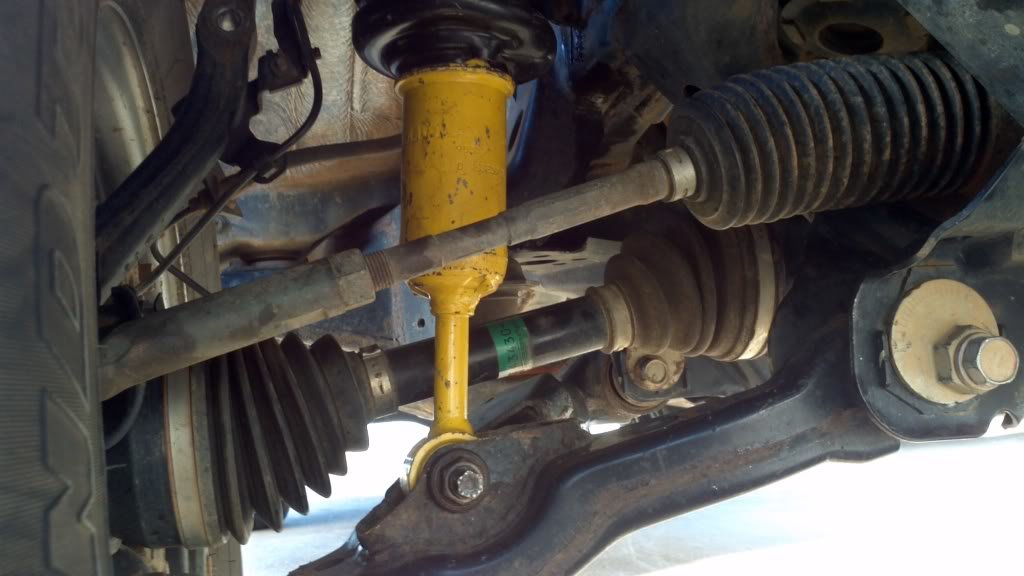

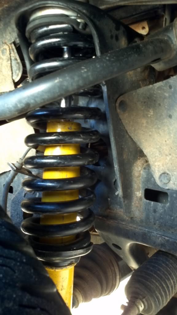

    Finally put this on, 884s on 90000s with 1/2in. top plate, no sway bar :cool: and toytec 1.5in aal on non-TSB leafs in the back. They're scratched up but in good condition. Got all of it in the 2nd gen market place for $250 and $60 shipping, So I think I came out looking pretty good. :D

    Hmmm your missing the dust boot on the front shocks? Did you have any issues with installation?

    Yeah I was worried about the covers and asked in here before I put them on. Someone else said they ran theirs coverless with no issues. Installation went well, compressed the springs onto the shocks while on the truck. I was surprised with how easy it was really. Took a while but could do it again in half the time now.
