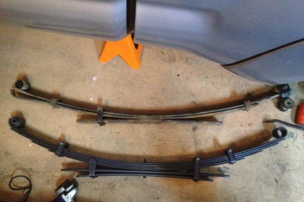

    Don't forget the bushing kit for the shackle end of the Dakar's these bushings are easily installed & a nice option besides trying to reuse your old ones :cool:
    I also used these center bolt head lengtheners from ATS Springs. Essentially they are spacers that go between the center bolt head and leaf spring giving the center bolt the proper length when using leaf spring shims. adding an angle shim decreases the amount of the center bolt head that will protrude for locating the leaf pack to axle housing.. the spacers are cheap peace of mind IMO.
    http://www.autoandtrucksprings.com/products/Center_Bolt_Head_Lengthener_2_Pcs-1662-0.html
    you can see in this picture the added length of the center bolt head, and you can also see that the Dakar's do not come with the rear bushings.

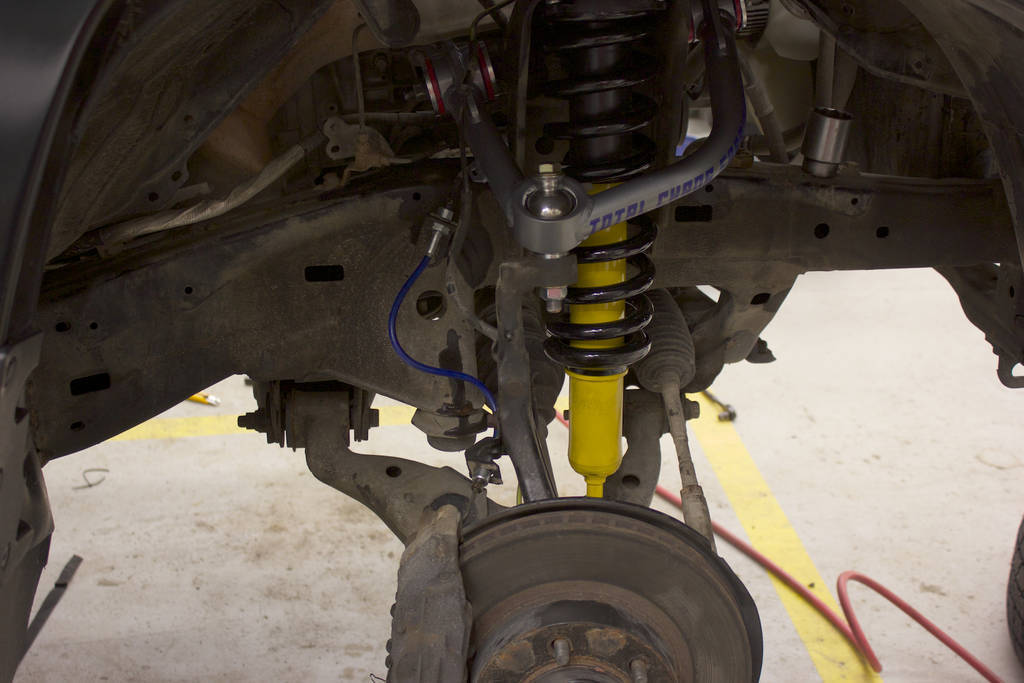

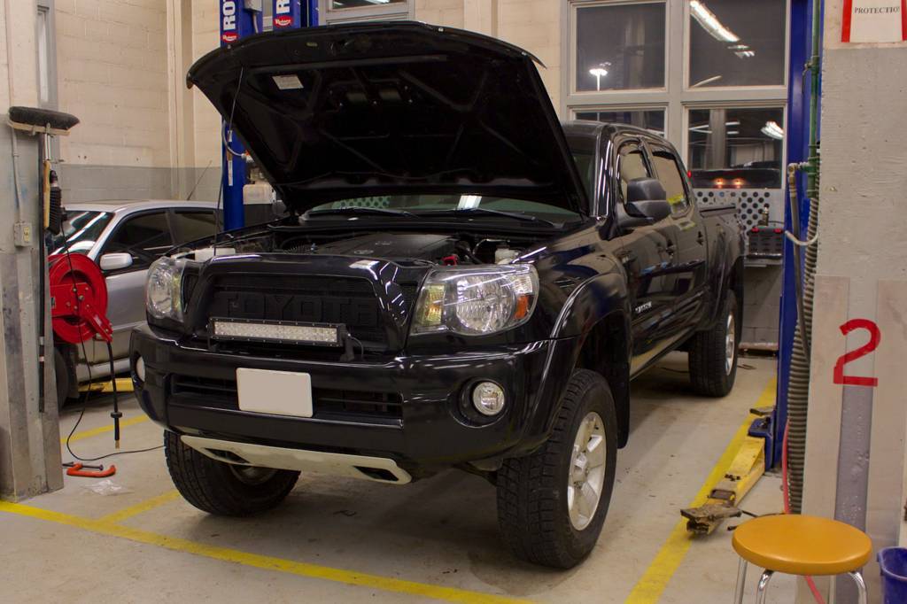

    I finally got mine done. I spent about 7 hours doing the work, bumper to bumper, with an assistant. I'm glad no bolts were seized in the bushing sleeves, they all pulled out like a charm. I had to slightly use the oxy/acetylene torch to help the removal of the old u-bolt nuts.
    My new setup: 885x, top plate spacers, dakars, and Total Chaos UCAs.
    And the result
    I will wait until I get her aligned before I send my measurements to OZ-T.
