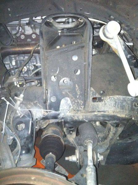

    :taco:Tear down today, ball joint press into Camburg UCA tomorrow, install tues/weds. Stoked!!!!
