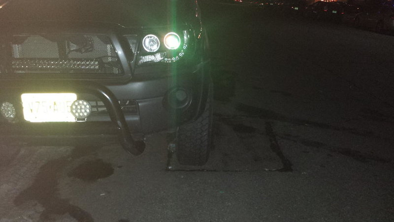

    The guy I went too said the uca is to big meaning its out further than the lca nd its give it the angle the trucks on... ive dealt with this guy before nd he seems to know his stuff always see nice jacked up trucks there

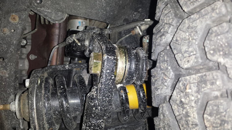

    Doesn't sound right. You can adjust the camber with the UCA, the top nut slides in and out, go check where the nut is set on you UCAs. Which way are the tires leaning?

    If your looking at the front of the truck the right side is like this \ and the left is like this / but not on tht dramatically angle lol

    Where is the top nut postioned in the slot at the top of the UCA ?

    Heres pix

    What position were you hoping for with the caster adjustment ?
    The neutral postion has the SPC logo facing out

    What do you mean?

    Ok I see im going to look again

    Ohh boy looks like thts it then right?... im going back tomorrow 1st thing having them fix it nd wsnting my money back

    They look like the spc logo is facing the engine bay right?

    Yes , like it is set for neutral but the diagram was followed for the wrong side of the truck

    Yeah thts exactly how they are
