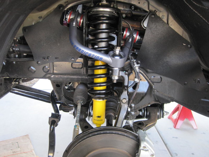

    I like these control arms, they look good & serve their purpose but one thing just doesn't make sense to me.... the exposed uniball.
    My truck see's a lot of off road, mud, sand, water, snow, salt ect..
    How does that setup survive without being cleaned constantly?

    Eventually, you have to replace the uniball. I would recommend going with stainless steel uniballs if your truck will see salt. Otherwise, the chromed ones can pit and dirt starts getting into everything.
    They survive because the ball fits very, very tight in the socket so dirt can't get in there. If you're concerned, you might want to consider the Light Racing UCA because they use a protected ball joint.
