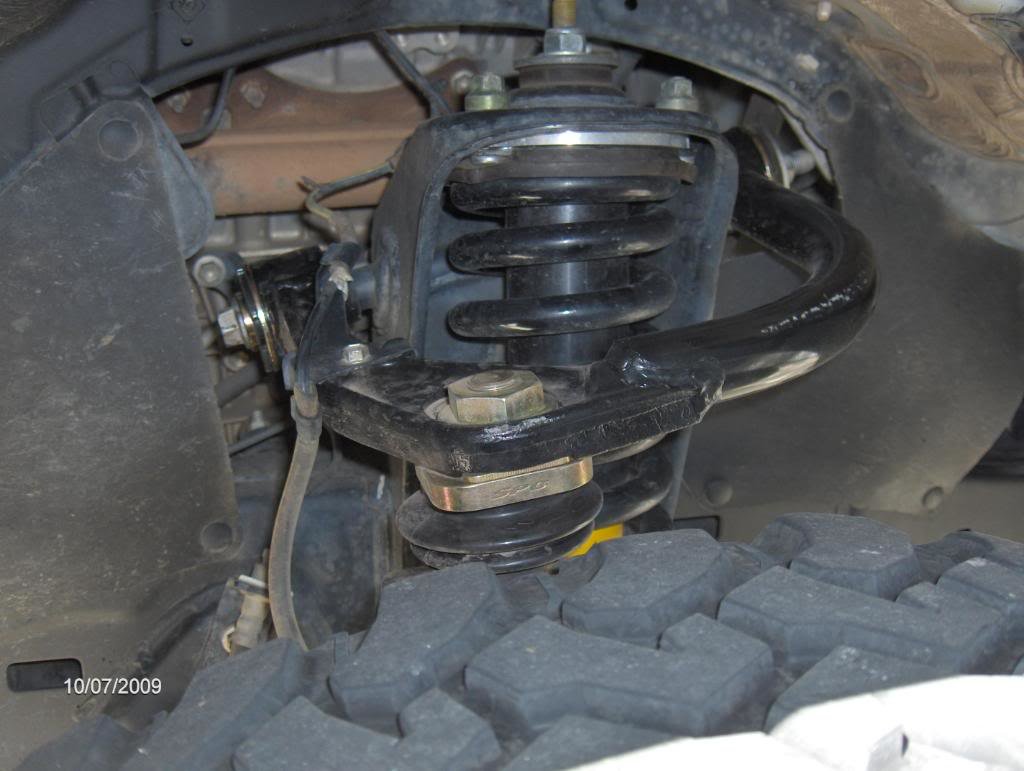

    Yeah nd I was wondering if I could get pics of what ppls camber are set st for the lca

    Oh , sorry , misread your post
    I pulled mine almost all the way out initially
    Here's a pic of them on the neutral setting for caster

    "E" setting, overall is +1*. I had a lot of rub set at D on the rear of the fender after alignment, so I went back. Told the tech I didn't much give a shit about getting 2.5 caster on the machine, I wanted him to maximize clearance as outlined in Mooses write-up. He did so, and I ended up with 2* caster on the machine.
