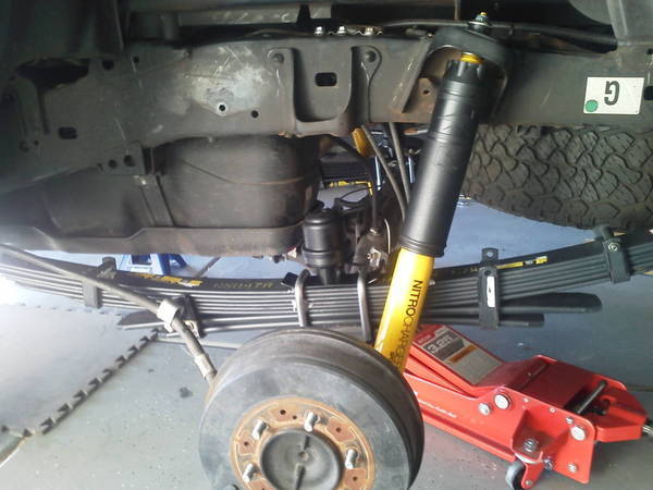

    Hello All, just got my first Tacoma, 09 DCLB. The previous owner added an 2.5 OME lift, coilover's and add a leaf. I also have the corrosion on the shock body even though the kit was installed 14 months ago.
    How can I tell what OME parts where installed (springs, shocks)? Are there any marking or serial numbers visible I should see?

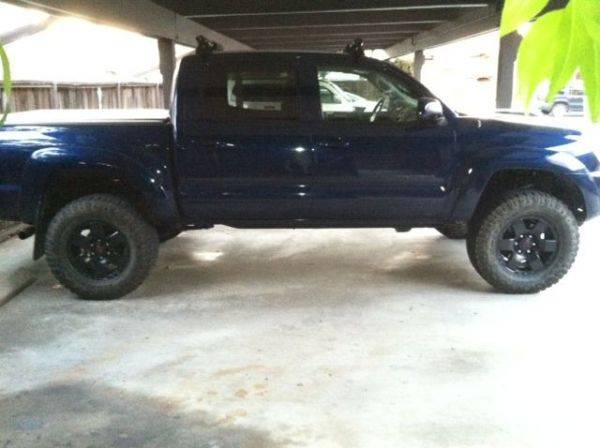

    I got the lift on. Went with 885's and they are a prefect fit for what I wanted. Ditched the sway bar and I still have less body roll now then I did with the worn stock setup. I didn't measure but the height is right where I want it without the top plate spacers.
    I went with MT classic locks and 255/85r16 Coopers.
    Installed everything myself in a day with an extra set of hands.
    Very happy with the setup just need to save up for UCA's now so I can get some caster back.
    pictures in the link below.
