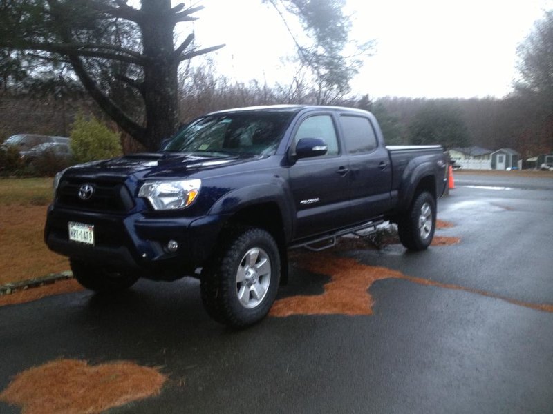

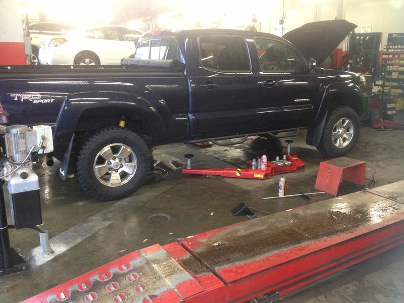

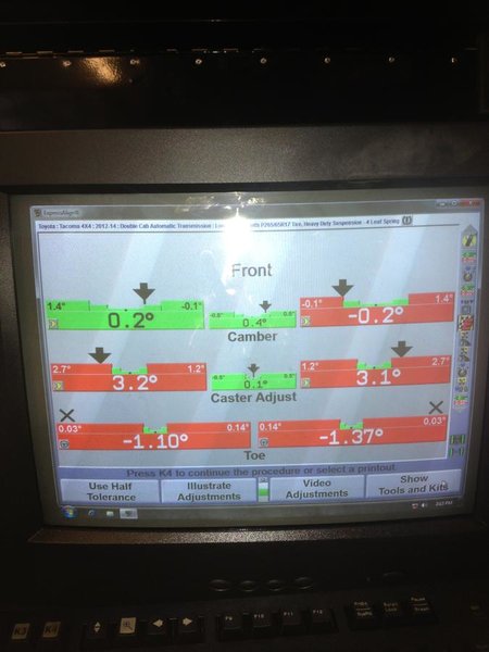

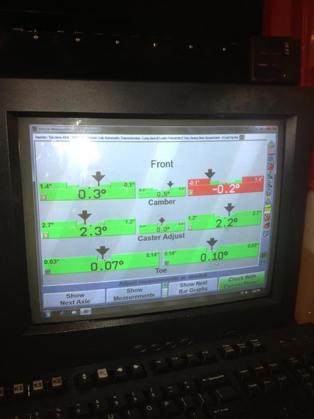

    I just installed my Nitrochargers, OME 885x's with the 3/4 inch toytech spacer, LR UCA's, Spidertrax 1.25" spacers, and DAKAR Leafs with some 265/70/17 Goodyear Wrangler Authoritys. I love the way the truck looks and how it rides. It is not stiff at all like some people say and think it rides as smooth as the factory ride. I didnt get any vibrations out of the set up either. I do get a slight rub with the tires when backing up and almost at full turn. Here are some pics and my alignment numbers pre and post alignment.

    You can "cheat" the spindle forward a little by setting the upper balljoint on the UCA to 1 degree as opposed to the 2 degree (neutral) setting and then have it realigned. It'll get rid of the rub on the rear inner fender. Worked wonders for me.

    Yeah I think that is what I am going to do. I bought the unlimited alignments from Firestone so I will go back to them now that I know that it is rubbing.

    I'm surprised they only set your caster to about +2 when the LR uca's at the "D" (+2). When I had mine done, my pre-alignment caster was at 5+ with the D setting. Like he said above, set to the +1 only to move the tire away from the cab mounts.

    Yeah these UCA's were bought used so they were already set for somebody's truck. My Caster was initially set at 3.1. before I had them adjust it. I told the guy doing the alignment I wanted between 2.3 and 2.5 of Caster. He got it as close as he could, to what I wanted, without adjusting the Upper Control Arm. I was at the shop for about 7 hours waiting for it to get done, so when he got it that close I told him that was fine and I would take back if I didnt like the way it drove.

    Oh no I waited 5.5 hrs just for them to pull it in the garage....Then it took maybe 30 minutes to install the tires and maybe an hour to do the alignment while I stood by him while he did it.
