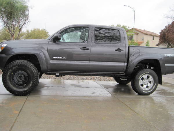

    The difference:

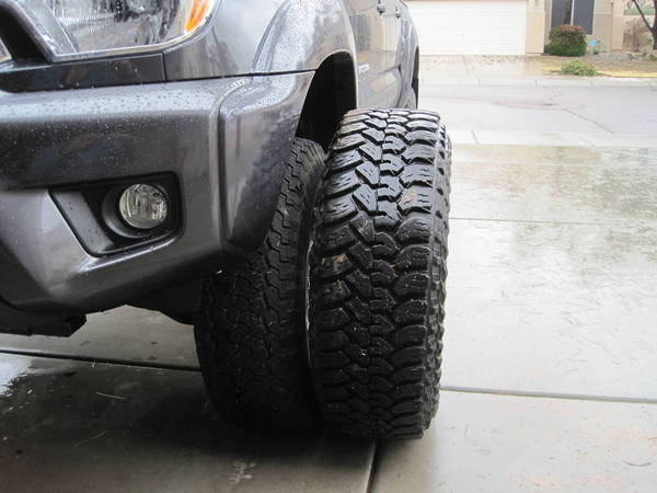

    That's the spare from my death Tacoma 285/75/16. The tire is about 2"1/2 taller that stock 265/70/16

    Are you on 16's or 17's ?

    Me personally I don't think that Tacoma looks good with OEM tires and a 3" lift. On my 2006 DCSB with OME 886 with OEM UCA I had 285/75/16 on OEM rims and it rub on the UCA. I'm gonna try the same thing but now I have TC UCA. I should be fine. Some people go with 255/85/16 that shouldn't affect MPG or have any rubbing.

    I asked about your wheel size cause I was gonna suggest 255/75/17 for you
