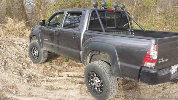

    I just installed full OME(886's+dakars) and now my sway bar is striking my coils.

    Time to man-up and remove the sway bar! :D

    Might have to try that.

    Sway delete. You won't need that shit with 886's.
